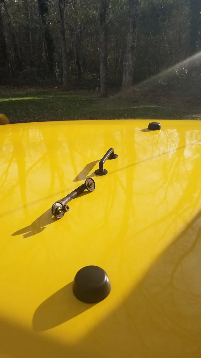

Swapped out the broken footman loop for a new metal one.

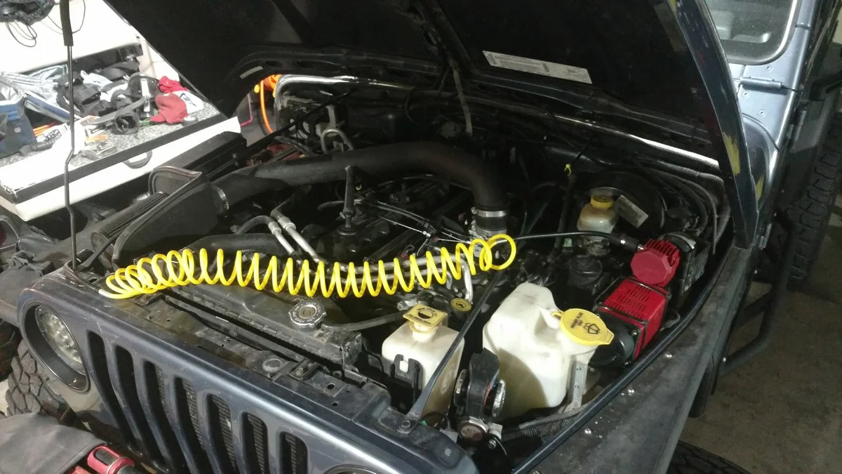

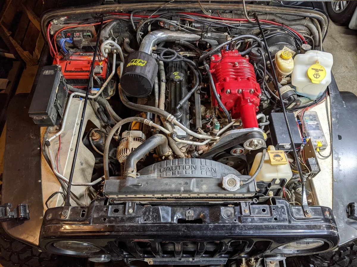

Moved the evap canister down below to the 2nd battery tray to make room for an air compressor. It's the 1050 Chinese compressor. I unscrewed the cylinder and flipped it 180 so the air filter didn't interfere with anything else. And wired it to the battery with a 30 amp fuse.

I ran that compressor for years mounted under my hood. It's back in a bag now and still use it to fill my tires. Sturdy little unit.

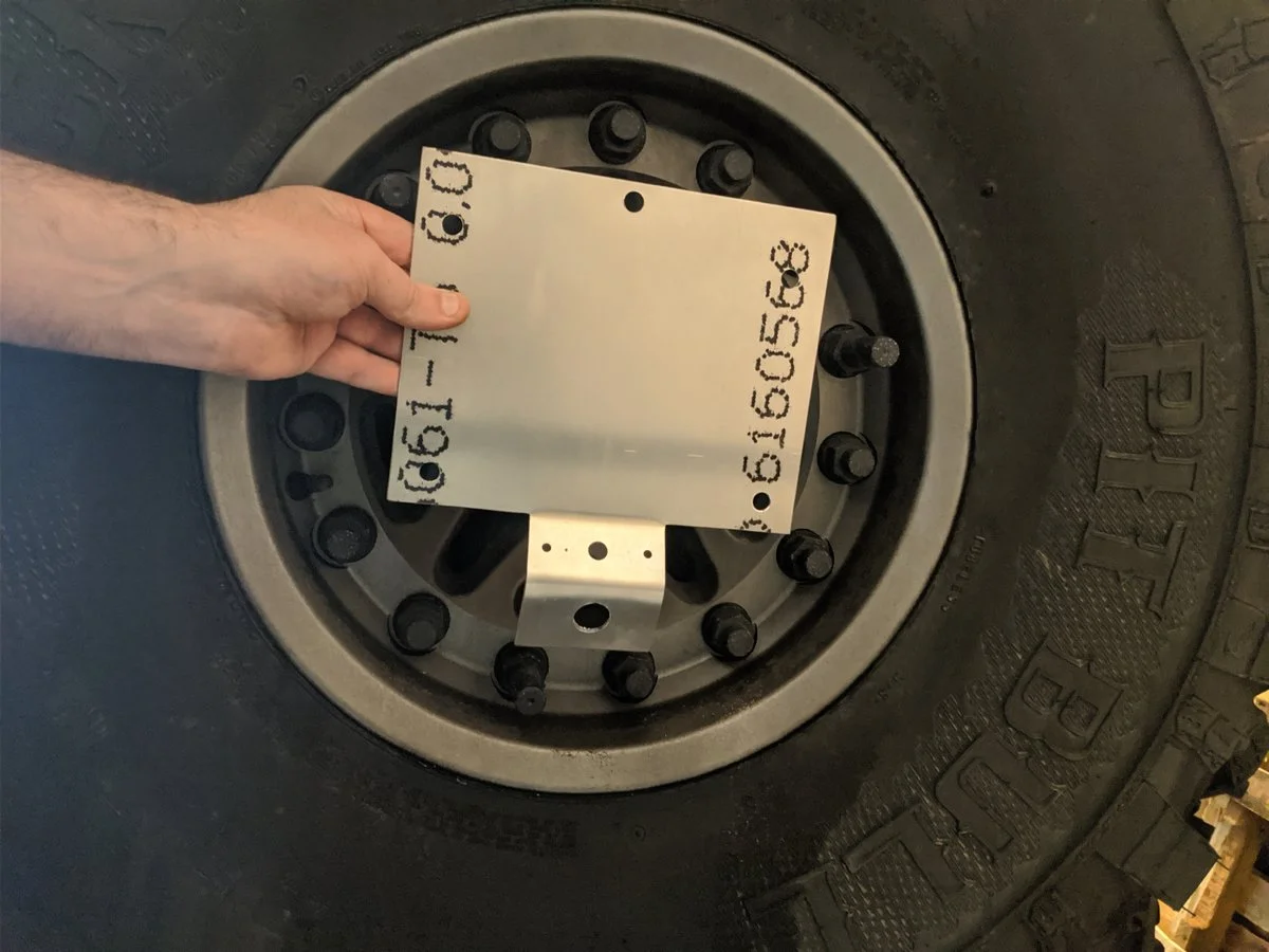

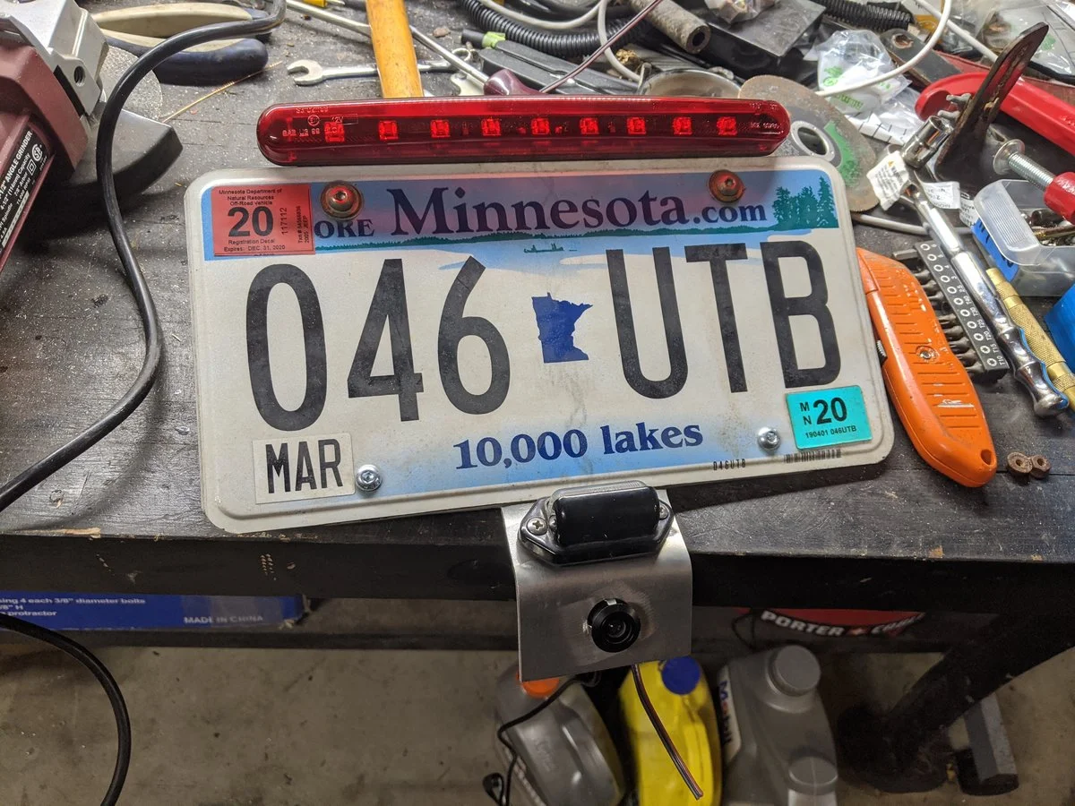

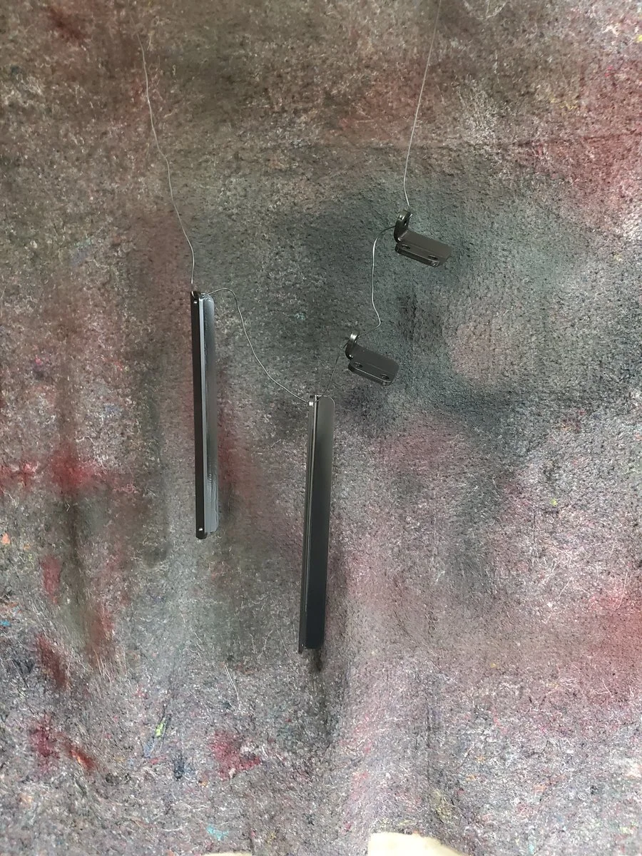

Started building a spare tire mount for a plate, 3rd brake light, plate light, and backup camera.
3rd brake light looks kind of big. It's been years since I've had one so I might just ditch it again. It was the best one Truck-Lite offered for the situation.

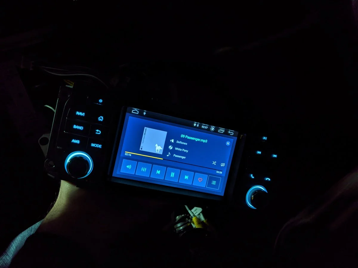

New stereo is plugged in, sounds great overall but isn't delivering the proper signal out the RCA to the sub. It's weak. Lame.
Yours is the first supercharger I've seen on a 4.0. Looks awesome.

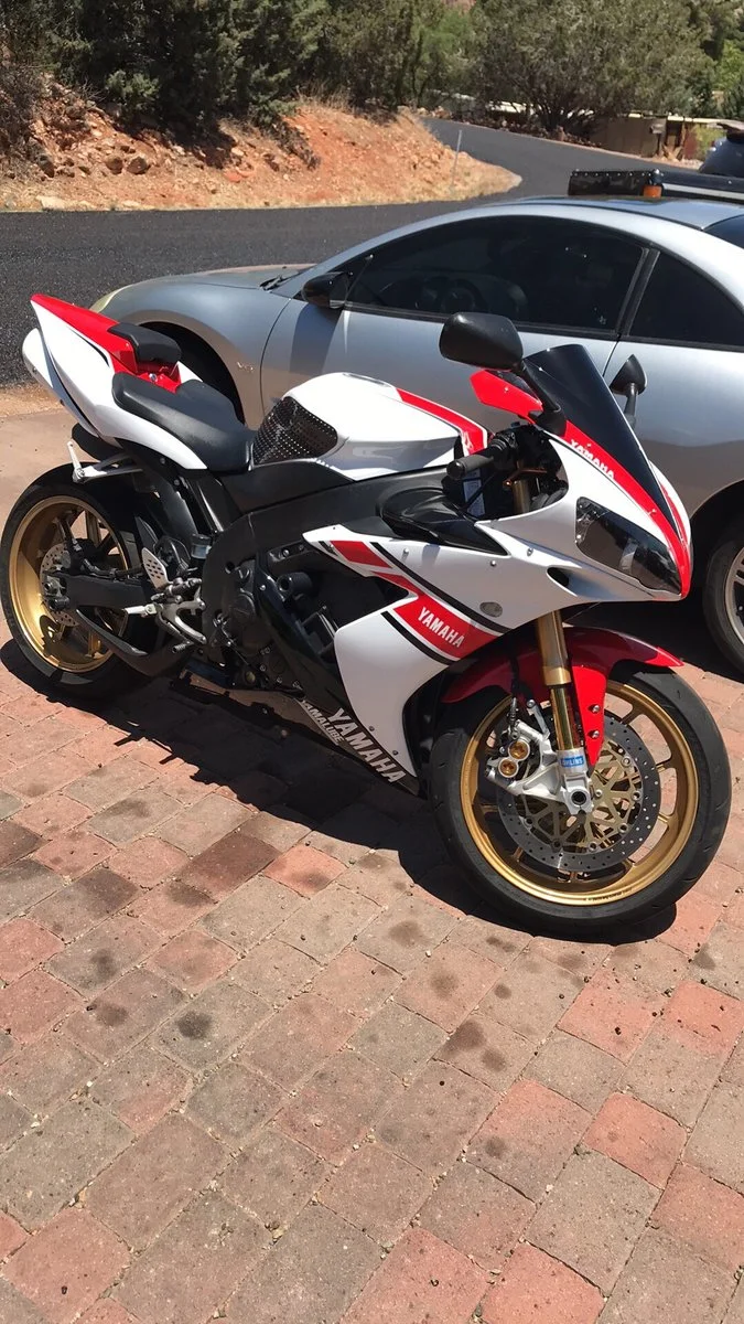

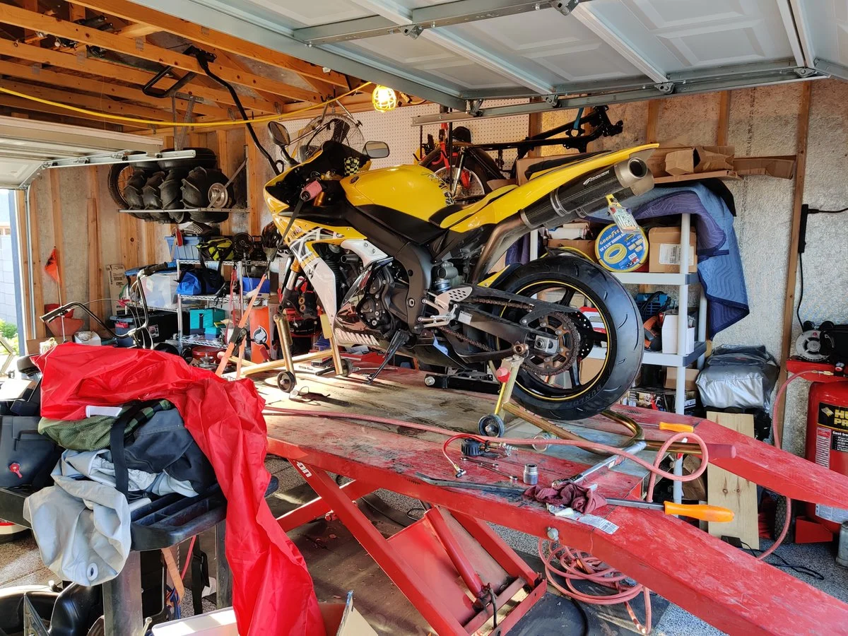

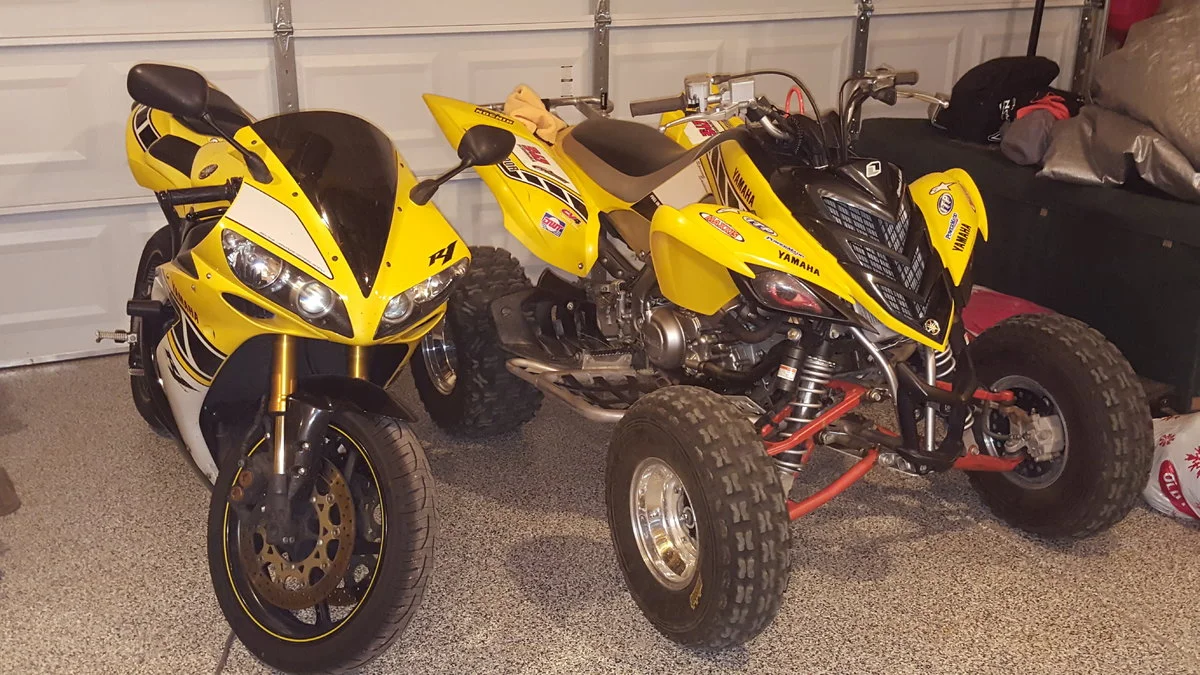

I had that same bike for a few years. 2006 50th Anniversary Limited Edition with the full Ohlins suspension and Marchesini magnesium wheels. Man that thing was nimble. I removed the yellow fairings because I was afraid I’d damage them, and I liked the white and red better 🤷‍♂️

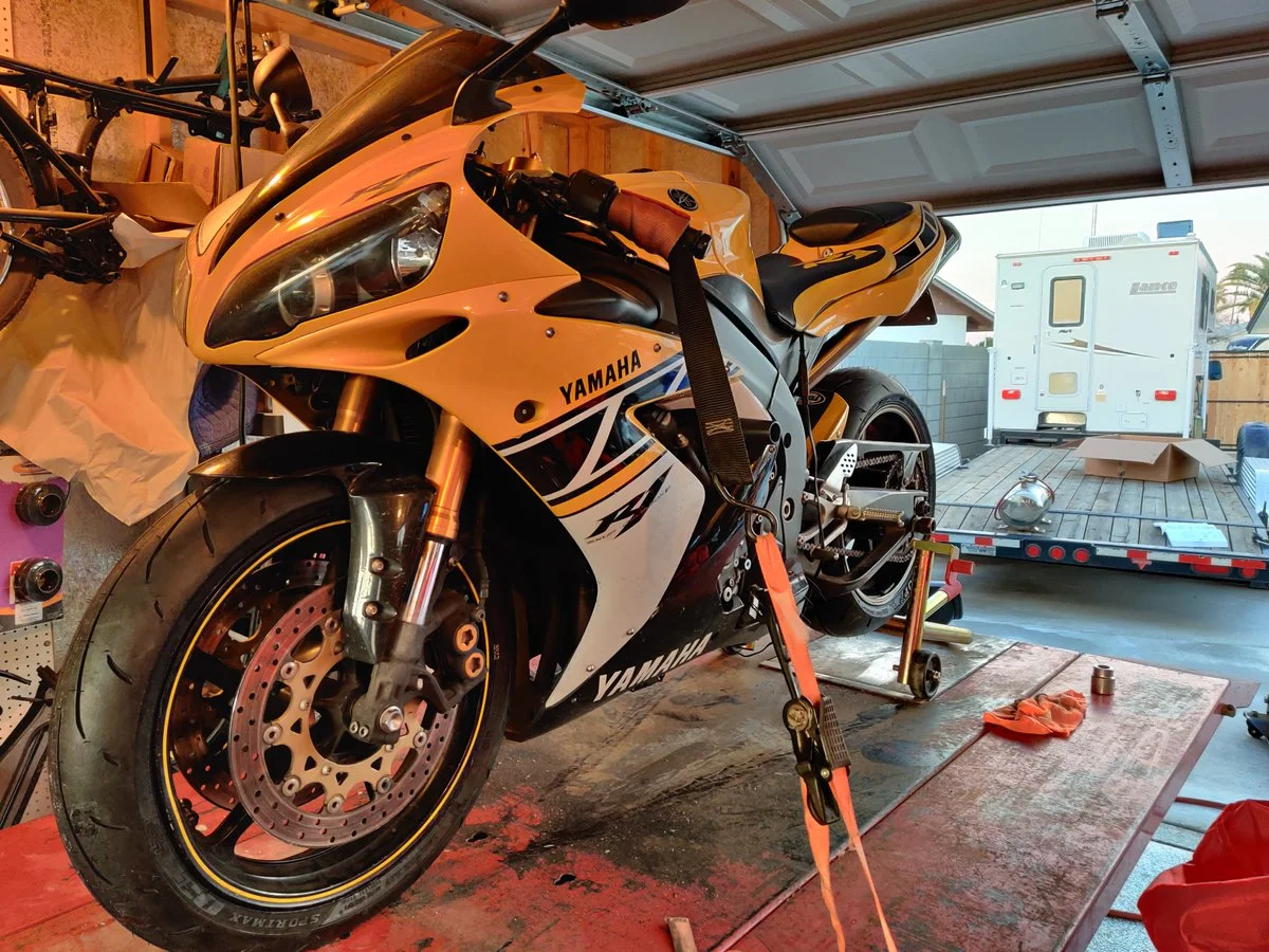

yeah mine has about 50K miles on it, and in the summer it wouldn't start one day and pissed me off. I usually buy a new bike every 10 years, so I went out and bought a new (2016) Ducati Monster 1200R. Then a few months later got the R1 running again. Now I can't get rid of it. I had to put new tires on it, and will most likely use the R1 as a daily driver to work, and the Ducati for weekend rides. I really like both bikes. I am not a one bike guy.
Your bike looks great. Mine isn't the fancy one that you have. Mine has the regular wheels and standard shocks, but my Ducati has the high end wheels and Ohlins suspension.
I do like the red and while, but I have always loved the yellow and black ever since my first yz250 in the 80's yep it was a yellow and black one the first year of the mono shock. Not as much of a fan of the 60th anniversary, but if I could get the right deal, I may do it. I also have a 50th anniversary Raptor that is the same color.
Deftones. (y)

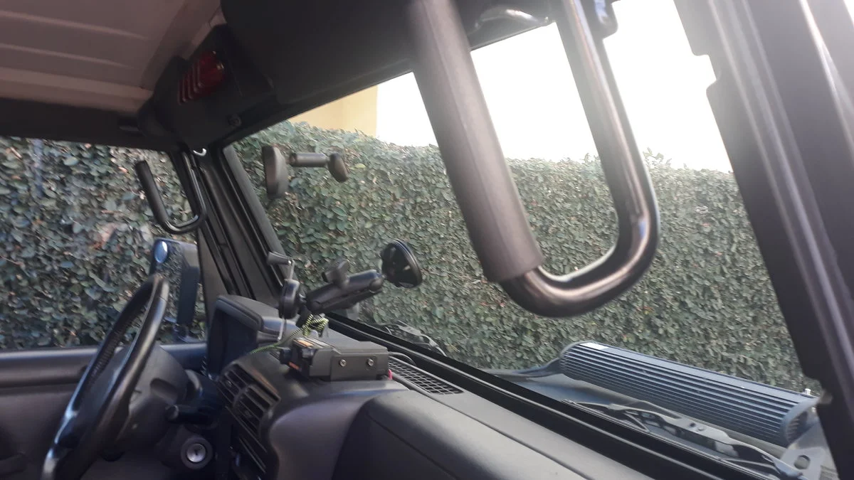

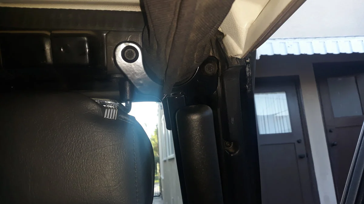

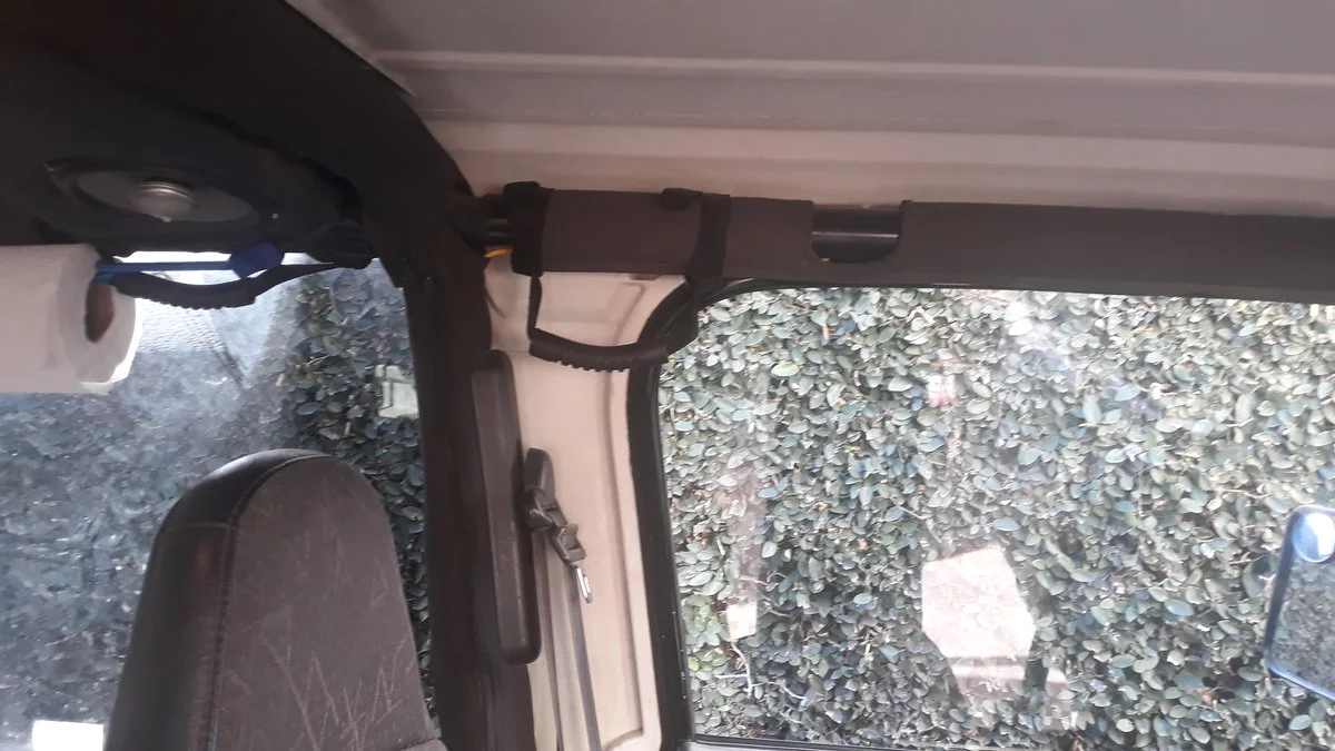

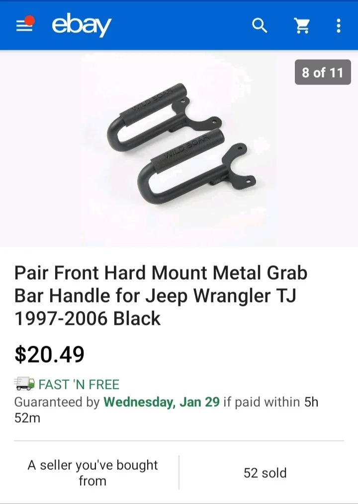

Always up for passing along a good review on cheap parts for the Jeep TJ mod scene.
I hated the cheap Ebay cloth strap handles which connected to the roll cage. The biggest problem was they swing and moved around when you want to have a mounting point with no movement.
Then I saw these metal grab bars and now it's easy and stable to get in and out my rig. $20 mod totally worth it.
Stock radio?? Maybe a line converter would help? From what I remember with the JKU the stock setup was always a weaker rear signal(ie the overhead speaker bar) and a lne converter or inline amp was needed to push/bump that signal.
