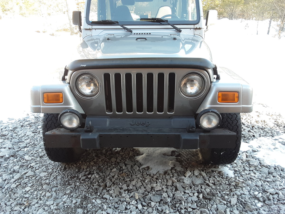

Started to take the milk jugs off the front bumper after soaking the torx bolts for a week in pb blaster and broke the torx socket on the firts one. Guess ill get the grinder out.

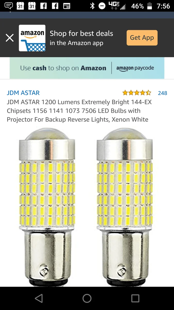

Can you explain? Is there a issue with the bulb AndyG linked? Are you saying the one you linked is better?
I found a similar listing to the one Andyg posted a picture of, they claim 1400 lumens out of 144 leds and it doesn't state which type of SMDs (surface mount diode?) it uses, but they are shaped like the SMD 3014 in the comparison paged I linked. SMD 3014 is rated at 13 lumen, so 144 times 13 = 1872 lumen.
The product I linked claims 3400 lumens and does state the type of led it uses is 36ea 3030 SMD. A 3030 SMD is rated at 125 lumen. 36 times 125 = 4500 lumen.
So, the math doesn't check out perfectly. Lumens are generally overstated. It is good to know which LED the bulb you are buying uses. The product I linked costs $3 more but comes with 4 bulbs instead of two and should be twice as bright. I left my Jeep in reverse last weekend in the daylight after pulling it out of the sand, and I was able to tell that the reverse lights are pretty bright even then. They are brighter at night, but it is hard to quantify how much difference it makes. It is noticeable.
The other figures like current or wattage probably aren't important since reverse lights aren't left on long enough to create heat or draw too much power from the battery if the vehicle wasn't running.

No milk jugs now. Why would anybody drive around with them for 19 years?

I’m still wondering ...are there certain leds to avoid

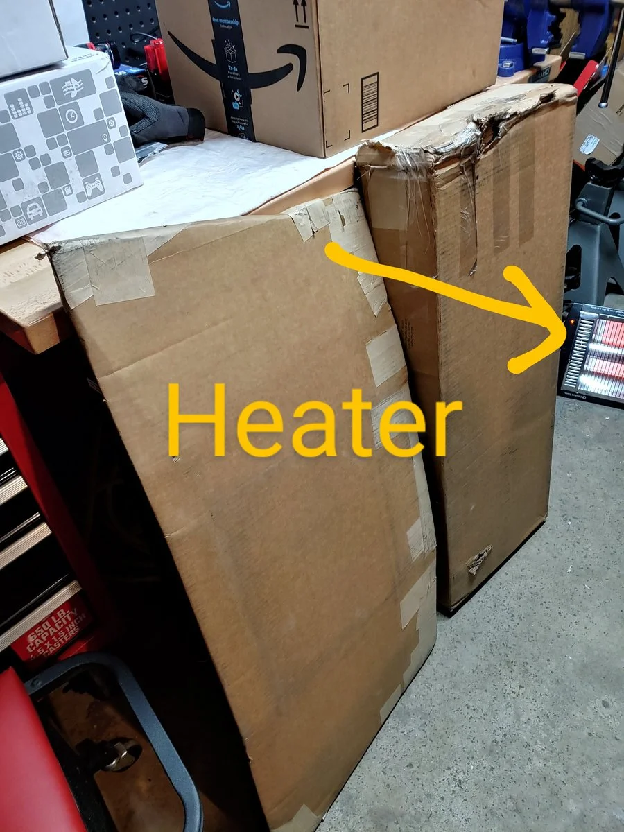

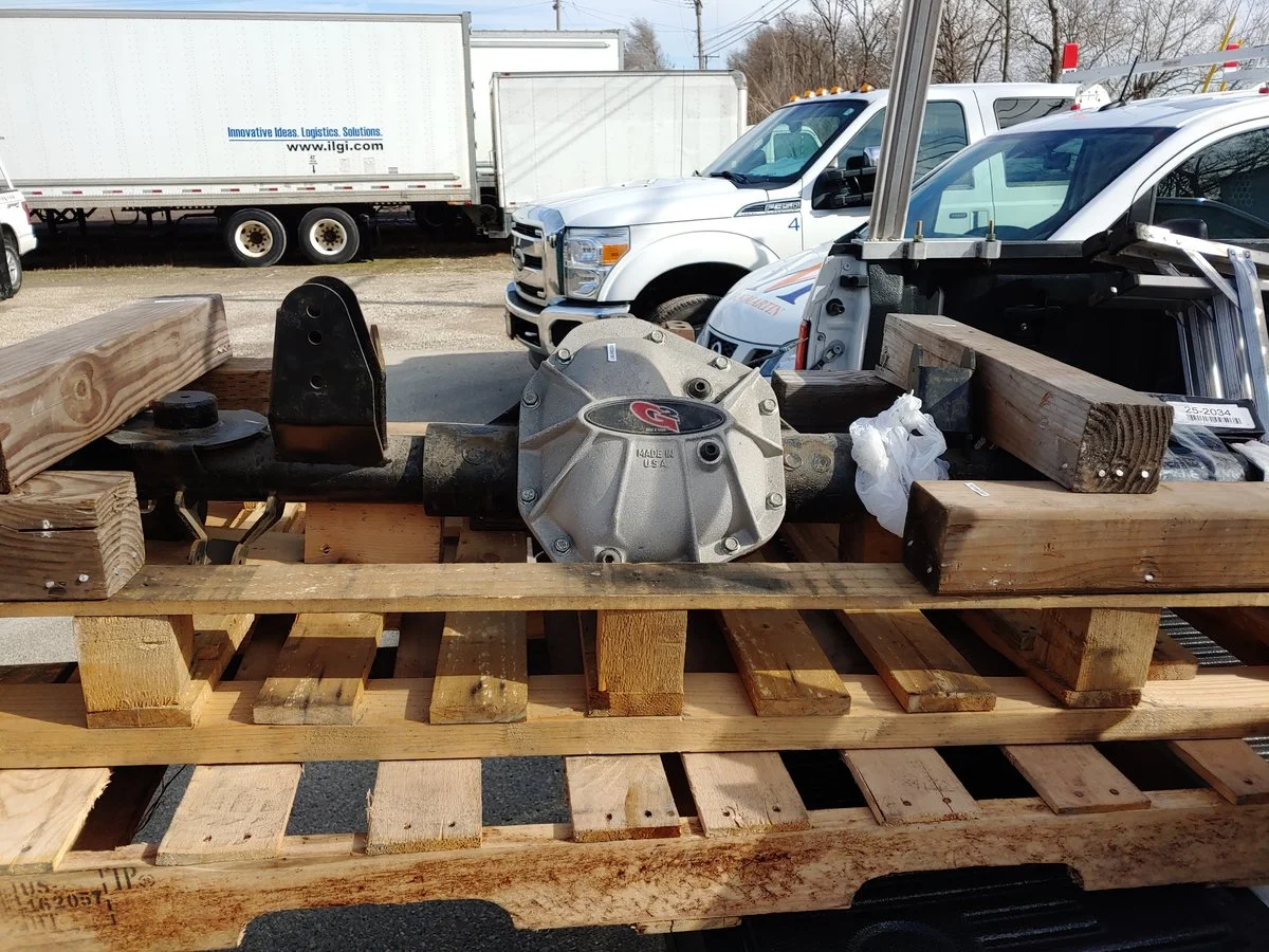

I feel you lol. My daughter bought me a heater for Xmas. So I've been busy. I stay out of the salt as well so test drives are limited. Got my Savvy skid today. Itching to switch out my UCF for it but leaving for Florida Monday morning so it'll have to wait till I return. My RJ 60 too.
