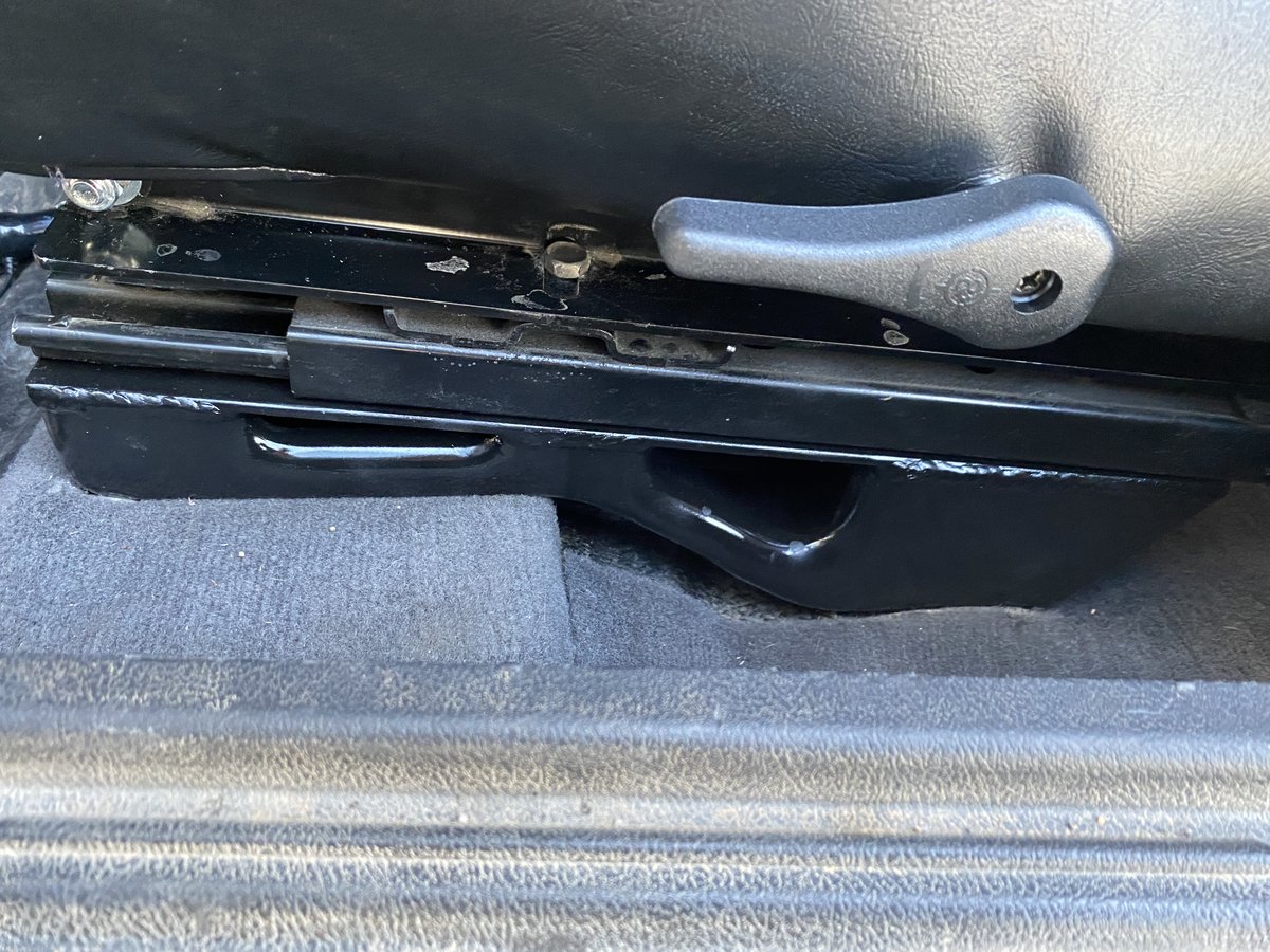

I bought a non flip and tumble base and cut it down 1.5” then welded on some 2” angle iron cut to match the profile of the floor on the inner side. I them drilled the top to accept the seat base slider and mounted the PRP adapters and seat.
Nice!! a welder is my purchase list. I'm not 6'5", but have a long torso and would love to sit at least an inch lower in the jeep.
Not sure what year your Jeep is but the 97-02 seats sit you up higher than the 03-06 seats by about an inch

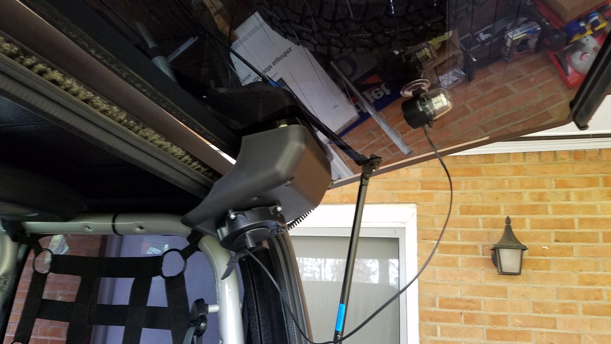

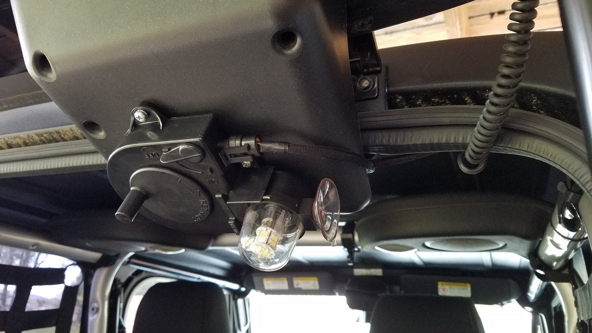

Couldn't find toilet paper at the grocery stores. So I decided to tinker with the Jeep again. Installed a NOS GM under hood light to the tailgate glass. Tapped into the OEM dome light for power (PINK wire) and grounded on the tailgate.
Drippy
Looks factory !
Awesome!

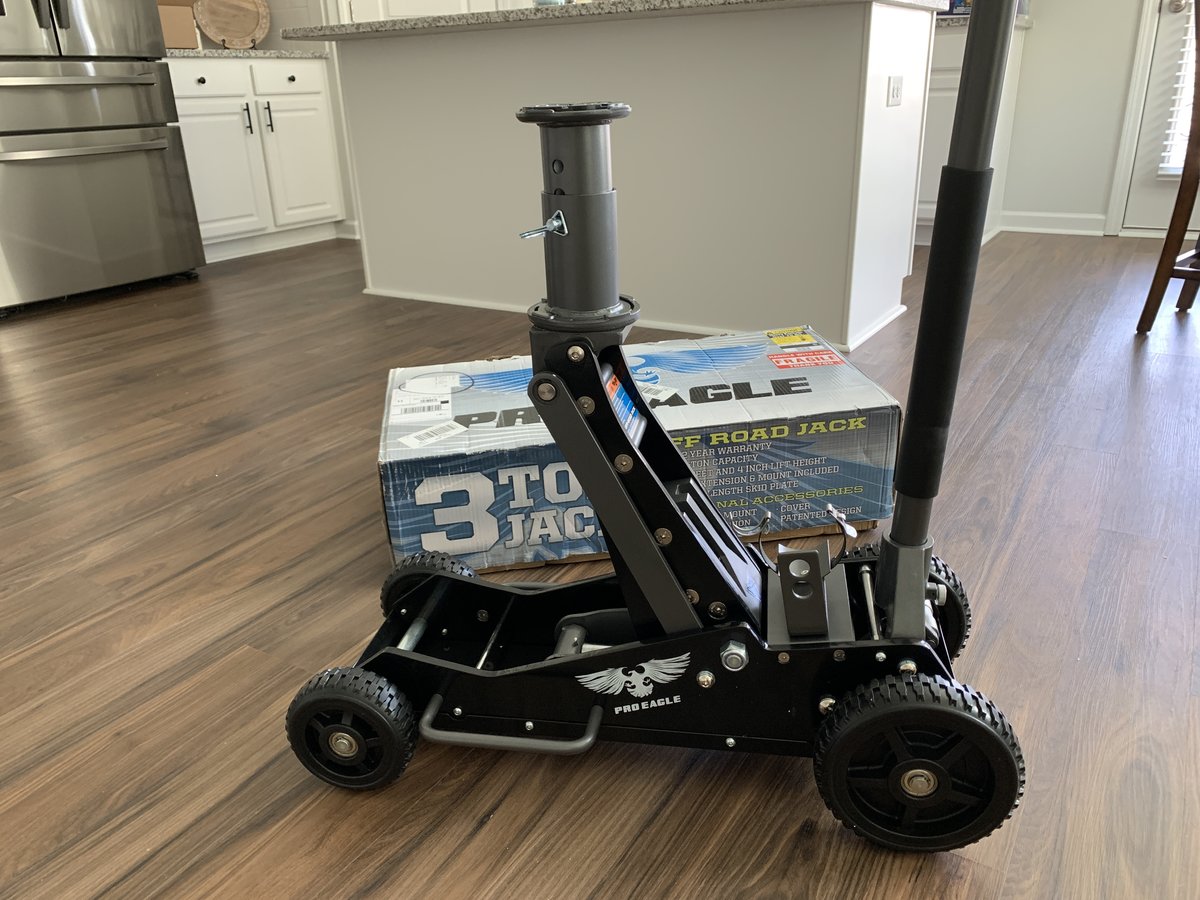

Got a new floor jack. 3 ton.

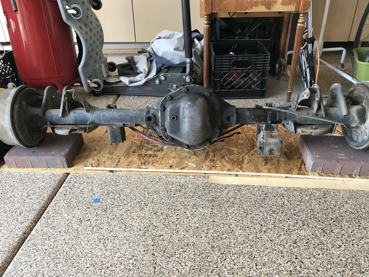

This arrived today......and the seller is giving me his 3.73 setup out of his Dana 30 so I can 4-wheel until I can get (afford) a re-gear fore and aft! Looks like it may need a pinion seal a little greasy there. Also he had cut the spring perches for shock clearance and he did a shitty job. But for $400 bucks she ain't pretty but she's mine. :cool:

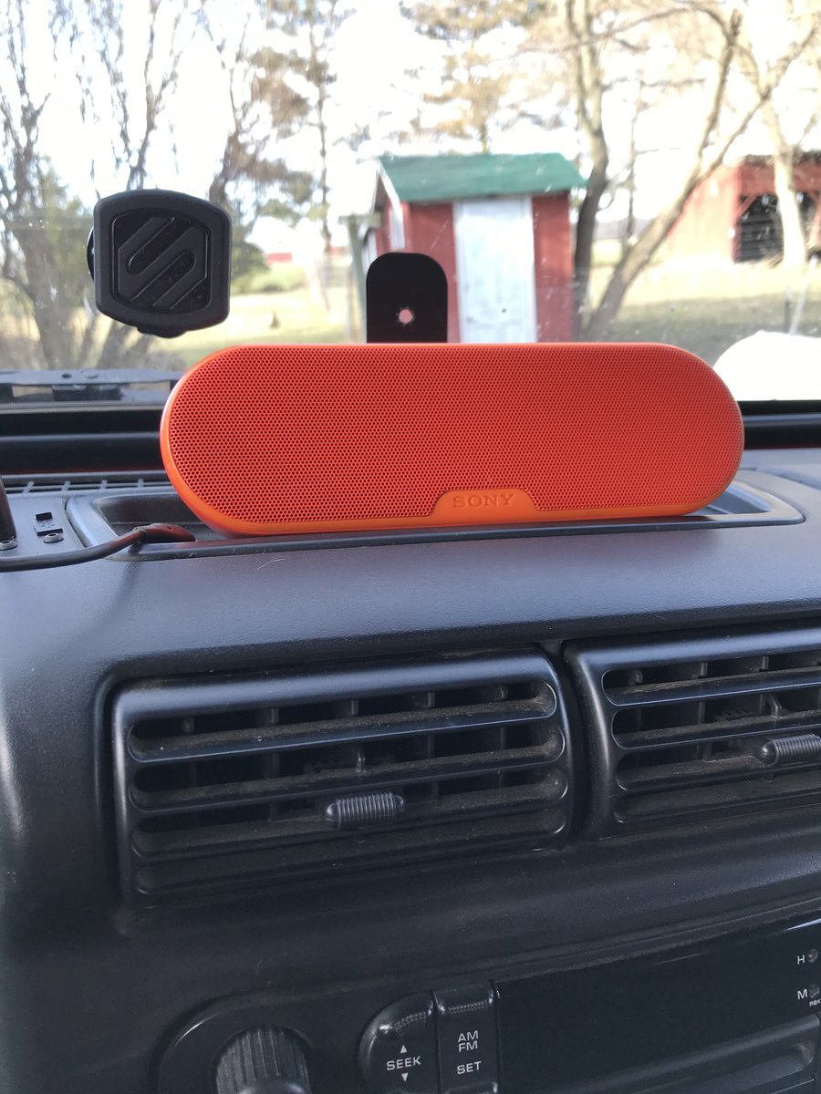

Come on. There is no way that can compare to the other speakers in a TJ/LJ.
It sounds different but not bad.
I have xm in my car and it has spoiled me, also I have a couple good pandora stations so the Bluetooth speaker allows me to listen to both. I wasn’t planning on upgrading the radio but I probably will.
