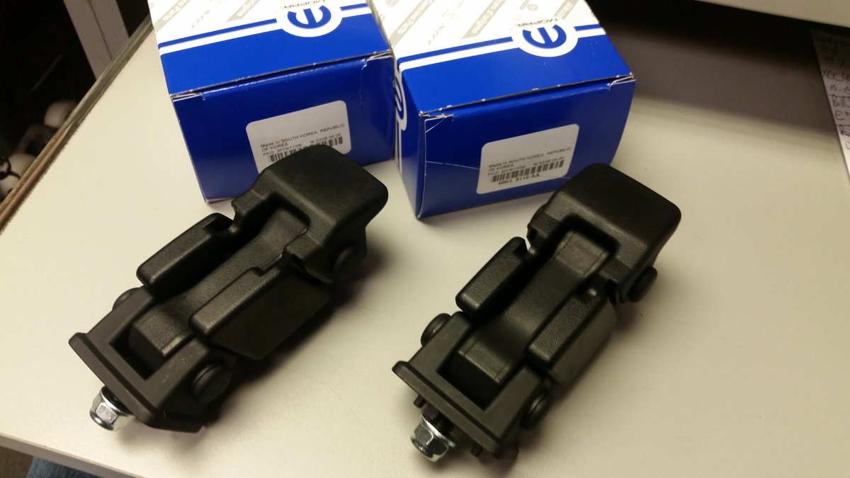

Got the new Mopar hood latches today. Popped them on when I got home from work. You can see the tear in the one and also, how stretched out the originals were. Looking forward to some highway testing.

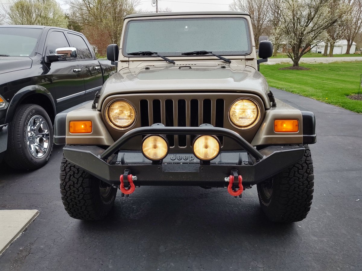

Wondering if anyone on here has replaced their H3 halogen fog light bulbs with H3 LED bulbs and the results..???Also while I had my wiring stuff out I extended my new to me fog light wires.

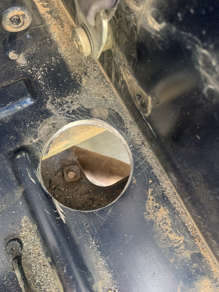

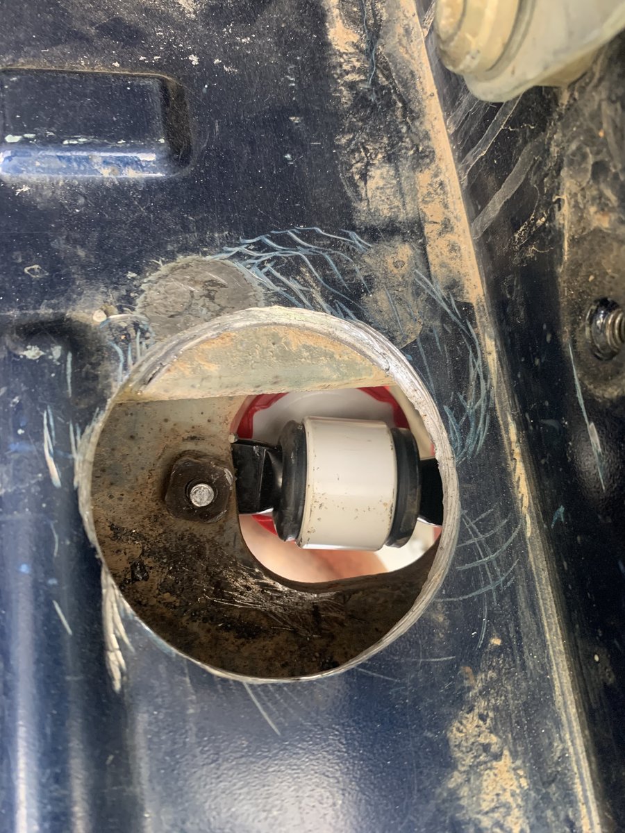

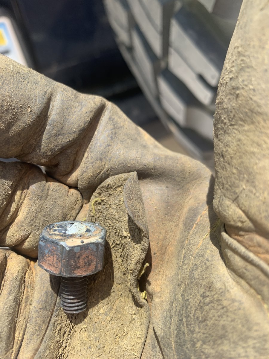

Lazy. Considering the tub could be lifted off the frame to gain easy access. Imagine cutting a hole in the tub to get to the front or rear yoke on a transfer case. Or the top bolt on a transmission...I cut a 3” hole in the tub to solve the upper rear shock mount broken bolt issue. Then I welded a 11/16” nut on the stud and brought it out the top with an impact.
I’m still trying to decide if what I did was genius, lazy or half-assed.
I did save the piece I cut out to weld back in at a later date if the mood hits me.
Btw, Rancho 5000x ARE, in fact, all they are cracked up to be.
Here’s pics....
hole
Broken Stud out after welding
and New Rancho buttoned up.... pic from above!

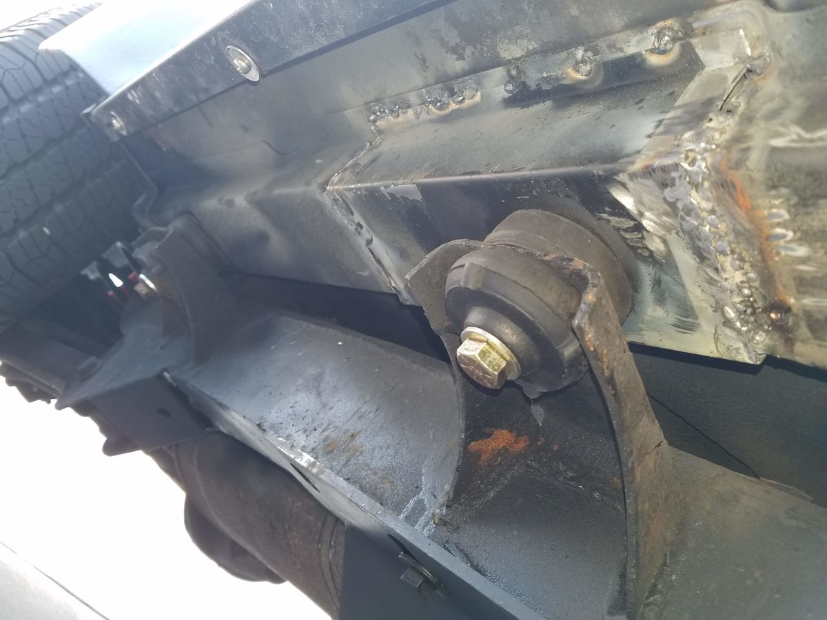

The patches came in. I tackled the passenger side today. It fit really well, but my upside down MIG welding didn't go so good. I may have to get a local welder to touch it up.Yah, I noticed that’s the location for a lot of TJ’s that I see ‘for sale’ in lots, up here in the NE. Interesting how its that spot more often. Least from what Ive noticed.
