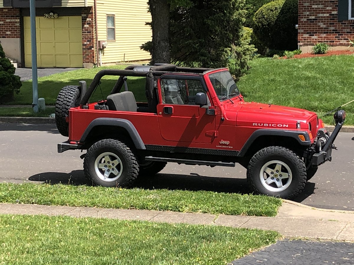

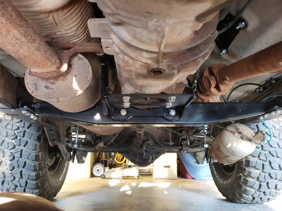

Installed Savvy BL, Rough Country MML , Currie Rock Jock Anti-Rock.
The anti rock I have only has 3 holes for adjustment compared to 5 from others I have seen.
Thanks again and thanks to the person that installed the 3.0 USB ports and posted about it. Reamed out the cig. lighter hole to fit the ports and relocated my ARB switches into the stock location with a little filing of the plastic. Now I need a duplicate of the switch bracket for the blank right side for my fog light switch. Not sure I like the USB port that low though. Can't really see it cause the ARB switches are Huuuge.

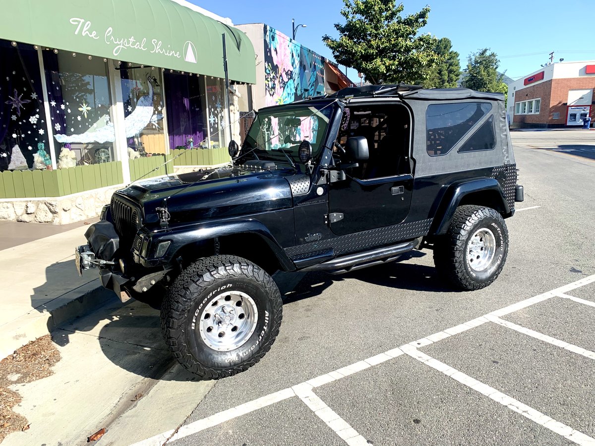

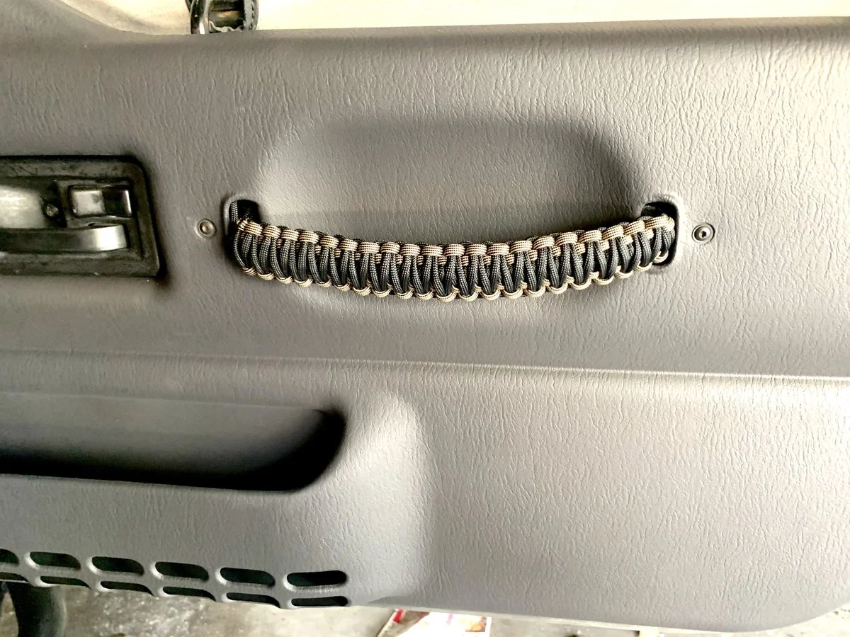

Made some paracord door pulls for my new set of half doors.
Also added the hinges and mirrors. Left the windows at home for their inaugural drive. A short one because I’m tired, but tomorrow I’m driving down PCH and giving them their first taste of that Cali coast. Love the drive with these on. I have full doors and two sets of trail doors, but these are already my favorite.
Made a set of paracord door pulls for a new set of half doors.
I didn't realize they did a redesign on these. The new look is more refined and I like it!

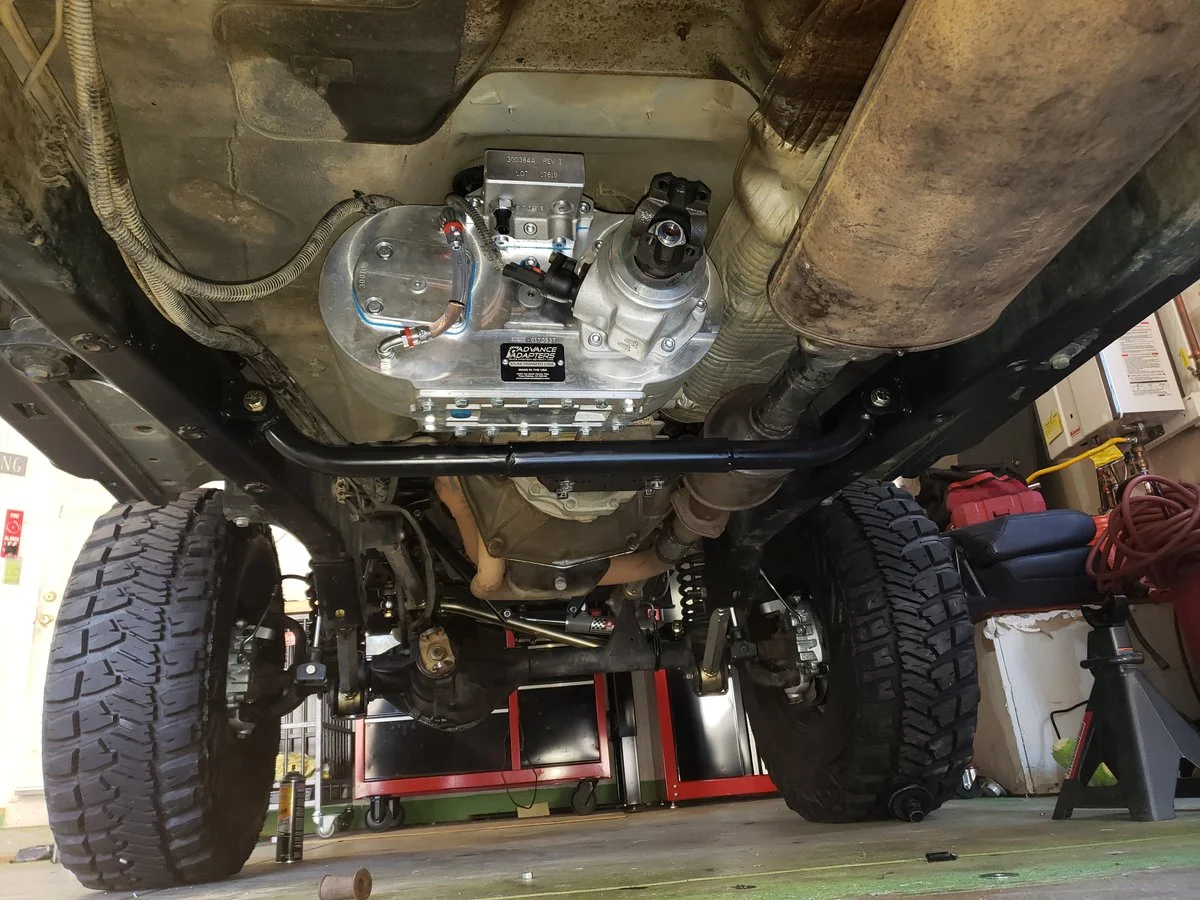

Yesterday - swapped in rear axle assembly for better gear ratio(already did front), changed rear sway bar bushings, painted sway bar and bushing cups, bled brakes and painted drums. I seem to be having some issues with the parking brake cables but will address that this weekend.
Have you thought about getting an Atlas support ring?
I have thought about it. During my research, I found that most people do not use the support ring and haven't had any issues. The Atlas is 110lbs and an NP241 is 90lbs so it's not a crazy difference.

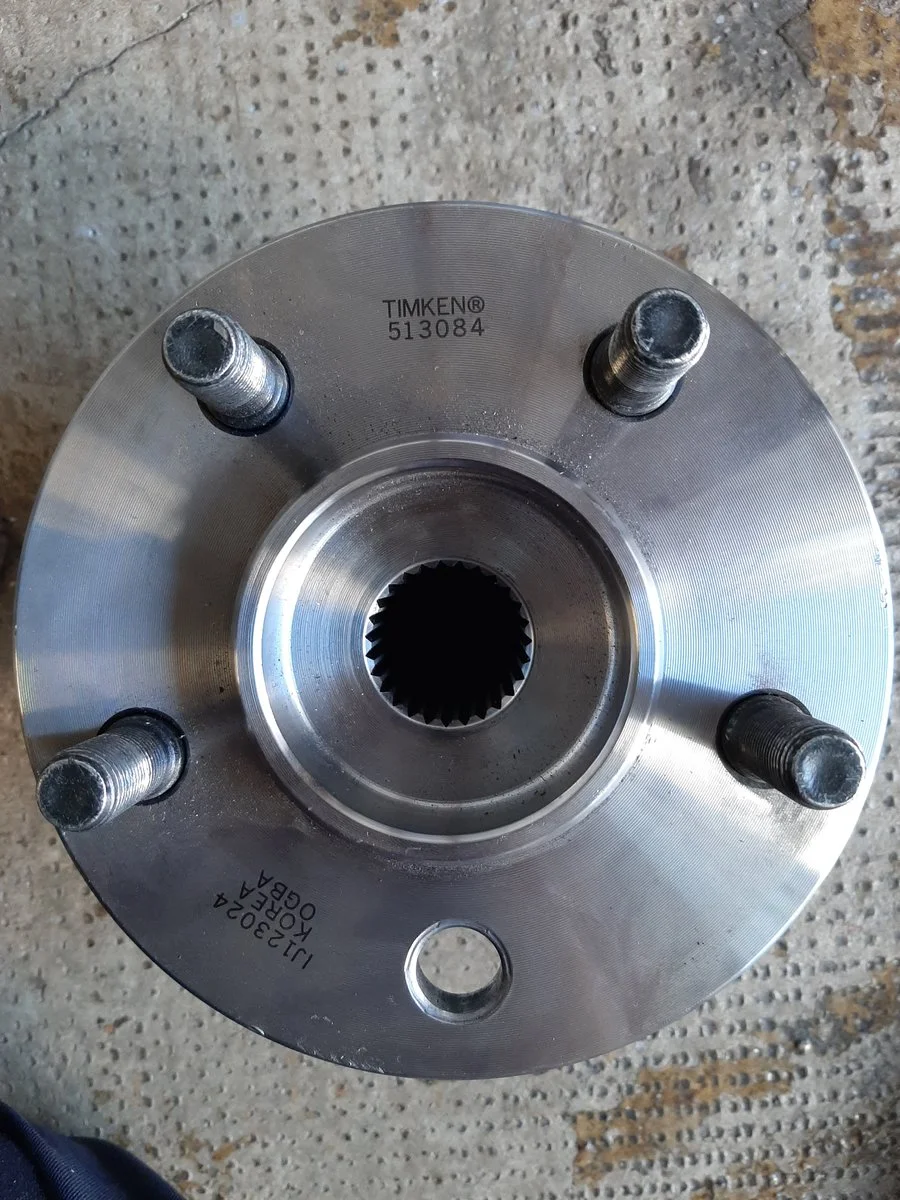

At the moment bad luck sticks to me, the bolts for my calipers were delivered today the assembly went well until
I wanted to screw the last wheel nut on. I wondered why the wheel nut cannot be tightened, the problem was that the wheel stud turned too. I removed the wheel bearing again, hoping I could fix the loose bolt, but the effort was in vain.
So I have to wait a few days for a replacement.
of course I only replace the bolt.:whistle:
