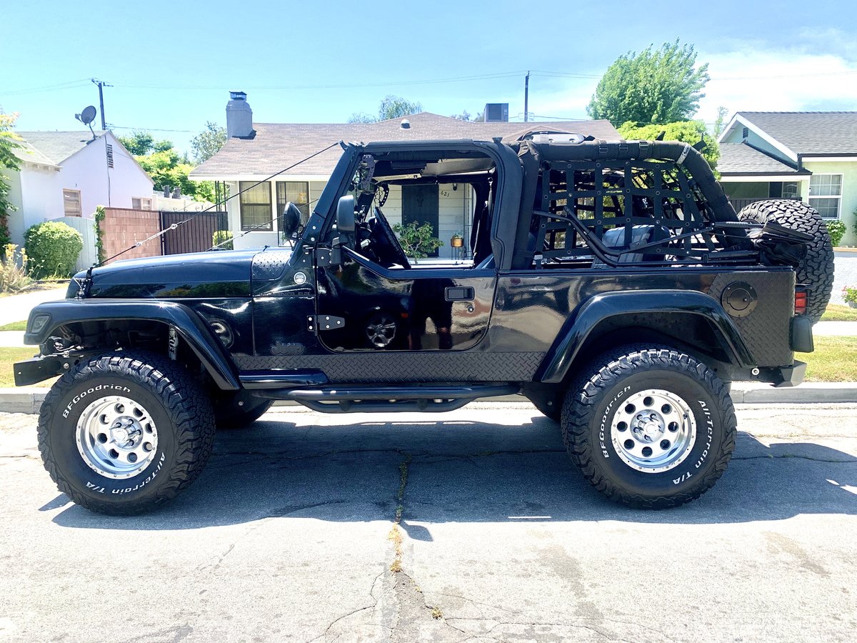

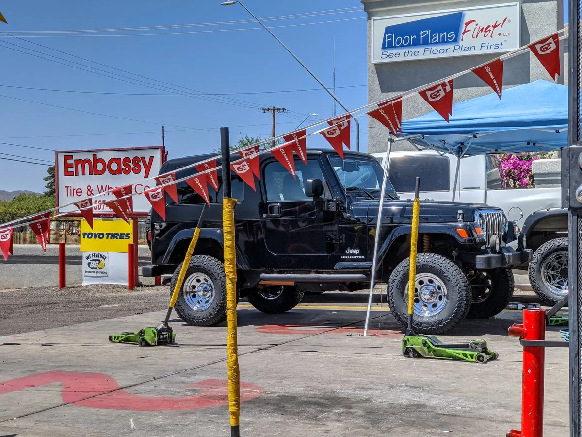

Took it to a shop to get my new Falkens on (32x11.5r15). The Goodyear mud terrains that were on before from the PO were super old. I've been delaying the install hoping to find a set of Ravines, but no luck yet and with the AZ heat now here, I didn't feel comfortable on the old rubber.

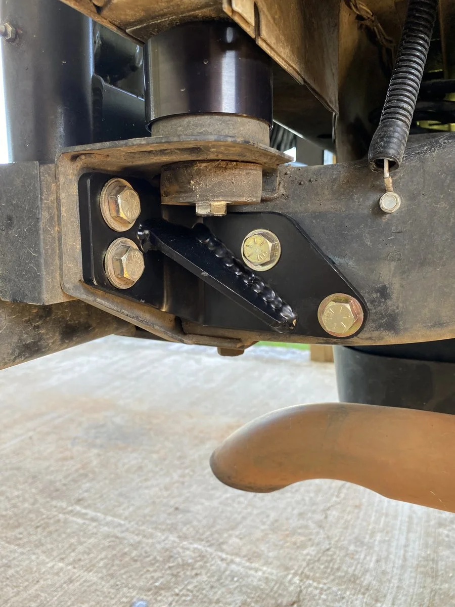

I have thought about it. During my research, I found that most people do not use the support ring and haven't had any issues. The Atlas is 110lbs and an NP241 is 90lbs so it's not a crazy difference.
Is there an adapter between the trans and the transfer case? Its usually the weight combined with the added leverage that can start cracking trans housings and adapters.

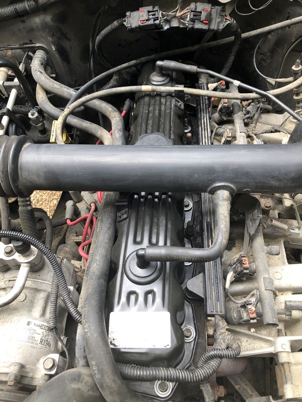

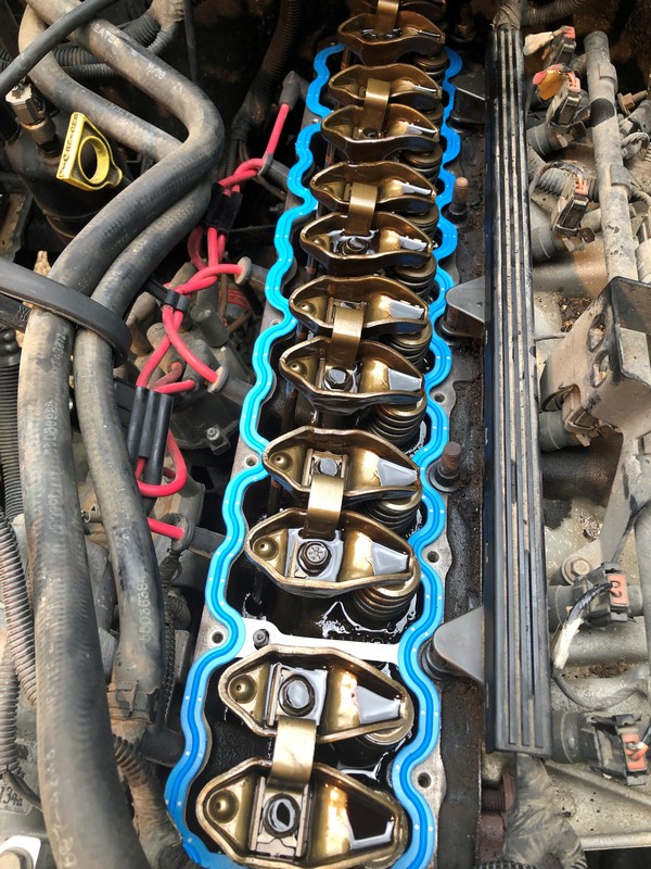

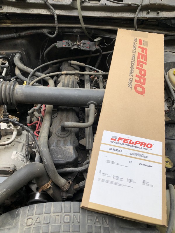

One of these days, I hope to be doing cool stuff to my Jeep, but today was just replace the valve cover gasket, drain and filled the front diff, and drained and filled the transfer case. So,now all fresh fluids in the drive train.
There is something satisfiying about just doing regular maintenance and peace of mind, for sure.
My '98 has just under 118,000 miles on now, and aside the rear diff bearings at around 60,000, there has been no major issue with it. Of course, it's not seen much off road miles and definitely not any treatment like my previous Jeeps. They were rode hard and put up wet.

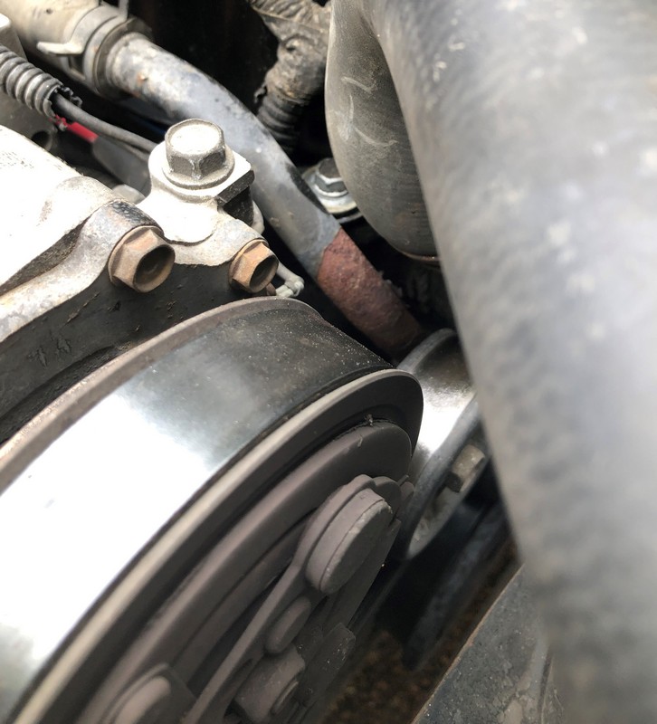

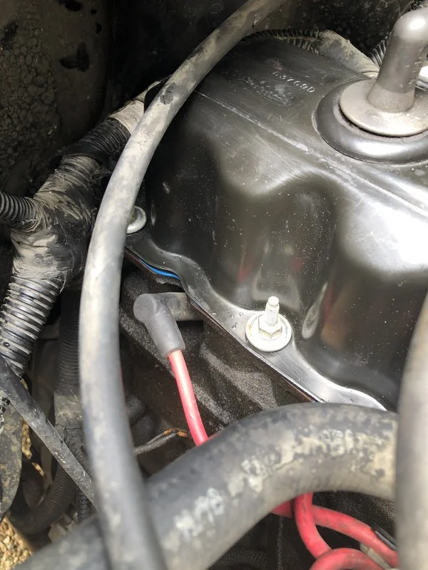

I did find one thing that concerns me, the rusted coolant tube that goes to one of the heater hoses. That's probably the most rusted thing on my Jeep. Anyone know where to source one? Probably not a corner parts store item.

I believe you are looking for a water pump inlet tube. I bought this one a few years ago and it’s held up fine:
https://www.amazon.com/dp/B001C6JCU0/?tag=wranglerorg-20
I am fairly certain you’ll have to pull the water pump to replace it though. Probably not worth the effort unless it’s leaking.
