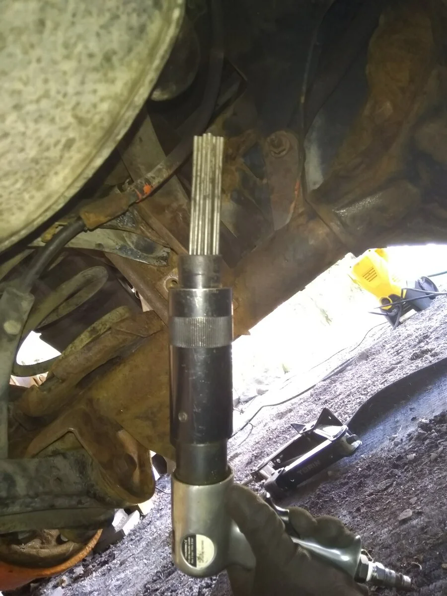

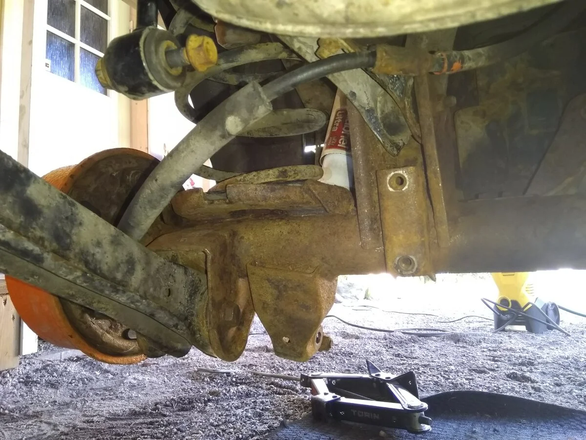

Prepared rear axle for por-15.
Needle scaler is my best friend at the moment😁

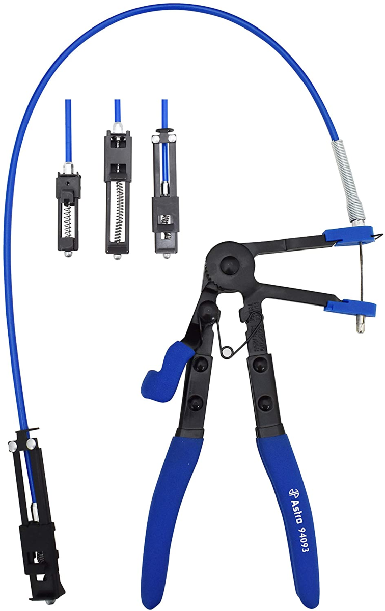

This style is priceless especially for awkward angles and hard to reach hoses.
https://www.amazon.com/dp/B01JBL7TA2/?tag=wranglerorg-20
These are good too. I used them on every Constant tension hose clamp on my Jeep back in November. I had some worm type clamps that would leak during changes of seasons. Rebuilt the entire cooling system (except heater core that was changed 2 years earlier) in November and went back to constant tension clamps everywhere. No leaks since.
https://www.amazon.com/gp/product/B005MVB5XS/?tag=wranglerorg-20
Much easier to use for easy to reach clamps for sure, that is similar to the first style I ever bought..

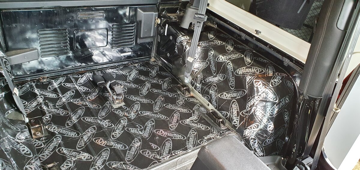

And done. Dynamat xtreme bulk pack (9 peices) covers the tub really well. If I'm still not happy with the noise I'll get enough to do the doors and tail gate. Had enough off cuts to put some in with the speakers too.
Was the 9 pieces only used up only in the tub (behind the front seats) or was it enough for front half too ?

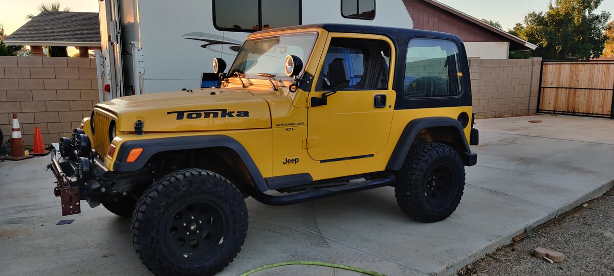

We put the top back on wifees TJ. Getting ready for summer hell fire!
OMG....is that a "killer" Hi-Lift jack on the front of her Jeep?? Just kidding, I just had to say that with all the Hi-Lift haters :). I have one on the back of mine as you probably already know.
