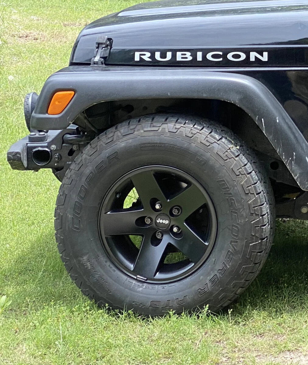

Broke down the two front tires and the spare all beadlocks and installed 10oz of tire balance beads to each of them. I’ll do the two rears tomorrow my back can’t handle anymore today. I’m hoping it works well. I’m tired of rebalancing every time I chunk a tire on the rocks
How do those work? Just roll around in there and find the place they need to be through centrifugal force?
Is there a speed (I imagine very slow speed) where they just fall in the tire and you’d hear them moving around?
Just curious. I’ve heard of them but have never known anyone who used them.
They are supposed to spin and then find the light spot and balance it out. Yes at low speeds the just stay at the bottom of the tire. I have never heard them in a tire that was on a vehicle. You can hear them if you bounce the tire off the car or listen closely while spinning it while on jack stands. I’ve run them in my motorcycles for years with no issues.

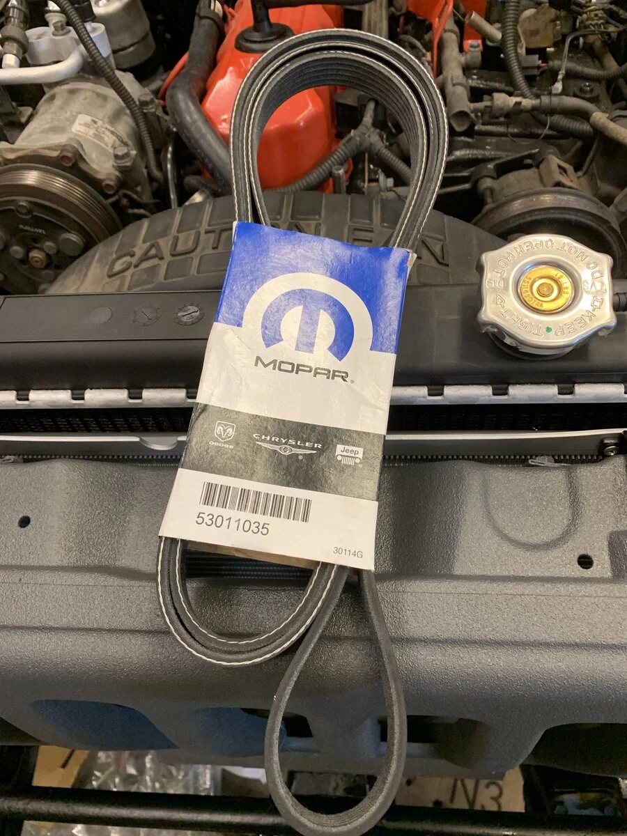

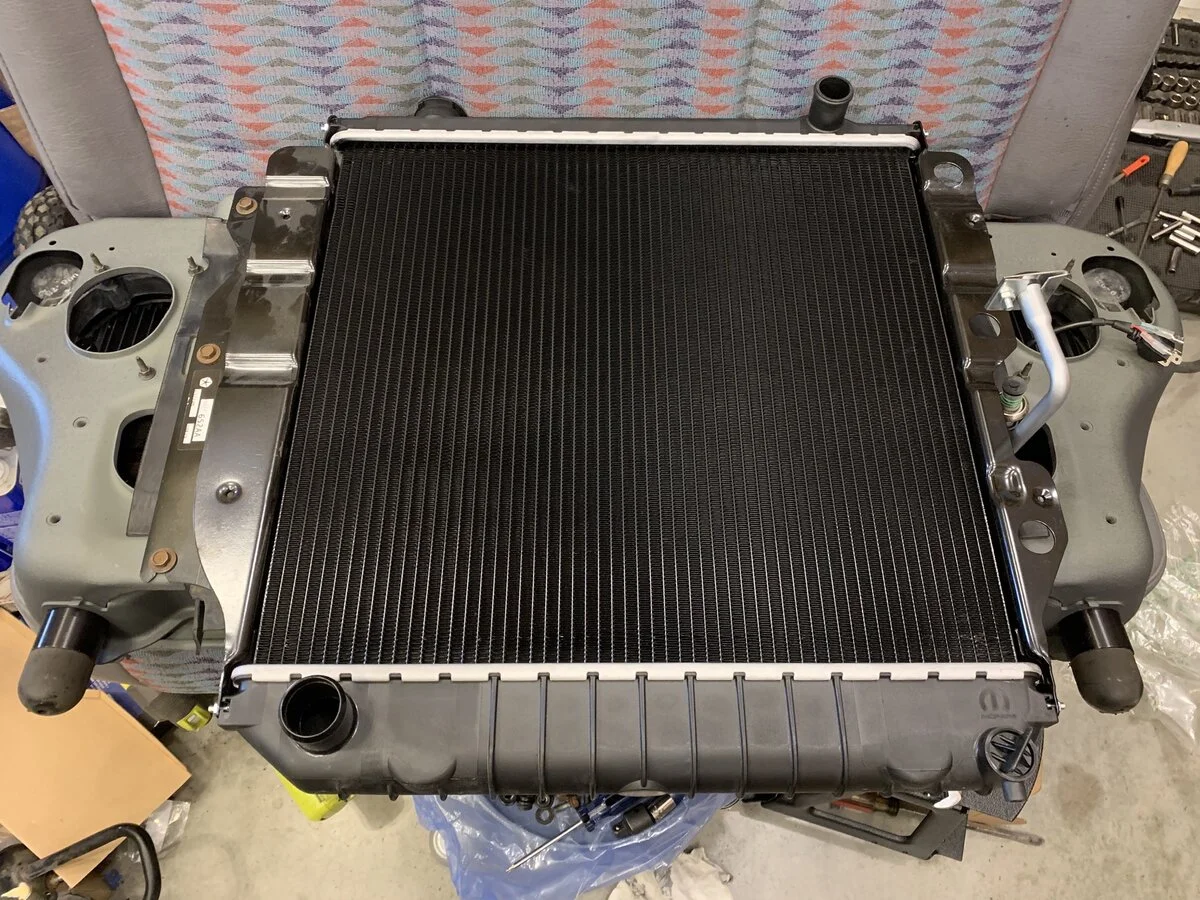

Installed my new Mopar radiator. Never was a radiator install so easy. Of course, having the grill out and laying flat helped!

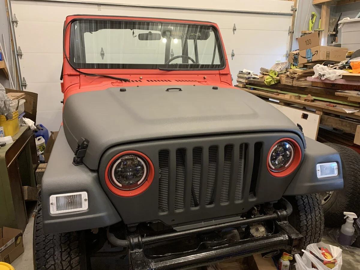

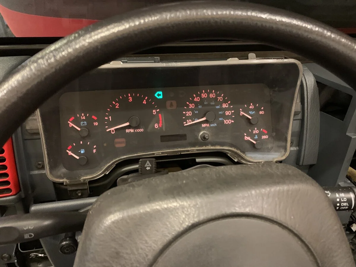

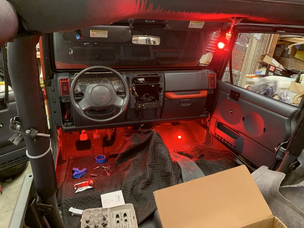

Got the Mopar serpentine belt installed, as well as my red interior LEDs. Then I got the full grill assembly put in! Hoping to try to fire up tomorrow!?!?!?
