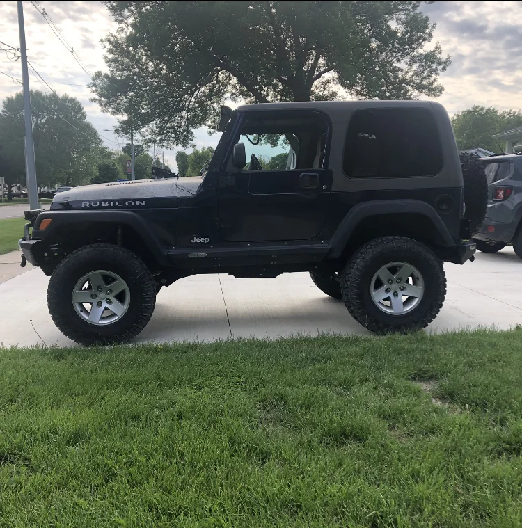

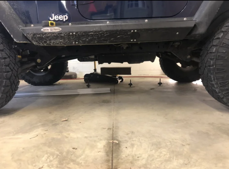

New to me Rubicon 2003. Trying to get the setup right. I did the Rough Country high lift skid plate, 1.25" body lift, and 1.25" motor mount lift and compressor relocation bracket. I ended up with about 2.5" additional clearance at the lowest parts of the skid plate and 1.25 at the body. Biggest difficulty came in with getting the rear pinion angle dialed in. I already had an appropriate double cardan rear drive shaft so needed to get the rear pitched up. Unfortunately the rear shocks no longer cleared the rear edge of the spring perch. I ended up deciding to remove a notch from each perch to allow clearance for the shocks. Did not require much trimming as they move away as the rear travels up. The new skid plate is way beefy but smaller with nice design, tapered angles at the edges and hidden hardware. All done for under $ 500 from Morris 4X4.

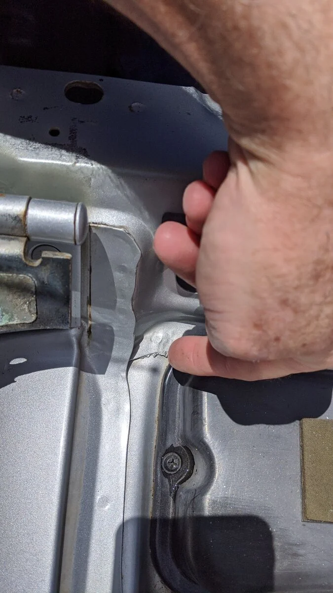

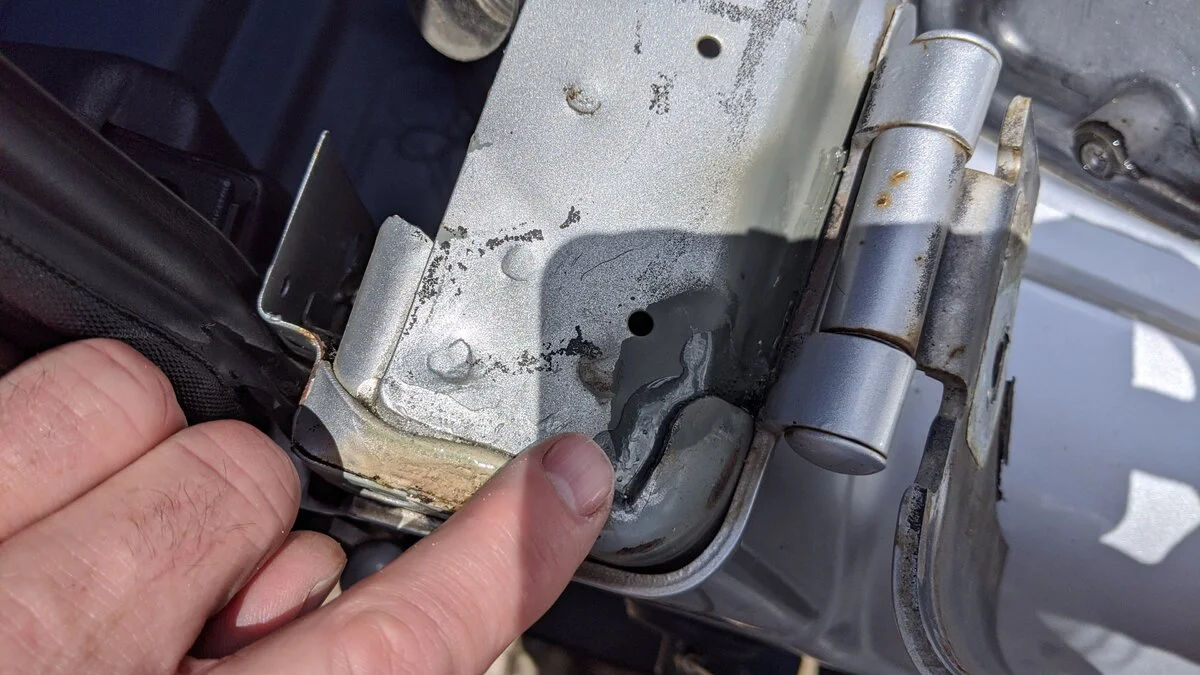

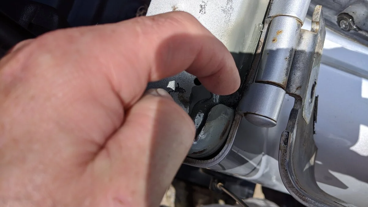

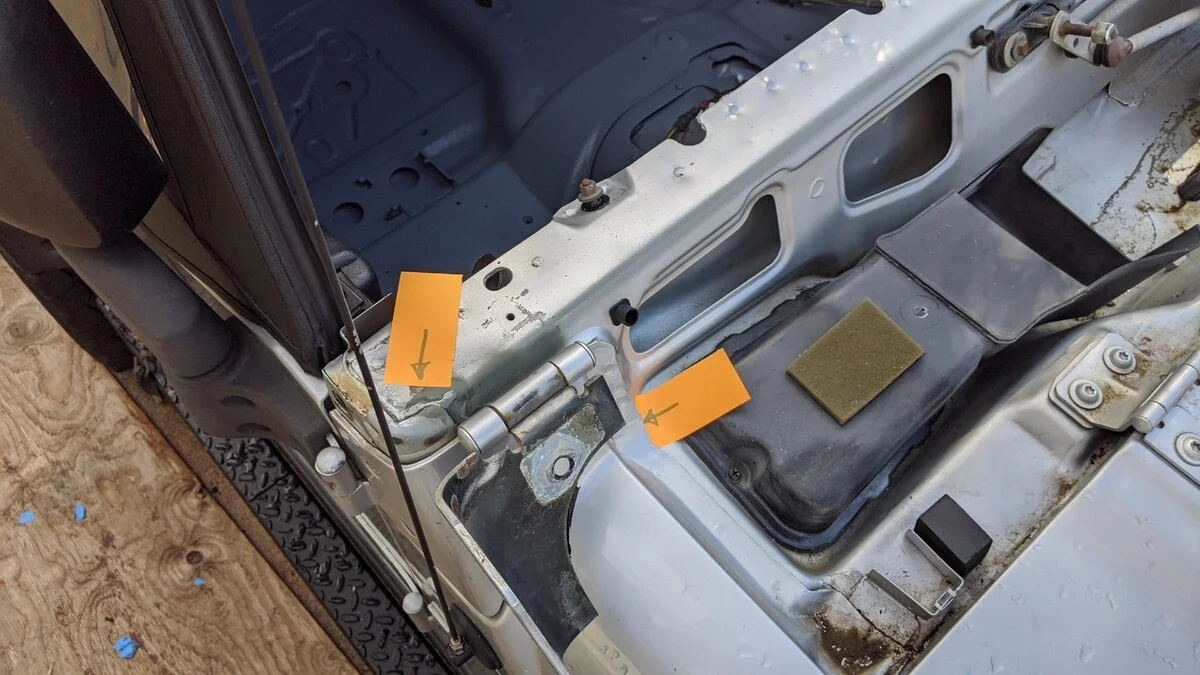

Water leaks are a bee-atch. If it's coming in the front and ending up in the footwells, be sure to check the seam between two body panels at either end of the piece where the windshield gasket is mounted. You have to flop the windshield forward (removed in pics) and lift up the edge of the gasket (also removed in pics) to see the seam.
The factory fills it with body putty and in mine, it was pretty dried out and a bit rusty, indicating some water penetration. I dug out the putty, cleaned up the metal, blasted with some etching primer, and then re-sealed it with some Lexel clear sealant (industrial stuff). It would be easier to get to if the windshield hinges were completely removed but that requires removing the doors and I didn't have time when I did this. You will probably need to put something under the rubber seal to lift it and keep it off of the sealant while it dries or it may be next to impossible to ever remove it.
On my 2001, I also sealed the rest of that seam as it goes down and across the inside of the well under the cowl (also removed in the pics). Sealing the place I'm pointing to in the last pic is what finally got my 2001 to stay dry. I'll probably seal that one this weekend...if it doesn't rain.
View attachment 167089View attachment 167090View attachment 167092
Do you have a backed out photo- this is in so close I am only guessing the window is laying down forward and you are showing the inside of windshield hinge — I have a leak on my passenger floor mat that appears when i part slightly uphill or level.

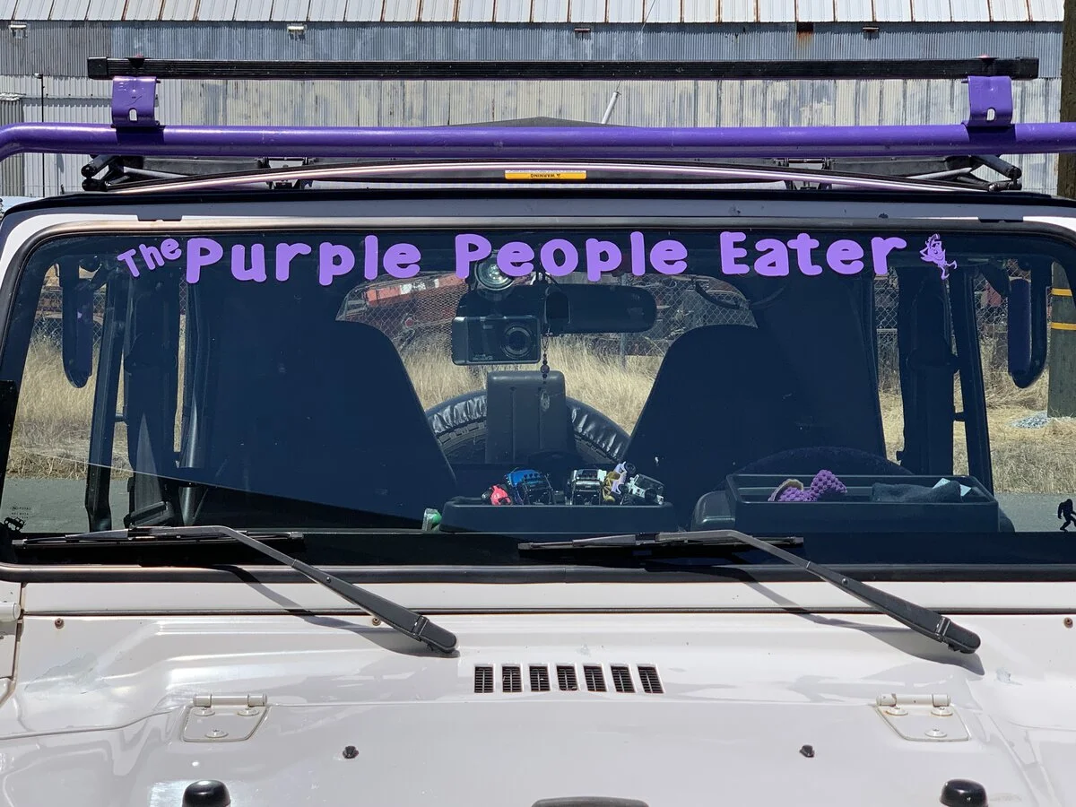

Yesterday the kid put the new windshield in so today I put stickers on it. I went with a different font then the last one, but I'm not liking it to much. I'm going to give it some time and see if it grows on me, if not, I will print another one up using the same font as the old sticker. If I can remember what it was now. LOL
And you all say TJ's don't have Easter eggs. :D LOL
Ready for a tour of the local homeless encampments? ;)

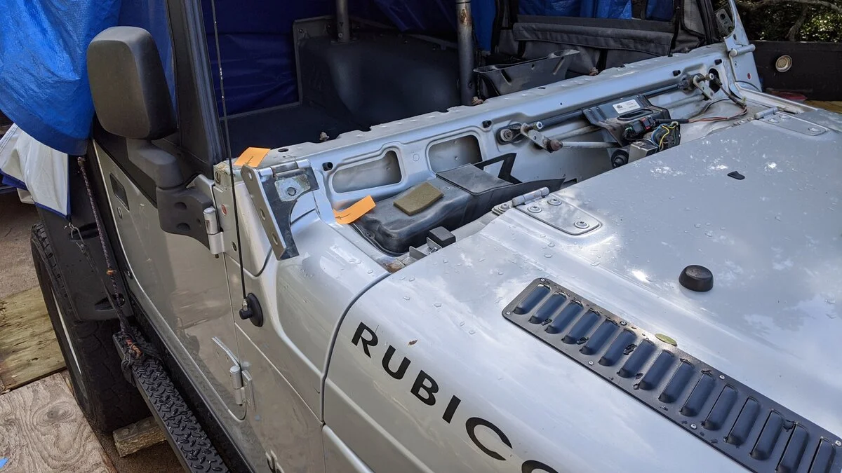

Sorry 'bout that. You actually had it right except that I have the windshield completely removed. Here are some positioning shots. The upper arrow points to the area I sealed a couple of days ago and the lower arrow points to a place lower down in the same seam where a fairly good size gap exists. As I recall this was not a big gap in my 2001 so they probably changed the design but, it was there that sealing it up finally fixed the leak in my 2001...which also put water in the passenger footwell.:mad:

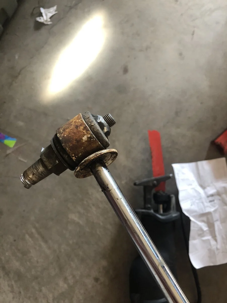

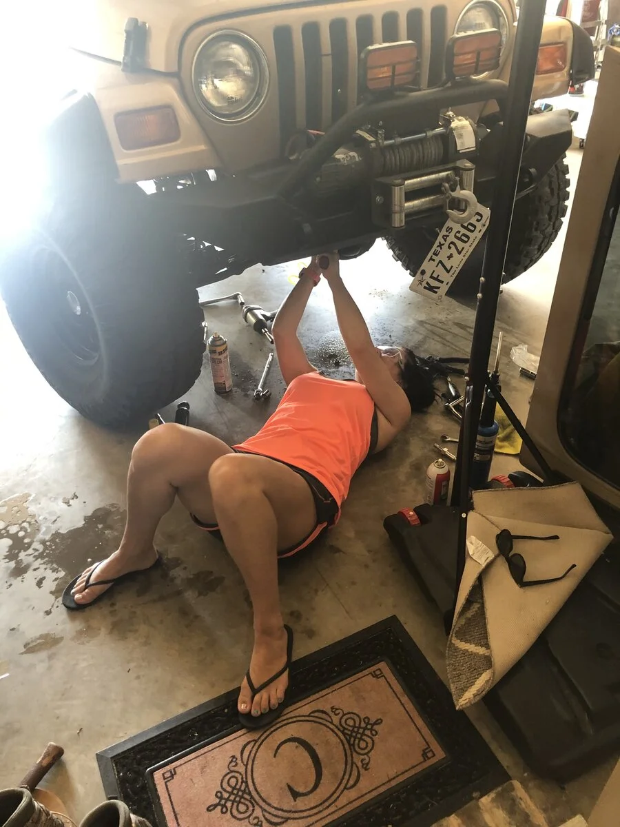

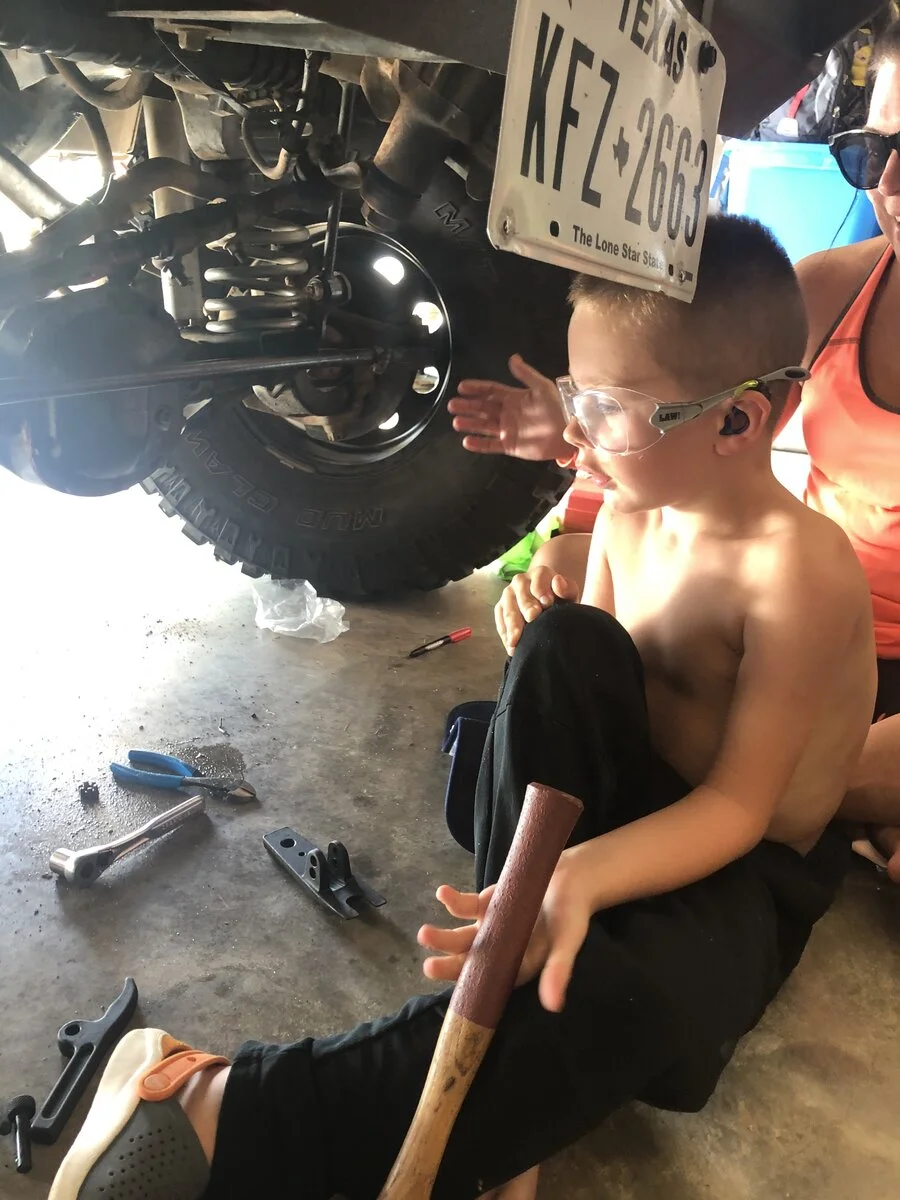

Should I go get a puller? I think some others have had success with that.
Heat and penetration oil isn’t working for me.
I'd try a pickle fork. The damper is being replaced, right?
You can get them at any auto parts store and could probably borrow a loaner one for free...call around.
Yup the damper being replaced. That bolt gave us fits! Heat,PB BFH, swear words,ball joint separator, and a sawzall got us going.
