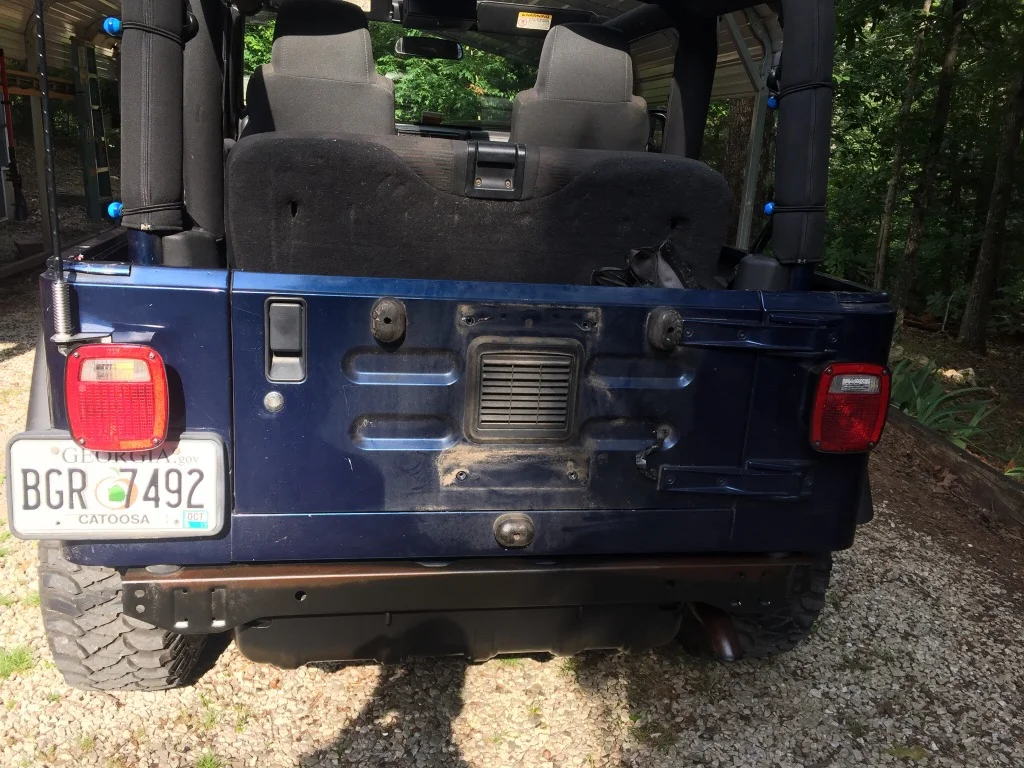

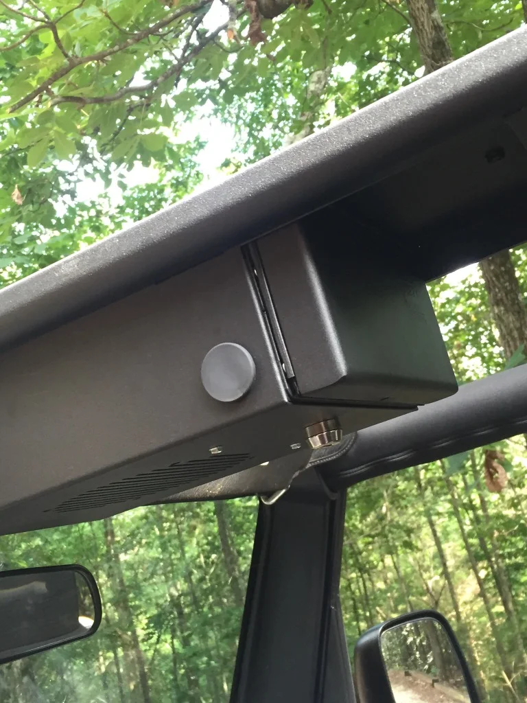

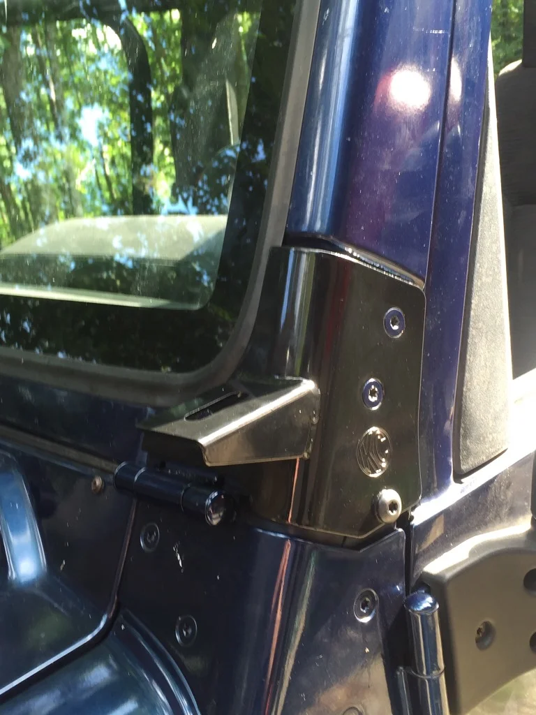

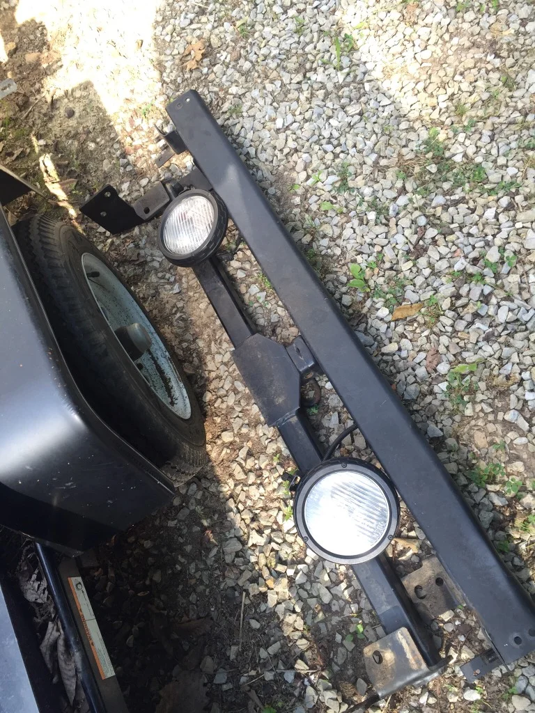

    Put a few things on, took a few things off. b60a48dbdcdf31fdef9963c9b69022cf.jpg 20d9418323e0cb2814a548fd099dfd5b.jpg b52612e3997c37f401ea58ae51aadf5b.jpg 92767b4d0afe37d7ad4ad73367fea28f.jpg b87dfcf0056ab25c3b815100f01059d6.jpg

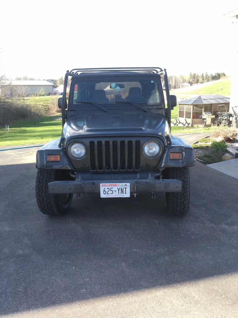

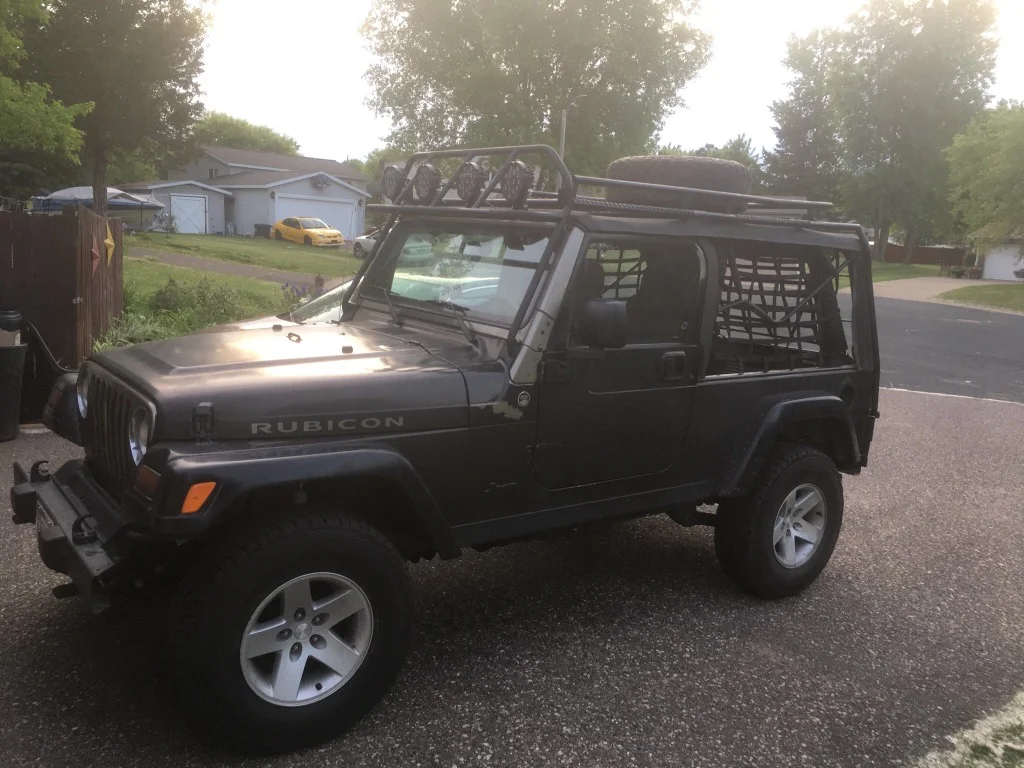

    You bought it like that? That's ballsy! I don't think I could have bought a vehicle that had been rattle canned.

    It was half its value because of it hah. So happy I did now that it's over

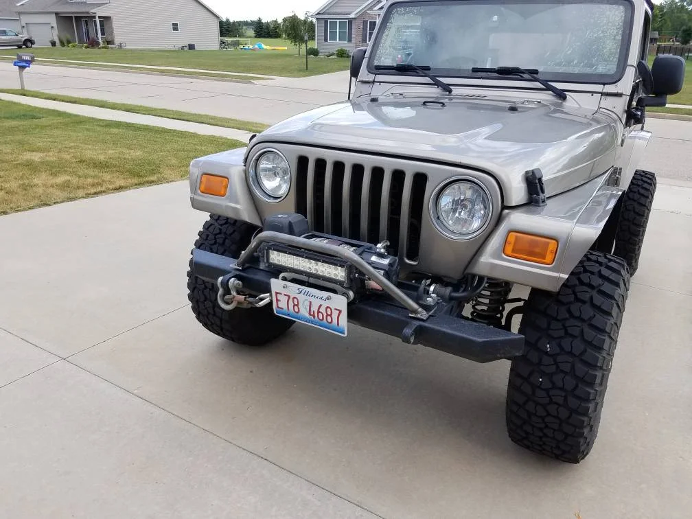

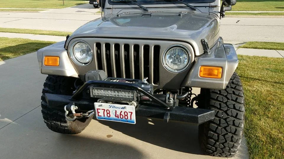

    Built a bull bar yesterday playing around with my new hf pipe bender and some 1.5" .120 wall tubing I had laying around. Got it painted up and mounted today. It's welded to some 1/4" plate that I slipped between the factory tow hooks and winch plate. 23fb5b7c062e506bfa7804eb43d986f4.jpg 3145ebd00be264a815f7f5129e279358.jpg

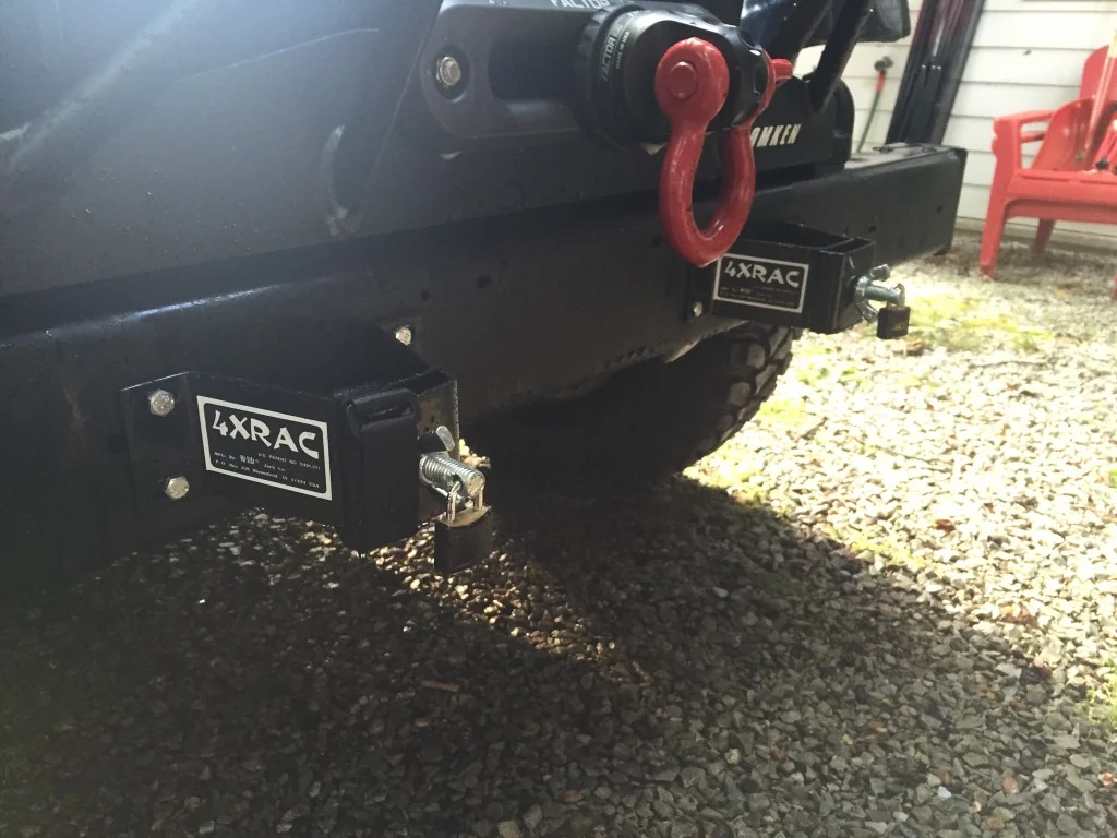

    Shined up my front bumper Hi-Lift Jack mounts cc2e91542ecefac2c7b521b2bce075c9.jpg
    Also broke two extensions taking my old rear bumper off, and bought an impact wrench.

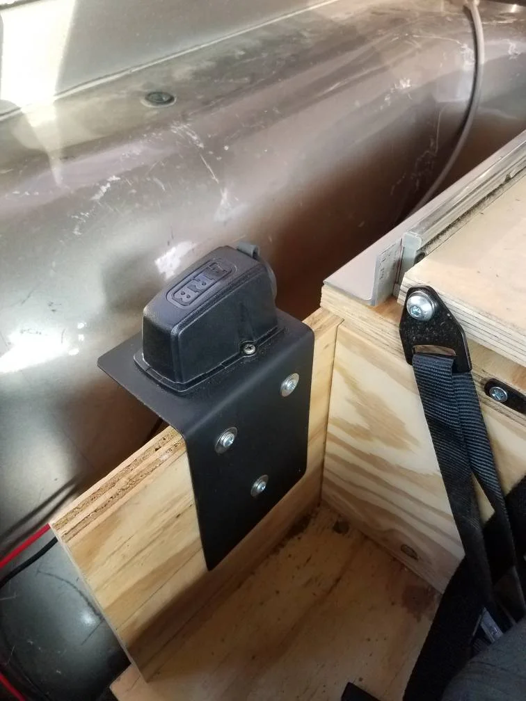

    I also made a bracket to mount my arb receptacle for my fridge so I don't have to use up the 12v outlet on trips. Mounted it right behind my fridge slide. I still need to finish running the wires though. a4ebb72f45cc19d2a270712ffd807c8a.jpg

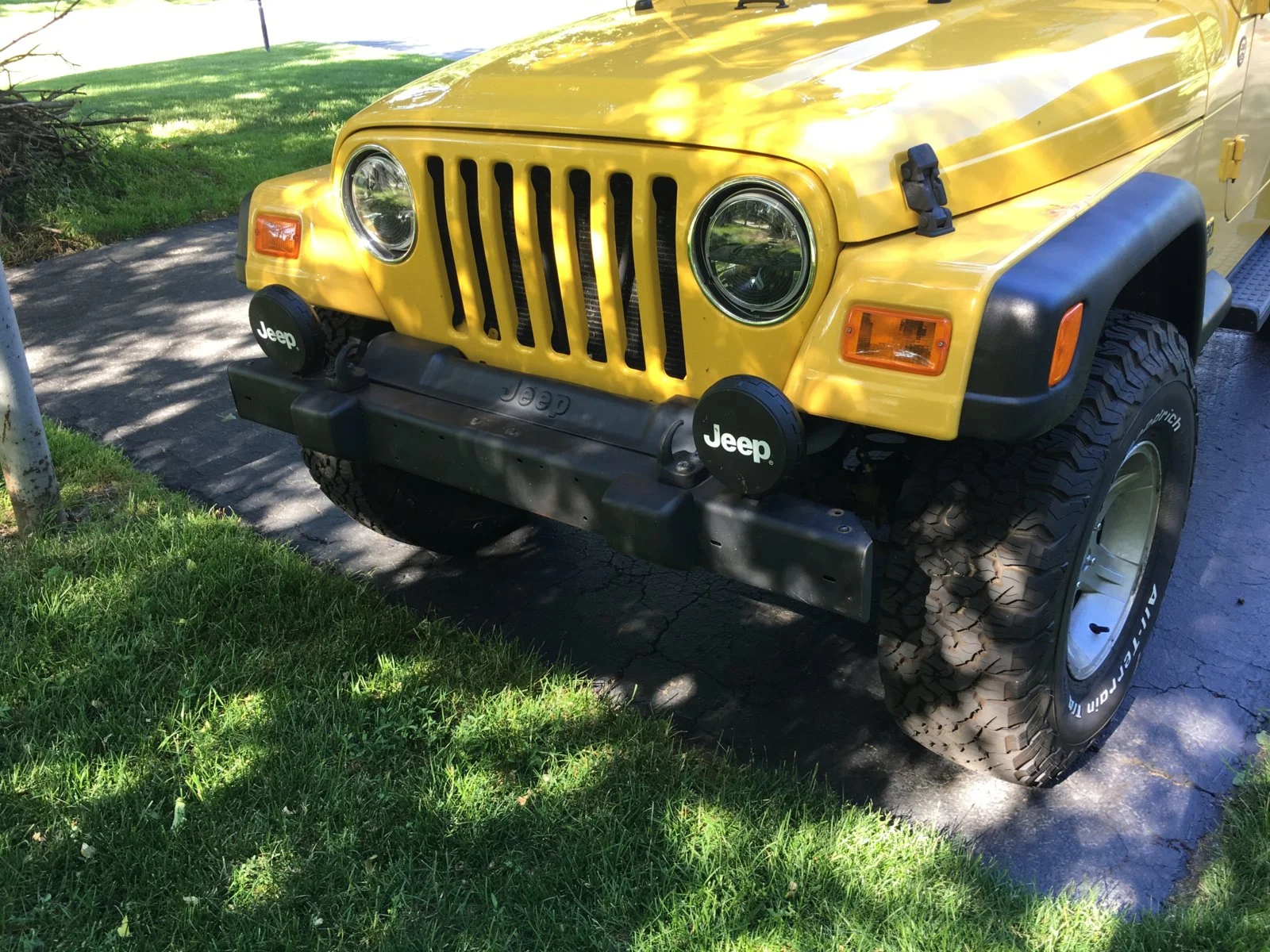

    I removed the flotation devices. Looks much cleaner.

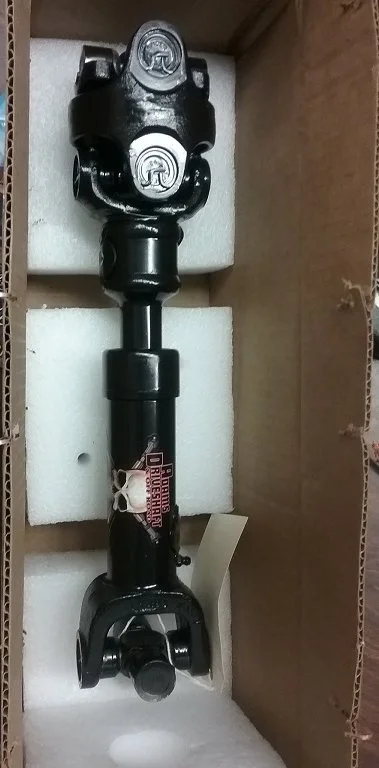

    That there my friend is a new rear double cardan drive shaft to compliment my recent SYE install. this and a angled TB relocation bracket are the final pieces to this mod.
