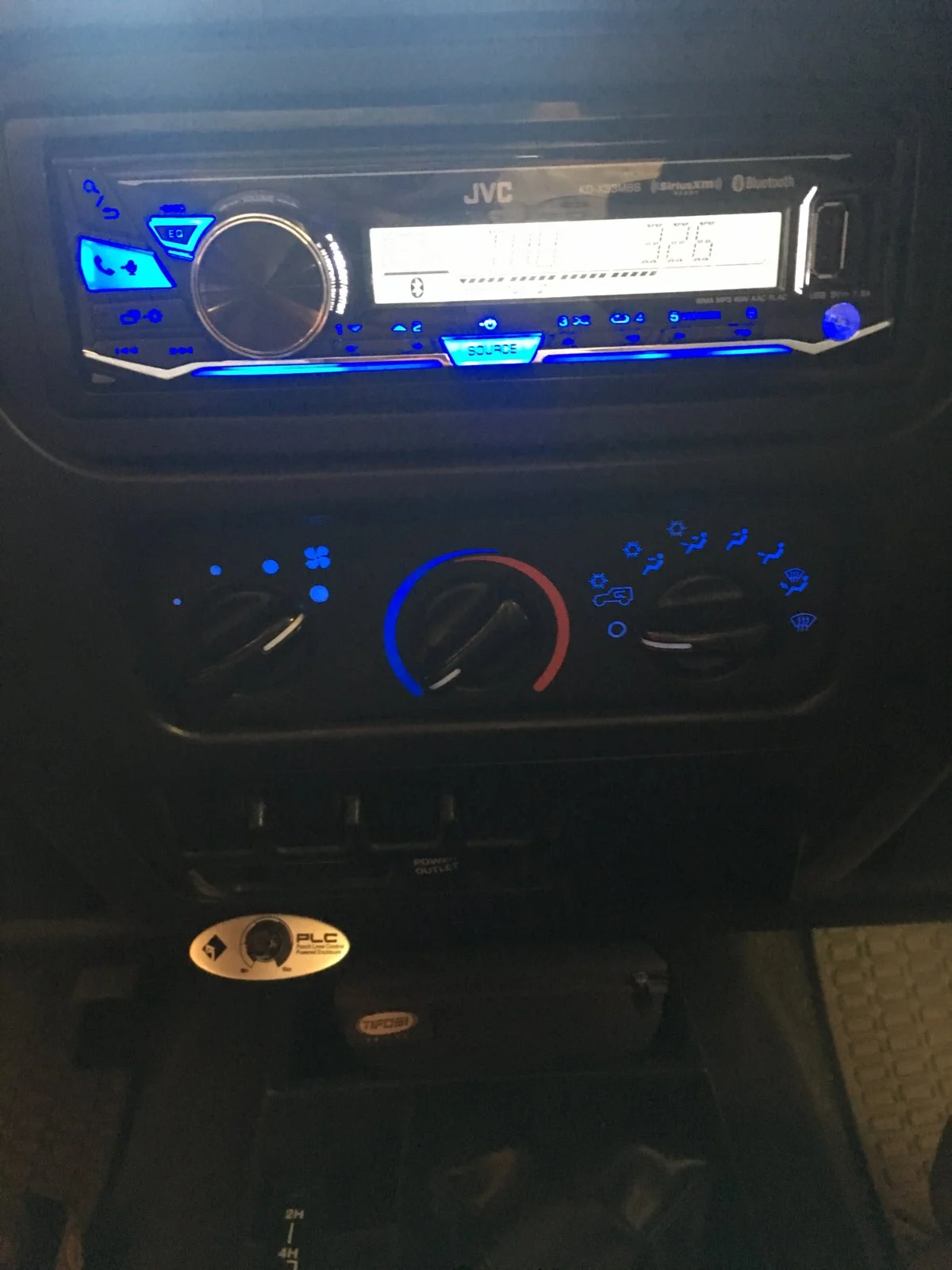

Installed Novak shifter cable. I thought it was pretty easy. About 1.5 hrs.
I've been wanting to do this too. I've watched the video of it being installed on "Bleeping Jeep" a couple times.
Did you have to remove the skid plate and lower the tranny to install it? Seemed like the hardest part would be getting to that top bolt on the transmission / transfer case.
No I did not. Having to remove skid plate caused me some hesitation but it was completely doable with it on. If I was to give you one tip. Maybe install cable onto brackets before mounting brackets. It was difficult to get a large wrench to tighten those cable nuts. But like I said. It's definitely doable.
Top bolt was no problem. Video does make it look difficult but that really was not a problem

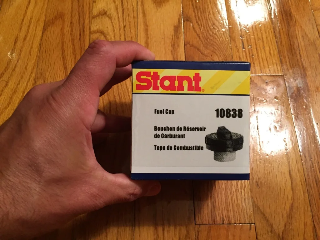

For future reference THIS is the cap that solved the CEL glow. 8 bucks @pepboys. Cheaper on Amazon, but by less than 2 dollars. And I wanted this resolved asap. Btw, made in USA. Strangely enough, it cost less than the Mexican made one @advanced auto.
