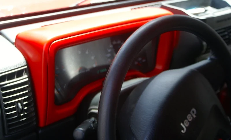

I never knew that the door surrounds folded in half until I took them apart for painting. I ditched the rusted bolt and locknut combination for a cleavis pin and cotter pin. The cleavis was too long and didn’t have a hole close enough to the depth of the plastic, so I drilled a new hole with my press, and cut off the excess with a Dremel. Result: I can pull a pin out and fold them up when I drive doorless!
(Sorry, no pics folded cause I’m too lazy to take the surrounds all the way off again!)

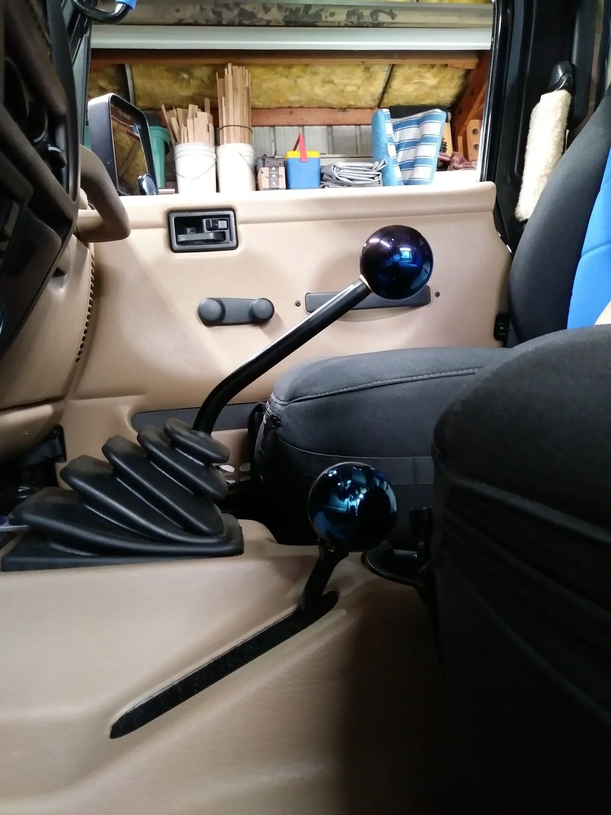

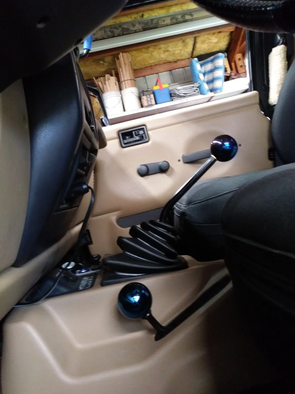

Thanks to @Zorba and his t case shift lever conversion, I got the mod bug again. I found a lever as was offered on ebay at my local pull and save. Installed it and ran into the clearance issue in 4low,described by @Zorba and another on here. Also compared to the tj lever, the doner lever was straight in all regards whereas the tj lever has a driver's side leaning bend to center the lever in the console slot. The tj lever also has the appropriate z bend for clearance in 4low so I moded the tj lever by cutting it just before the bend to the rubber handle. I then took a metric torx button head bolt m10x 1.25 and drilled out the head to 7/16 which is the shaft size of the lever. Welded the bolt in place, did some grinding and painting and the mod is complete. Matched the shift knob I already had for the tranny.
While I was in there I removed the shift gate detent that makes the dogleg right to get to neutral. Much nicer shifting through the
t case.
