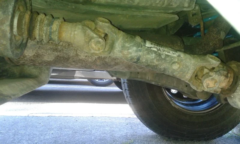

I got my 35mm (1.38 in) spring lift installed recently and didn't expect any problems. My understanding is that lifts up to 2 in don't cause any driveline issues but it appears that all TJ's are a bit different. My TJ feels a bit rough now and I don't know if it is coming from the driveline or maybe it's just because the springs are a bit harder that I feel something. I certainly get some vibrations at some speeds but the frequency is matching the revs of the engine, not the drive train that rotates a lot slower.
So, what do drivetrain vibrations actually feel like?

Maybe I'm just a bit paranoid. I guess it's best to measure it, so I ordered an angle finder yesterday. Just from looking at it, it doesn't look excessive. The drivetrain was almost a straight line before the lift, probably because the old springs have been worn out.

Even though the driveline angles aren't excessive, you did change them.
An older ujoint may now be operating out of its (normal) worn position.
This could apply to the slip yoke position too.
Try pulling the driveshafts to verify if the vibe is in the front or back.

"Try pulling the driveshafts to verify if the vibe is in the front or back."
I'm not sure what I should do here. Just try to move the driveshafts to see if they have play somewhere?
It's a troubleshooting method for determining if the vibes are coming from the front DS or rear DS by doing the following:
Remove the rear DS, then drive in 4wd to see if the vibes are gone.
If you still have vibes, then drive with the front DS removed and the rear DS installed. Edit: You might even want to do both tests regardless of the first test's result just to ensure it's not only occurring when both are hooked up.
