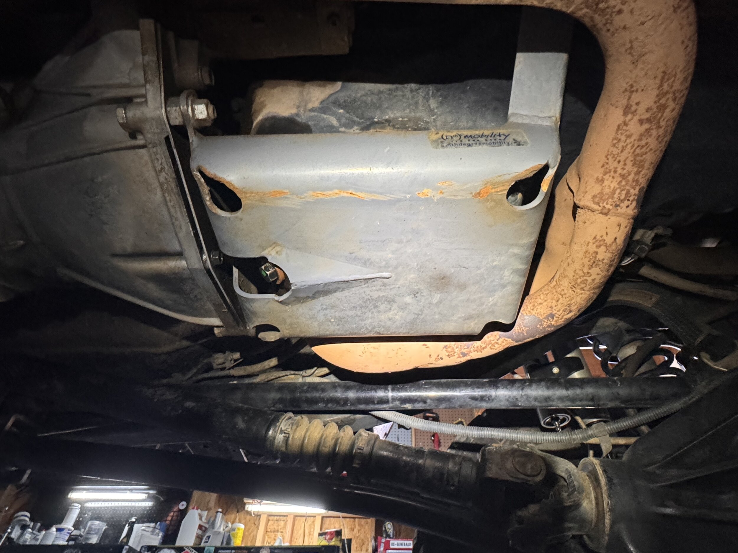

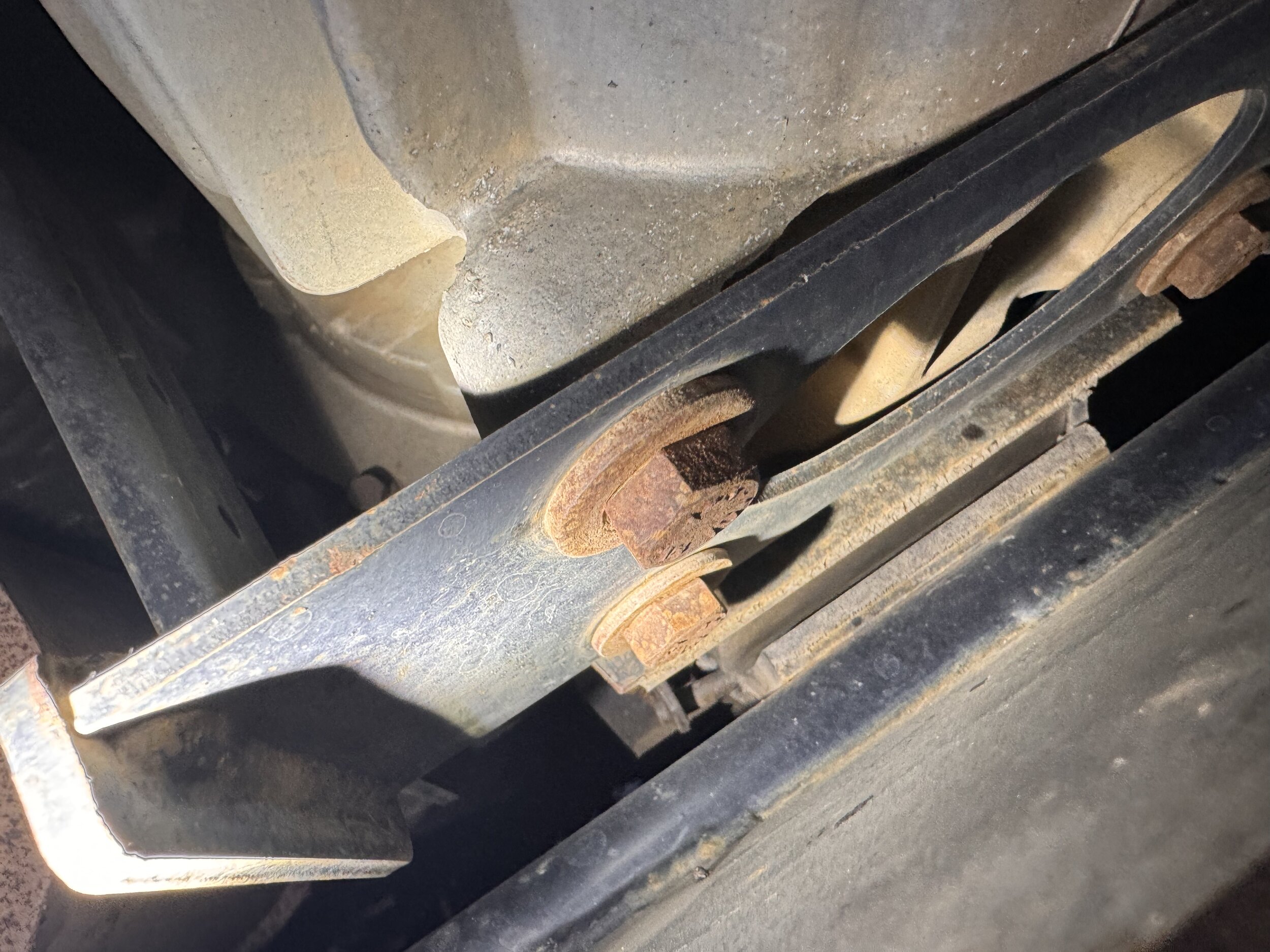

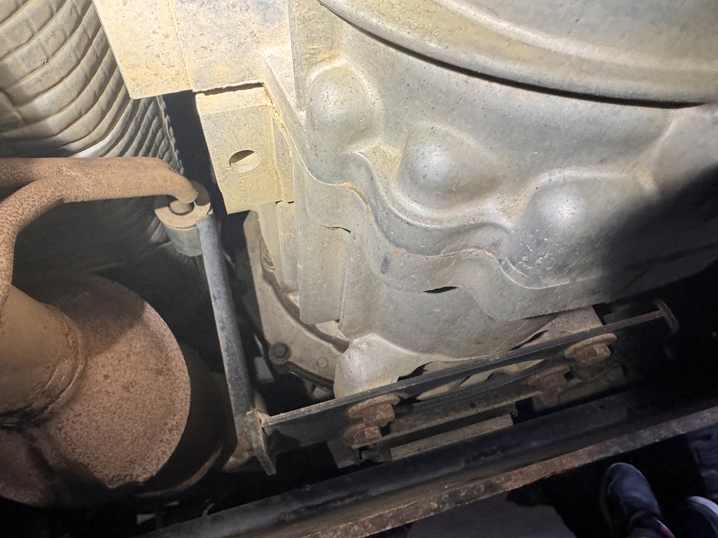

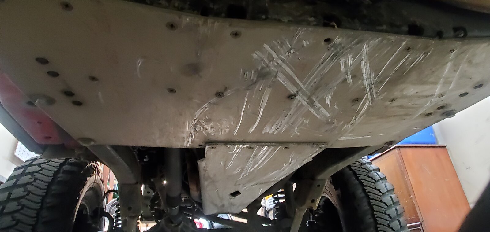

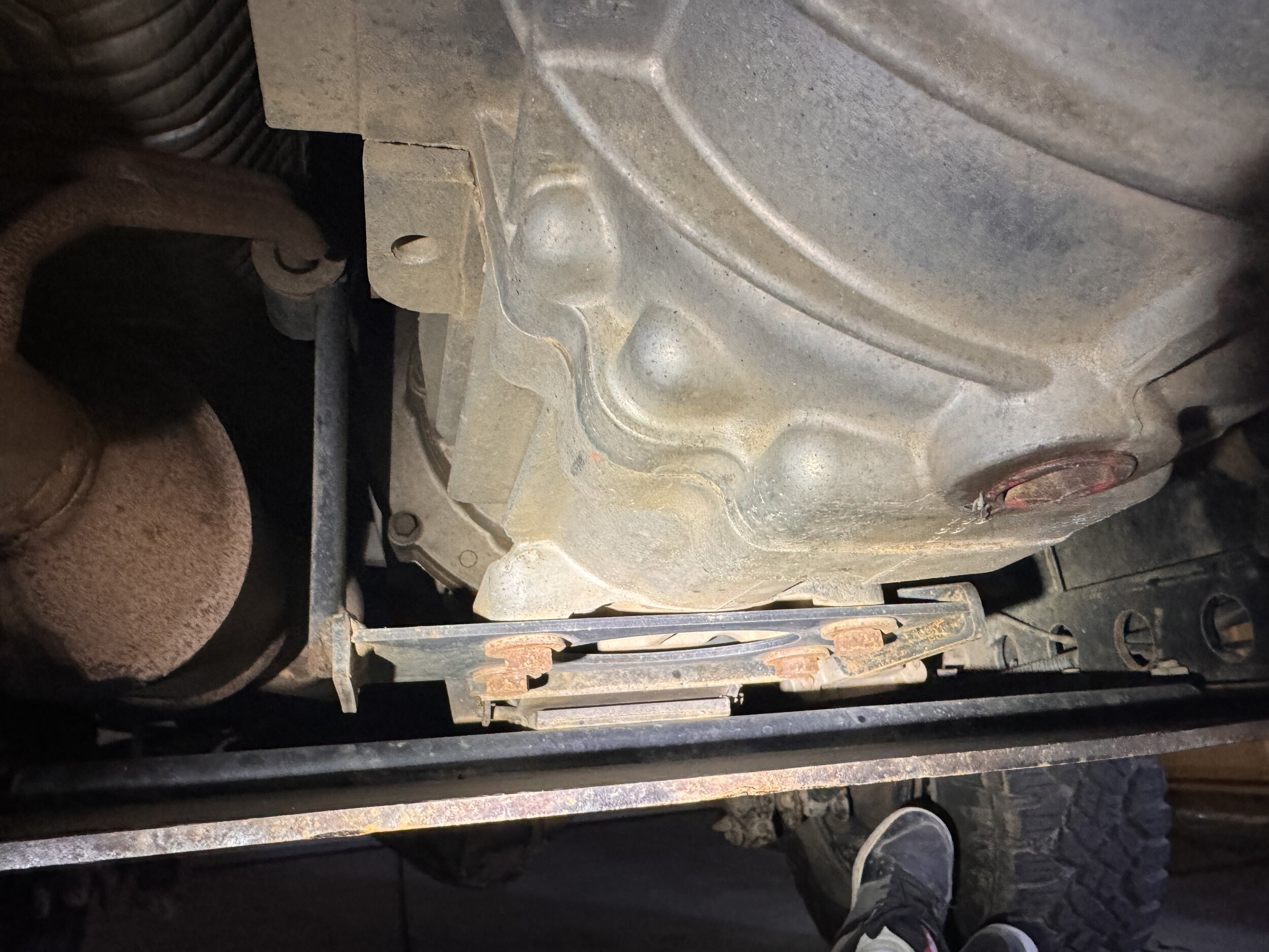

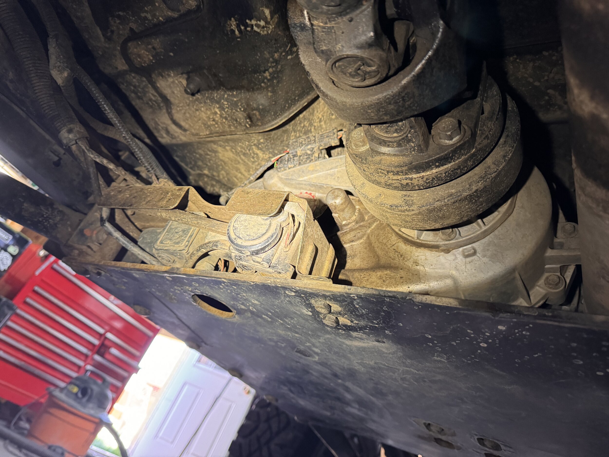

Looking to upgrade armor. Have Nth Degree oil pan armor that’s been hit pretty hard a few times and worked. Looking at UCF engine skid. Been reading conflicting info on aluminum vrs steel. Was planning on thickest aluminum. My TC skid I don’t recognize and can’t find any markings, it’s steel. If I read correctly should just be able to drill it and bolt right on? There’s a spacer/bracket between skid and T-case with an exhaust hanger. Is that standard or is that some type of tuck? I have a long arm lift (I know most aren’t a fan but it’s on), doesn’t look like anything will interfere with engine skid?
Last question, while I was under there I noticed a new oil drip and lots of residue at rear of oil pan. Wasn’t there few weeks ago, is that most likely RMS going out or a different problem?
Looks like the skids did their job, so that is good. Personally I am not in the aluminum camp for skids. It is a soft and easy to be cut / sliced. Worked on semi- trailers for a little over 3 years. Replaced a number of top / bottom rails as they had nice slices in them.
x2 - steel for skids - save weight elsewhere.
That’s my concern. Have read conflicting on aluminum. Want protection on trans, it has a few scrapes, the oil pan skid has paid it’s worth several times

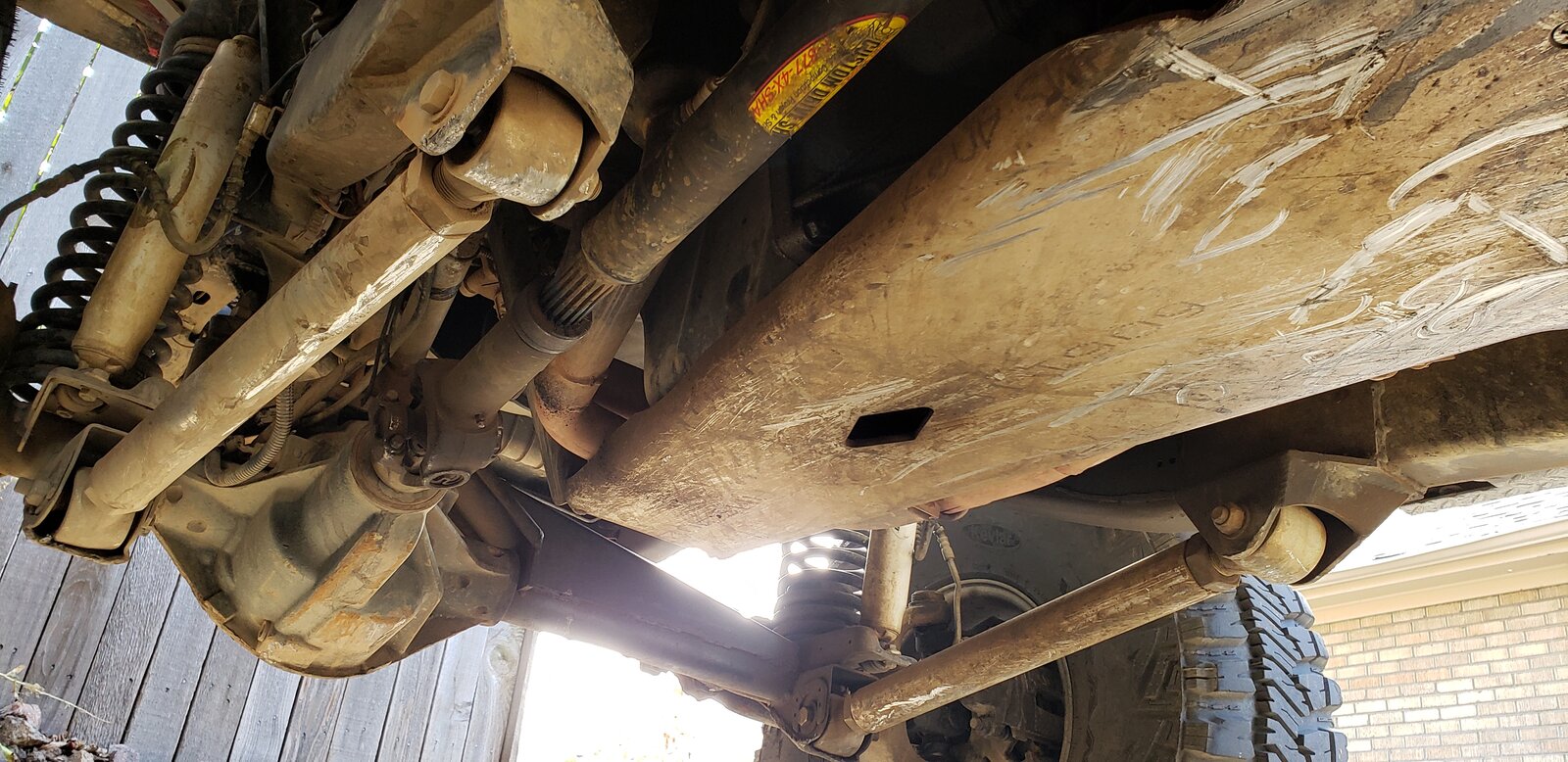

personally, the only places I'd recommend aluminum skids are if you're in a rocky area that's also salty. For example, if your area salts it's roads during winter that you drive on regularly (as in your rig isn't parked inside over winter), but also wheel rough areas. OR if you live on the salty coast, and also wheel. (some area's in Europe are like this and aluminum is a great choice) Otherwise - meh.
BTW, good on you for thinking through what's best. Good luck with the decision.:) (y)

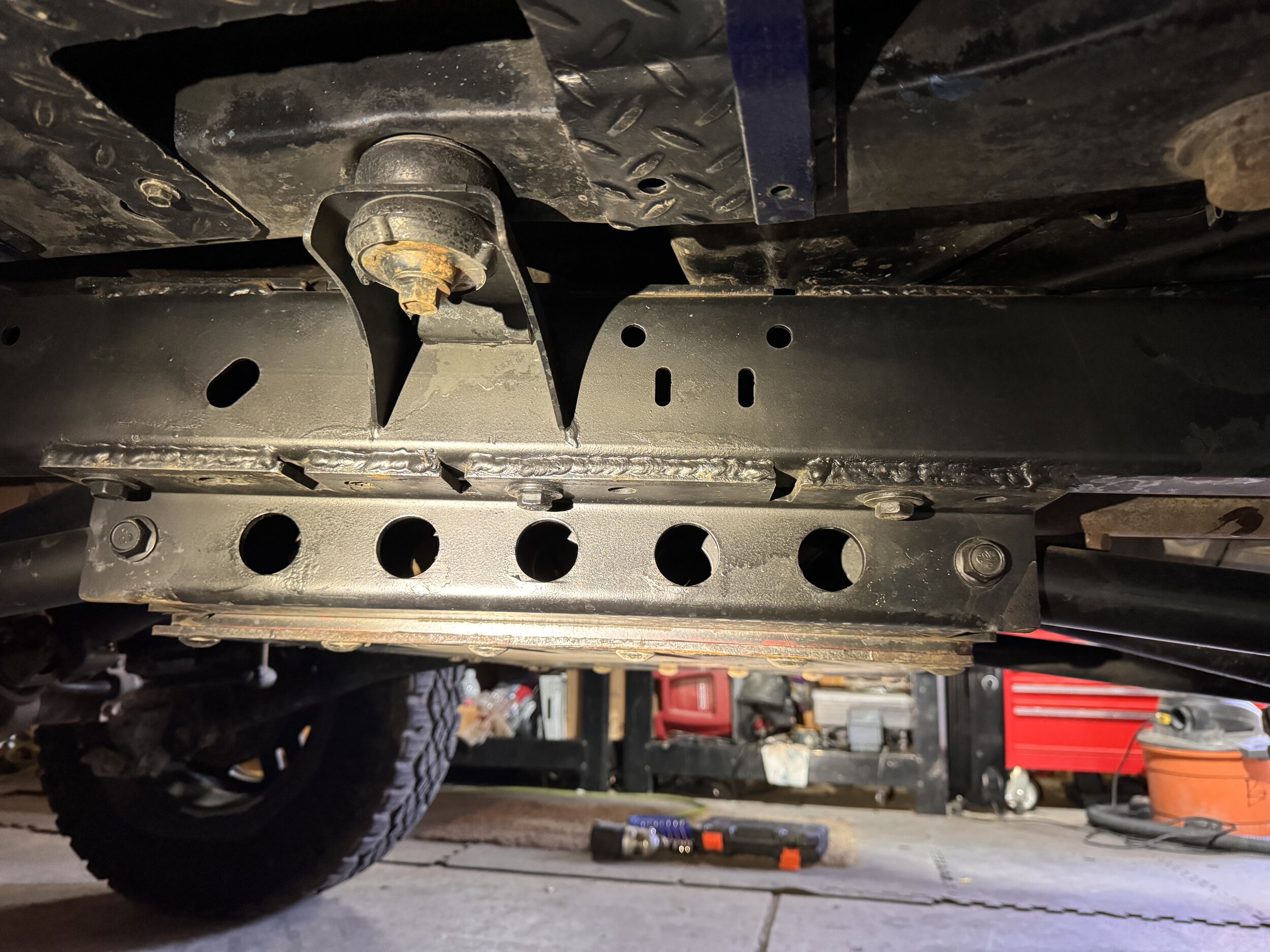

The UCF engine skid attaches to the bottom of the motor mount and that's the worst part of the install in my opinion. I think that would mean it covers more up front than your current skid.
The distance from the front of the skid to the back is roughly 32" and that's the 2002 version. You might want to call them and ask the dimensions for your 2004. I would think they are the same but not sure. That's the only other issue, is it long enough to reach your current skid.
