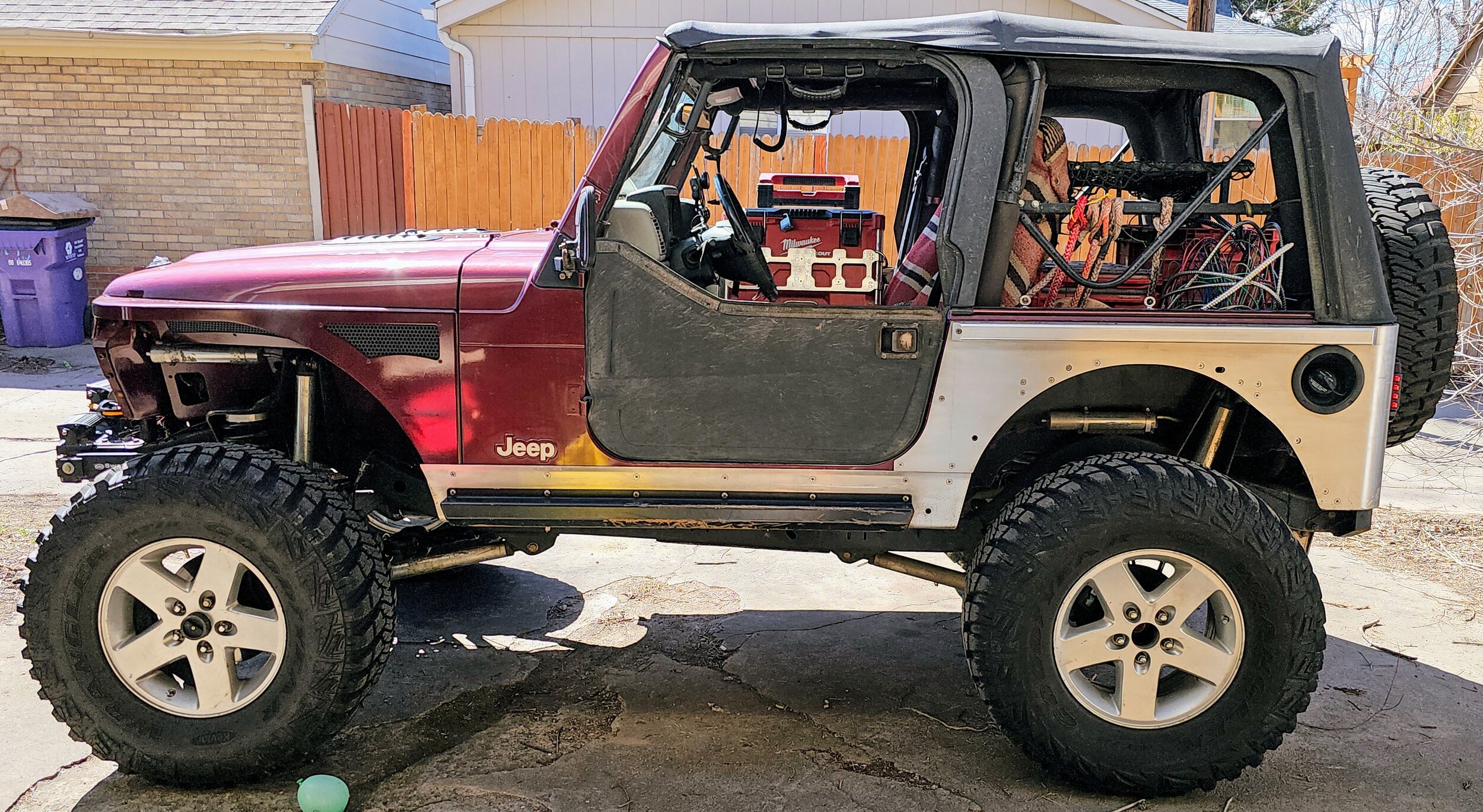

It looks like part of you skid is welded to the frame and it attaches your arms. How will you do a full replacement without replacing the arms?
You could get more belly clearance if you went with a full replacement. UCF isn’t “amazon” fast with their shipping but probably better than savvy.

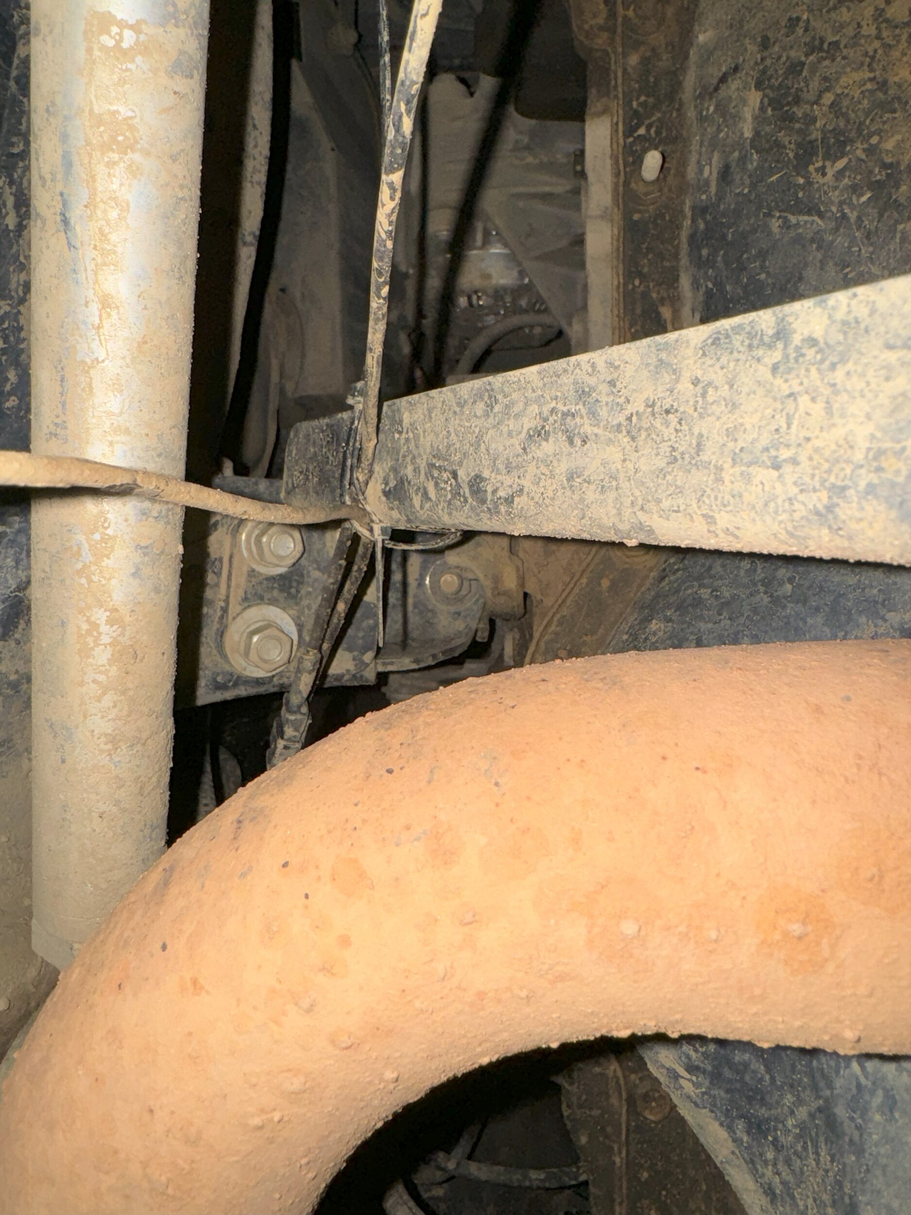

This is a 5/16" 6061 T6 aluminum belly skid that was on my rig and drug over 1000's of rocks in Johnson Valley.
If aluminum is soft per your assertions, then how do you explain the rock scratches that go all the way from front to back without tearing the skid in two?
