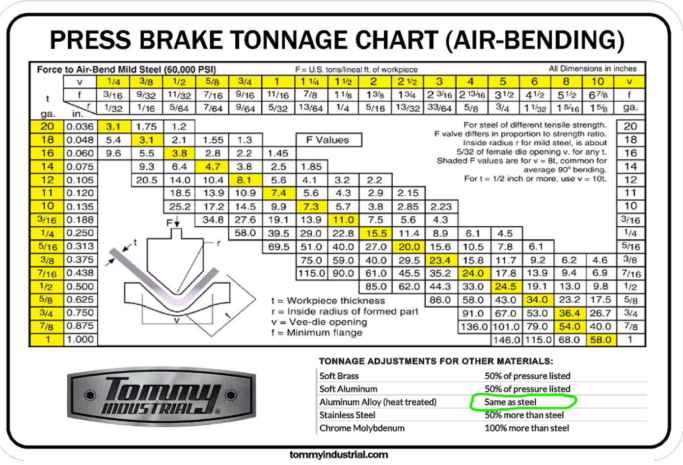

The ucf sight says 3/8 aluminum is comparable with 1/4” steel. It’s the 6061
And that right there is most of the battle. One of two things is true. Either he is not using 6061 T6 or he has not educated himself about the materials he is using. This stuff isn't even that hard to figure out or learn. Here is a press brake tonnage chart. It is used to figure out how much is needed to bend X thickness of a specific material at X length so you know if you have enough ass in your press or need to change something.
Note the area I circled in green please.
Reactions: inkedrose
So if he's using the material he's claiming, it's the same strength as steel. Then why can't a steel design be adapted to aluminum as @jjvw was saying? I know that you know this stuff, I want to understand. With the long arm lift I have is there any reason I can't replace with aluminum or should I be calling manufacturers to ask the question?
The problem is what welding does to the aluminum. You can't take a steel design that derives a lot of its function from welds and directly interchange that with aluminum and get the same results. If the design has to be a certain way AND you have to weld it, then you have to come up with work arounds for the welded areas or they will fail.
It is like the upturned flange on the early Savvy surfboard skid. At the angle change, the two flanges butted up and were welded. I built a plate out of stainless that went on the inside with 4 bolts to prevent the joint from cracking if the skid was flexed. In steel, a simple weld would have been fine.
