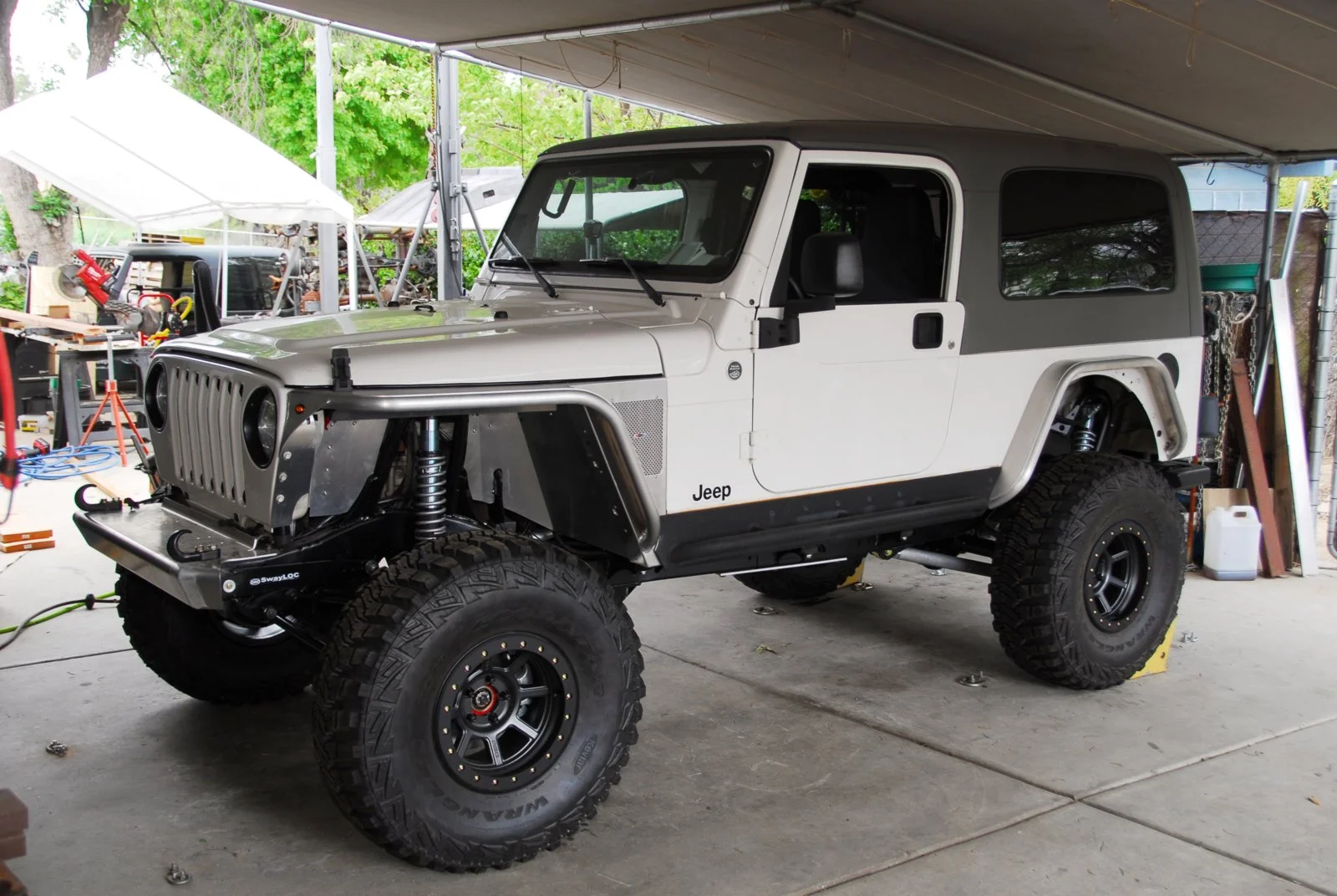

Why coilovers? Are you planning on wider axles to make room for the COs?

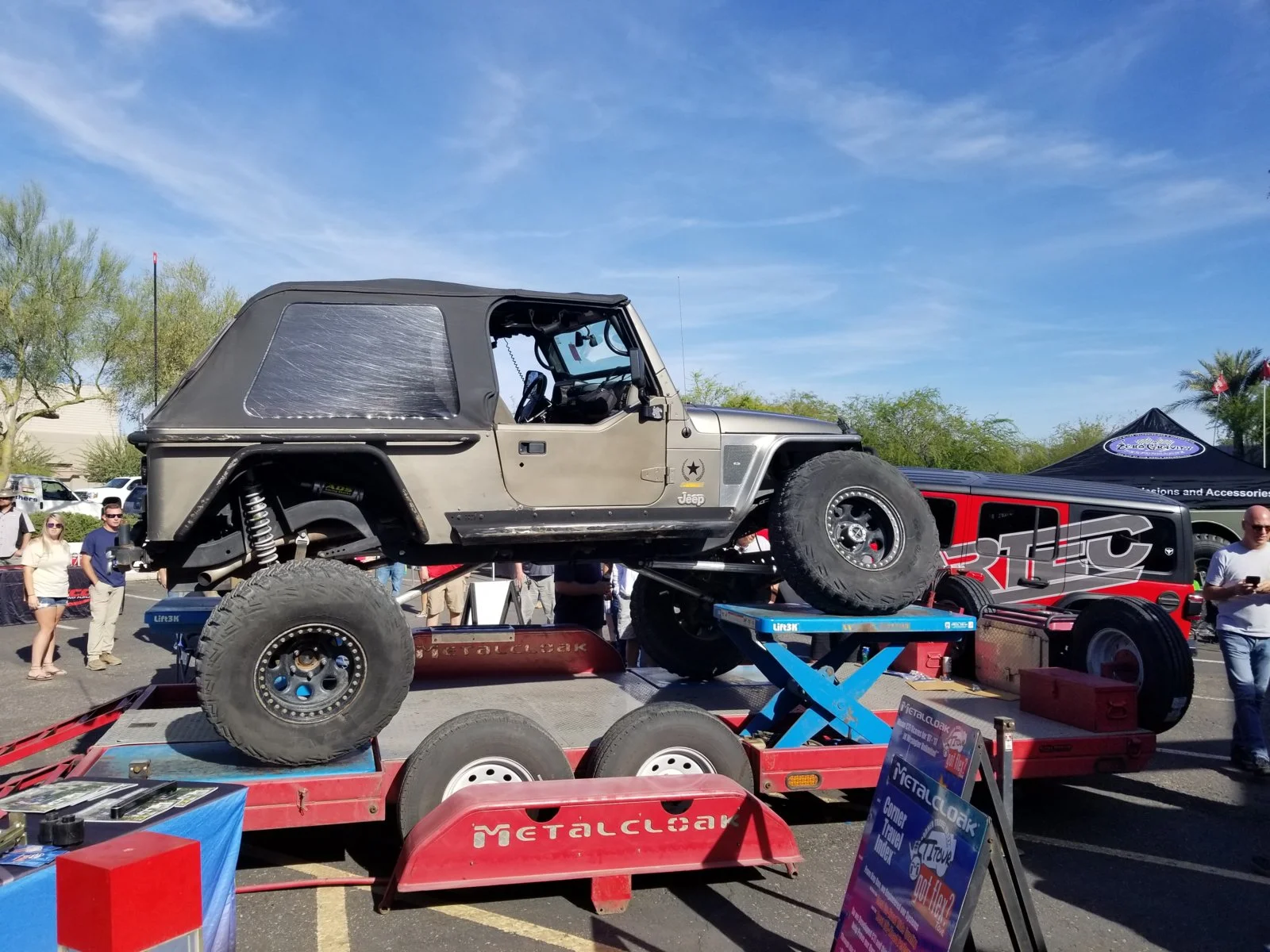

Wider axles aren't required if you don't mind cutting the frame in the back and run the Fox 2.0 at around 12" of travel. We just finished this one up, doing some fine tuning and hopefully you can tell that the 35's are tucked in pretty well with 3.75" of backspacing and no wheel spacers. Stock TJ Dana 44's front and rear with a rear AntiRock, Savvy Mid Arm, Savvy Under Armor, or the basics.

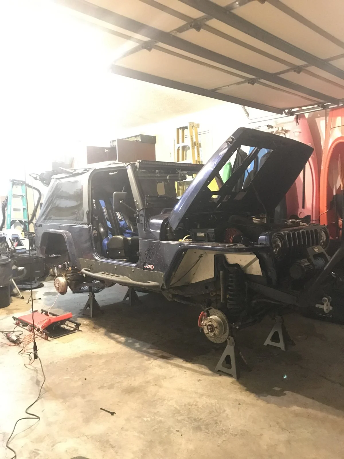

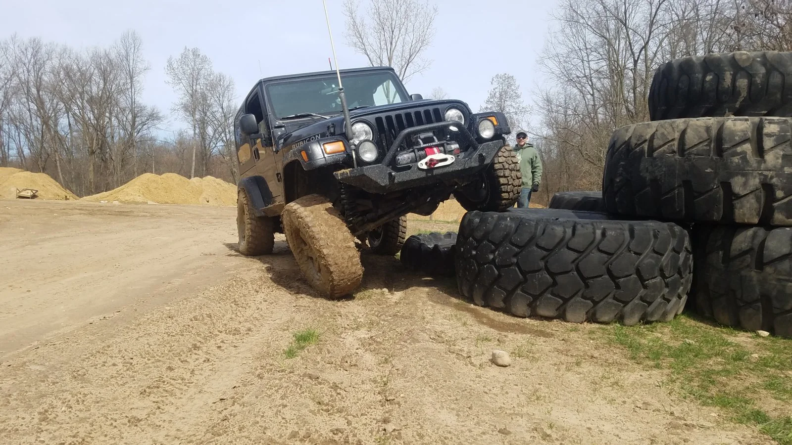

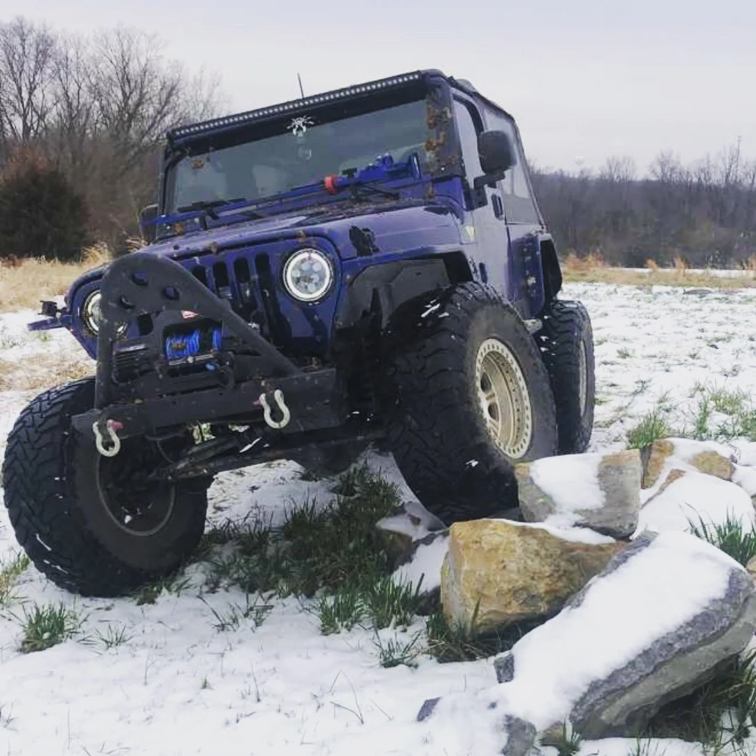

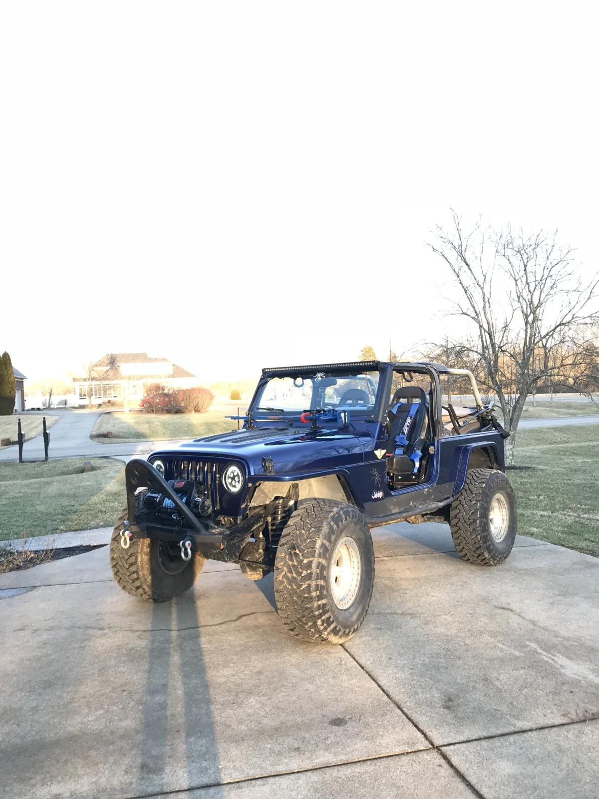

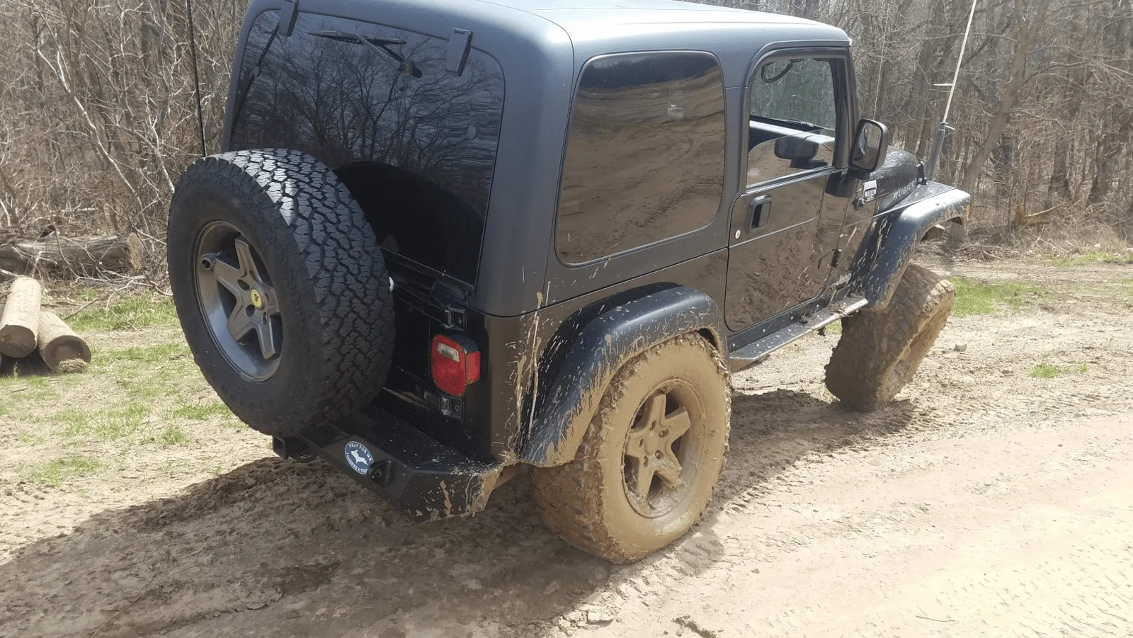

I appreciate all the tips for the rig you guys! I tend be very fiscally responsible and I pride myself being probably one of the few 17 year olds you’ll meet in this generation that doesn’t shy away from rough, hard ass work (KY blood). I’m willing to do whatever to my jeep as i’m pursuing a career in fab, and can’t get enough of the lessons it teaches me about patience especially and just learning how to work on my vehicle. I just want to put myself as far ahead of anyone my age as i can in my career i wish to pursue. I’ve gone to my local jeep shop called V3 jeeps and they are working with me a little bit to see what my overall articulation is. Pics coming soon y’all! (here’s some pics to show you guys the rig) Really glad i finally made an account for these forums you guys are too helpful!

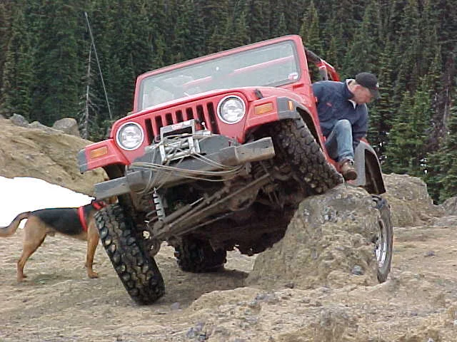

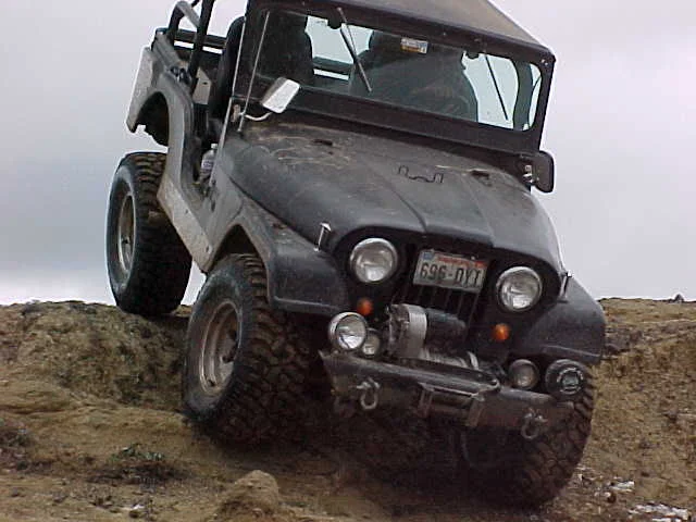

This is what sold me on a TJ and he was a poor college student at the time. He had a budget boost and proper bump stops.
This is what I was driving back then.
