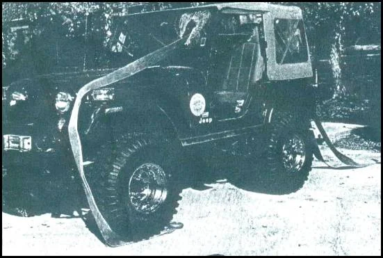

Sounds good but don't use a tow strap for recoveries. Especially when they have steel hooks on the end. Tow straps don't stretch any at all which makes it easy to break things when you need to provide a little extra oomph during a recovery. And when something breaks, you don't want steel hooks on the end of that strap.
This is what happened while using a tow strap with steel hooks on the end during a recovery...
Leave the tow strap for towing vehicles and replace it with a recovery strap aka snatch strap which is what you want for offroad recovery use. They are built to have a bit of 'give' plus they have sewn loops so things don't get broken or people don't get hurt during a tough recovery.
