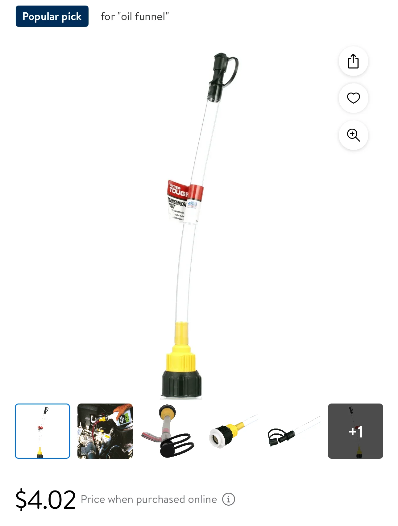

I didn’t like the pumps. I use the following from Walmart. Cut the hose shorter if needed but get it to where you can have your fluid bottle upside down and let it drain in while you do something else.
I use a 5 gallon bucket with a steel hand pump and casters for whatever takes plain ol 75w-90. Small bottle pump for everything else. I'm ordering @Apparition 's tube thingy right now!
One issue I ran into is it works on the Currie bottles but didn’t work on the Torco bottles IIRC, supposed to be the same stuff.
It’s a handy cheap option that can be used in a lot of ways, fits several bottle types. You can squeeze the fluid out of the bottle or if needed pop a hole into the bottle to take air bubbles out of the equation.
Could replace the hose with a really long one and hang the bottle somewhere not under the jeep too.
