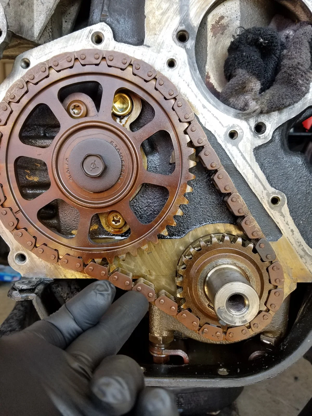

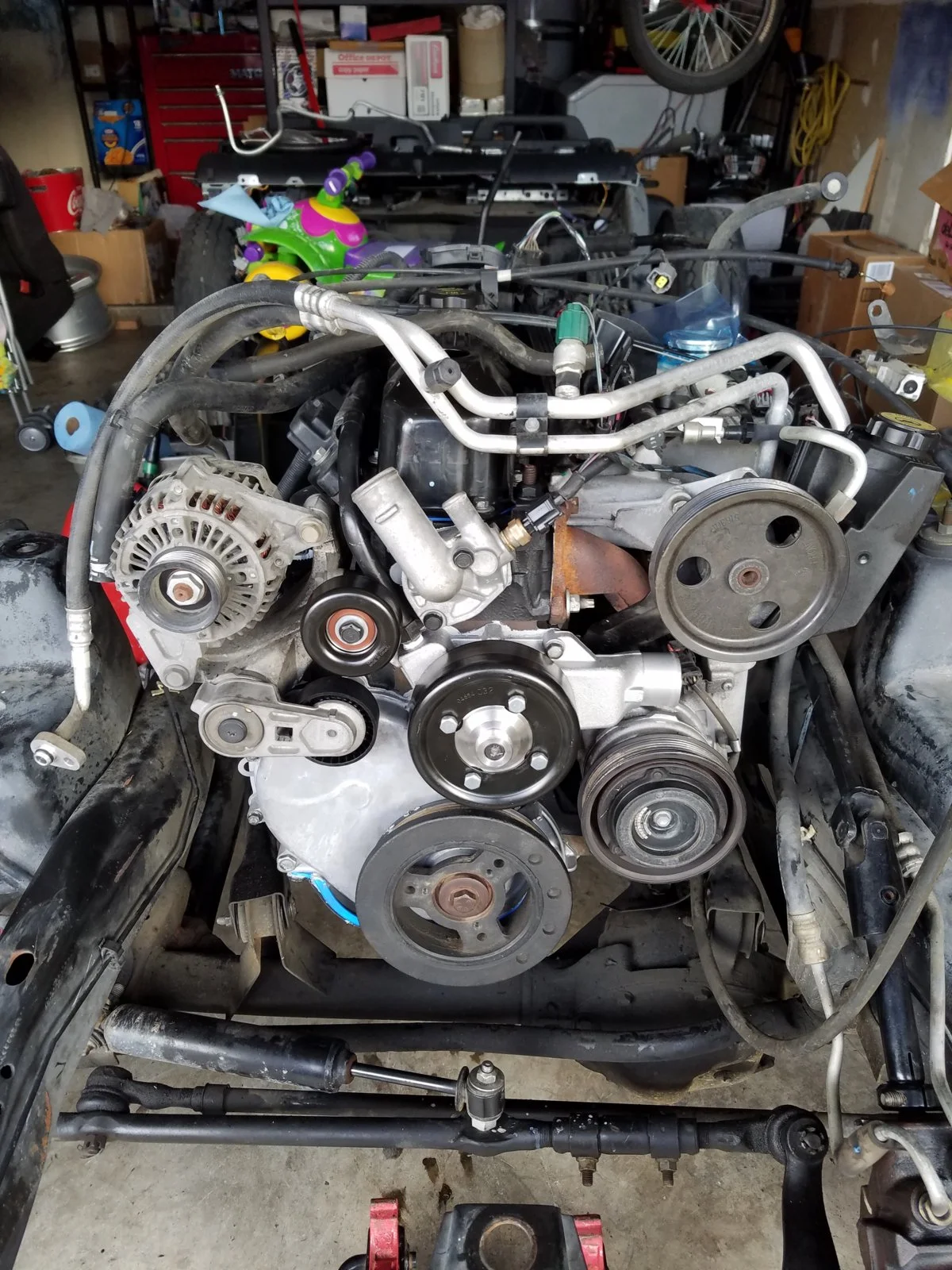

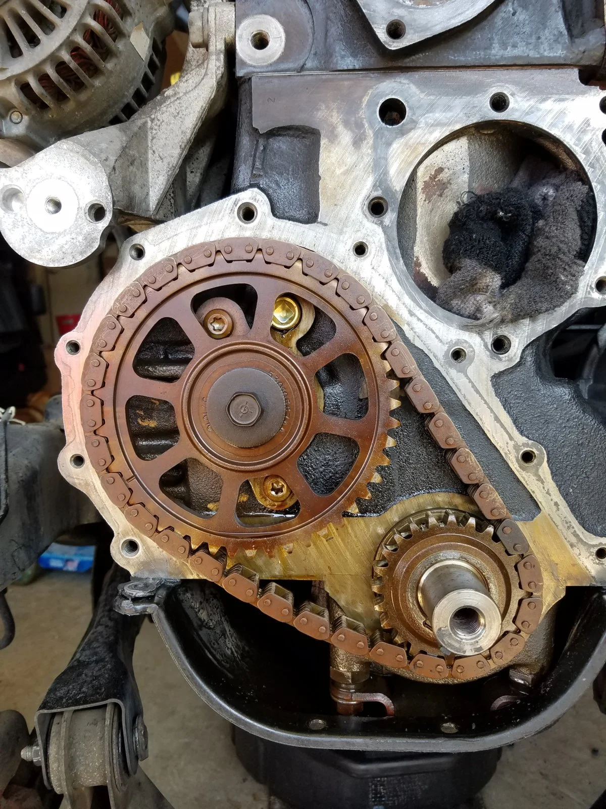

I did mine when I 1st got the jeep just because I was replacing all gaskets hoses etc. My Chain was slightly stretched @ 136k. It was not enough to be worrying about it for another 50k, but I was already there so I put a new chain. In the pics, if you look at the engine behind the chain, you can see just how much it stretched. The new chain had almost zero play.
