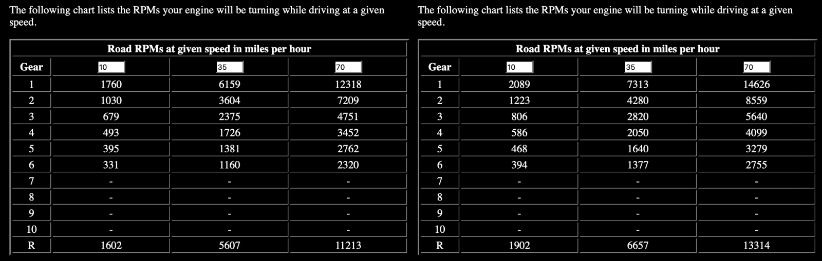

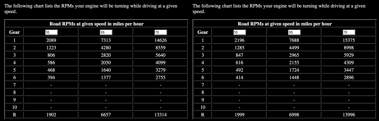

Engine doesn't matter, which is why it's not an option on GrimmJeeper Gear Ratio Calculator. All that matters is your transmission, tire size, and gear ratio. Based on the NSG-370 and 35's figured in below, I'd go with 4.88 but wouldn't mind 5.13 either.
Here's the chart with 4.11 vs 4.88 (see rpm's at 70mph)
Here's the chart with 4.88 vs 5.13 (see rpm's at 70mph)
Engine absolutely matters. As was stated above, it is all about where the engine makes power, and what is the best rpm operating range. My guess is that the power curve on that diesel is very different than the 4.0 - starts at a lower rpm, and ends at a lower rpm.
Why does Grimm Jeeper not bring engine into the equation? They certainly aren't set up just to deal with the 4.0. It's for all engines.

I agree that the engine makes power at different rpm's, so, how would the OP find out where that power band is on his Cummins 2.8? We 4.0 guys like 2700-2800rpm's+
The 2.8 might not be able to even get to those RPMs. As I stated above, many diesel engines are fuel-limited below 3000 RPM (rev limiter for gas engine). So if he gears 5.13 and needs to spin 2800 RPM+ to achieve 65 mph, well his 2.8 just can't do it. That's why the engine and related specs matter. Grimm Jeeper is just a calculator. That's why it even calculates 1st gear at 70 mph (4.88 = 14626 rpm)
See post #21.
@Wildman mentions finding a dyno curve for the 2.8L. That will tell you everything you need to know.
