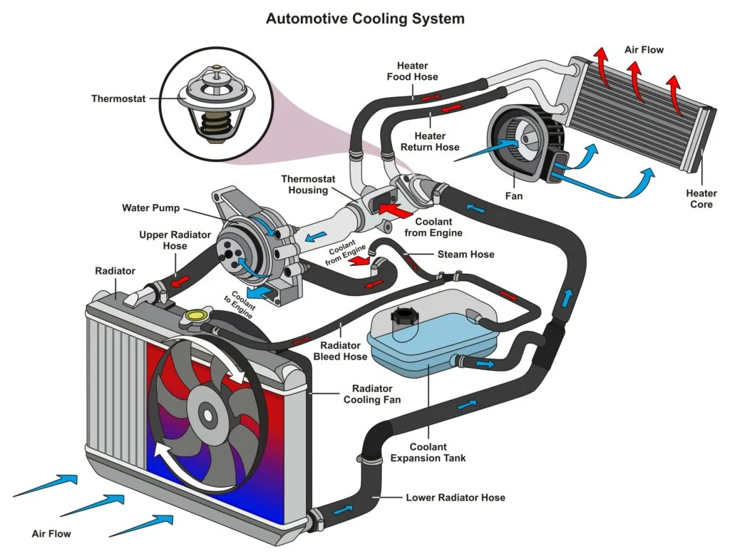

This is a typical automotive coolant system with the heater core in the upper right. There are generally 2 typical issues with our wrangler heater cores, the most common is a plugged core that either restricts or stops proper flow thru the coil and a failing coil that commonly presents itself with a sweet coolant smell in the cab along with a coolant drip from the AC drain on the firewall near the battery. If it's performing well then just salute and keep going. System performance is greatly enhanced by a well maintained cooling system and most issues/failures can be attributed to a lack of maintenance other than wear items such as the water pump and T stat.
