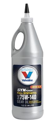

The factory calls for 75w-140 synthetic.
I've been running Valvoline Synpower 75w-140 for ten years.
And that's fine for a factory axle running the factory installed gears. It's when new aftermarket gears have been installed that need to be broken in when it's best you don't run a synthetic gear lube. Or when you're running aftermarket axles like from Currie where their warranty requires the use of a non-synthetic gear lube. Why? It was surprisingly found during difficult tests that the gears run cooler when lubed with a conventional than with a synthetic which was found to hold the heat in the gears. Why were the tests conducted? They were having higher than expected aftermarket R&P (factory gears are pre-lapped before installing) gear failures and it was finally tracked down to the increasing use of synthetic gear lubes. True.
