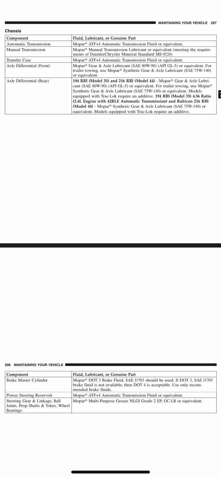

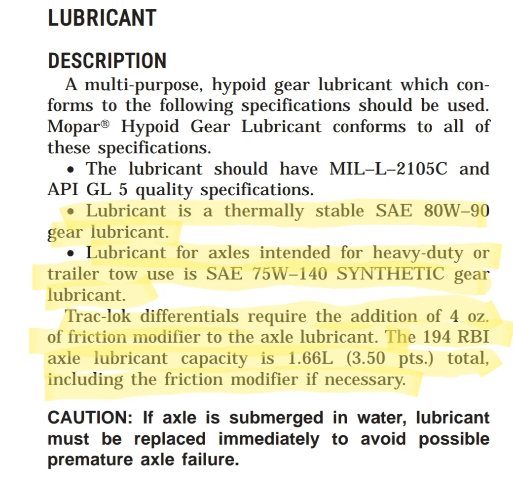

Going to do a differential axel change. Manual says Gear Oil 80W90 for front but the rear diff has different types. I have a 2000 wrangler TJ manual 2.5L no AC. It’s an SE believe. What should I put in it. Also the capacity is 5 quarts , correct?

Waste of $$$ for Lucas, it's nothing special. Personally I'd run nothing but a conventional gear lube in my axles, it's proven to help the gears run cooler than they would with a synthetic gear lube. Castrol, Mobil, Valvoline, Torco, NAPA, etc. are all fine choices.
And the exact viscosity is absolutely not critical. A 75W-90 or 80W-90 is fine for most uses. I'd only go to a higher viscosity like 85W-120 etc. if I was doing a lot of trailer towing or wheeling on extreme trails.
