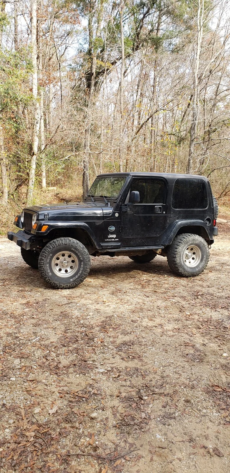

You don’t need more than 33’s to be able to go off-road and have fun. 33’s are very capable, especially with a front lunchbox locker. You do need different gears. To determine the best ratio we need to know your engine, transmission, and final tire size. Post those. Also, I’d add a 1.25” body lift to the 3” lift for 33’s. Gives the tire more room, you can lose some bumpstop, et al. Let’s see a pic of your Jeep!

Be aware that many of the ratios being mentioned/recommended above are from those who own different transmissions which changes the ratio that works well. Your 4-speed 42RLE automatic transmission has a unique trait, an extra-steep .69 Overdrive ratio that drops the rpms so much that you need axle gears that are geared low enough to get the engine rpms back up into the normal power zone. That's why I recommended 5.13, don't go with 4.56 or 4.88... you'd hate the results.
There she is! Nice rig. With your 42rle and limited by the Dana 30 up front, I'd go with 513 as @Jerry Bransford mentioned. My sons have the 42rle in their 2004 TJ and they run 33's and 373 gears (they're poor). The moment they get in the rig they turn the O/D off. I was riding with one of them today and when we hit a hill he shifted the auto into 2nd to get some rpm's back. I'm sure when they regear they'll go to 513.
