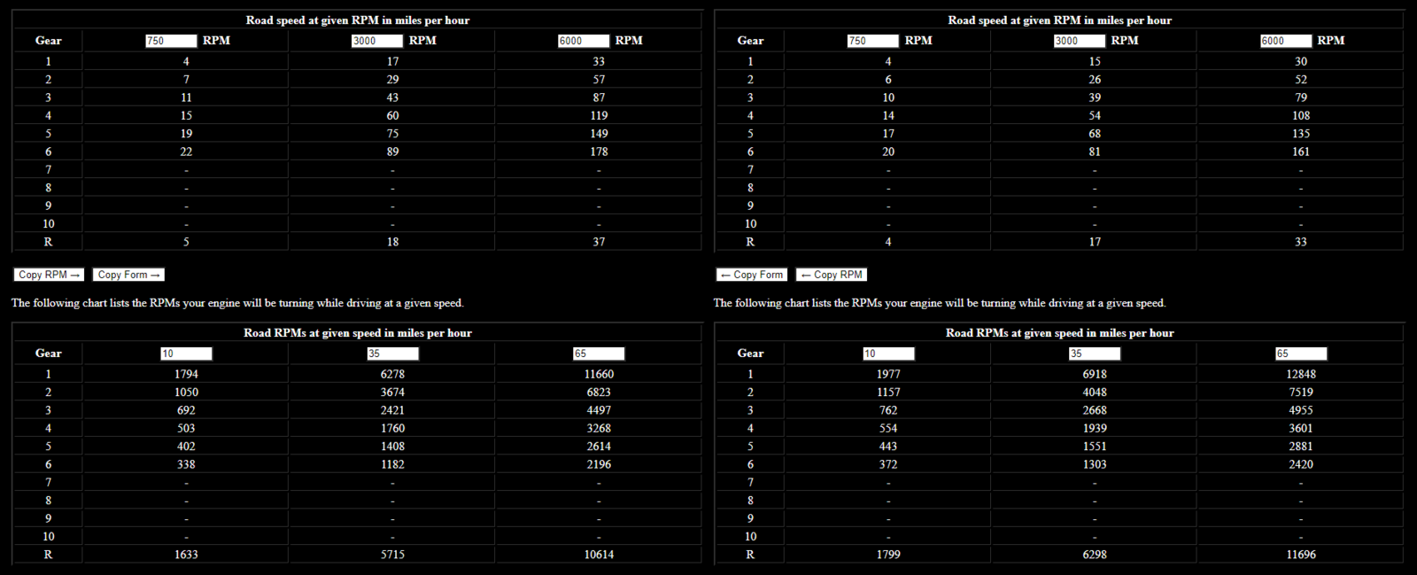

Having read a lot here the recommendation seems to be 3k RPM @75 MPH. A lot of the info for gearing manuals is regarding the 5 speed. My TJ has a .84 overdrive NSG370 close ratio 6 SPEED, 4.0 and 33" tires. So are the recommended gear/rpm combinations in gear 5 @ 1:1, or Gear #6 @.84:1? Currently running a 3.07. One formula 33/30*3.07 = 3.37. So if factory was 30inch tires and I went to 33, that is 110% larger so 3.37 would be the actual ratio required to restore the rpm/gear to factory design? That does not seem right. I must be missing something.
Trying to decide on using 4:10 (LEFT) or 4:56 (RIGHT) I used 33" for my tire size in reaper, which I am now aware might actually be slightly smaller.
I don't crawl. Looking for best drivability and economy IE: A daily driver. Thanks for any and all advice!
If 33’s are your final tire size, 456 with the NSG-370. Your calculations are pretty correct, but that’s not the entire issue. You’ll be deeper geared than from factory, but I guarantee you’ll be happy.

4th gear on 3.07s is almost exactly equivalent to 6th gear on 4.56s. So if driving around and on the freeway and 4th gear seems like a decent gear to use in the highway, 4.56 gears will work very well.

I understand that using 4.56, 2970 rpm@75mph is considered "perfect" but I think its too much considering 75 is speed limit on many roads now. The 4.10 will give me 2670 (300 less) at the same speed and will make 1st gear more usable. Matter of fact the 6spd/4.10 would be geared exactly the same as the 5 sp/4.56 for the first 2 gears. In top gear the 6 sp/4.56 will rev 200 higher than 5sp/4.56 @75mph and 300 higher than the 6spd/4.10. It seems like the only thing to give up is 300 rpm @75mph. I really don't understand why the 5 speed recommended is 4.56 and the lowered geared 6 speed is the same recommendation.

What tire size are we dealing with? I am not aware of a scenario where both the 5 and the 6 speed get the same recommendation. The 6 speed is typically one gear numerically higher because of the OD gear.
I have 33" tires.
I just notice the chart at the top of this thread shows 5spd/4.88 for 33". I have seen the 5spd/4.56 far more commonly recommended for 33 in other places, including this forum: https://wranglertjforum.com/threads/gear-ratios-for-33-tires.34508/
It is for this reason I think many suggest 4.56 for 6 speed as well.
I have also read a few who say 5spd/4.88 with 33 is to much rpm on highway. I think 6spd/4.10 is a closer match to the 5spd/4.56 setup that seems ideal.

For many years, the internet wisdom (which includes a few long timers from here) did not understand that the TJ wasn't necessarily geared well from the factory, that different transmissions required different gearing, or that there are certain common tire/trans combinations that simply can't be geared low enough. Add that to a persistent false belief that 4.88 is as low as one should go, which created the flawed logic that subsequently smaller tires needed subsequently higher gears, and you have a mess of bad recommendations floating in the ether that will never go away.
