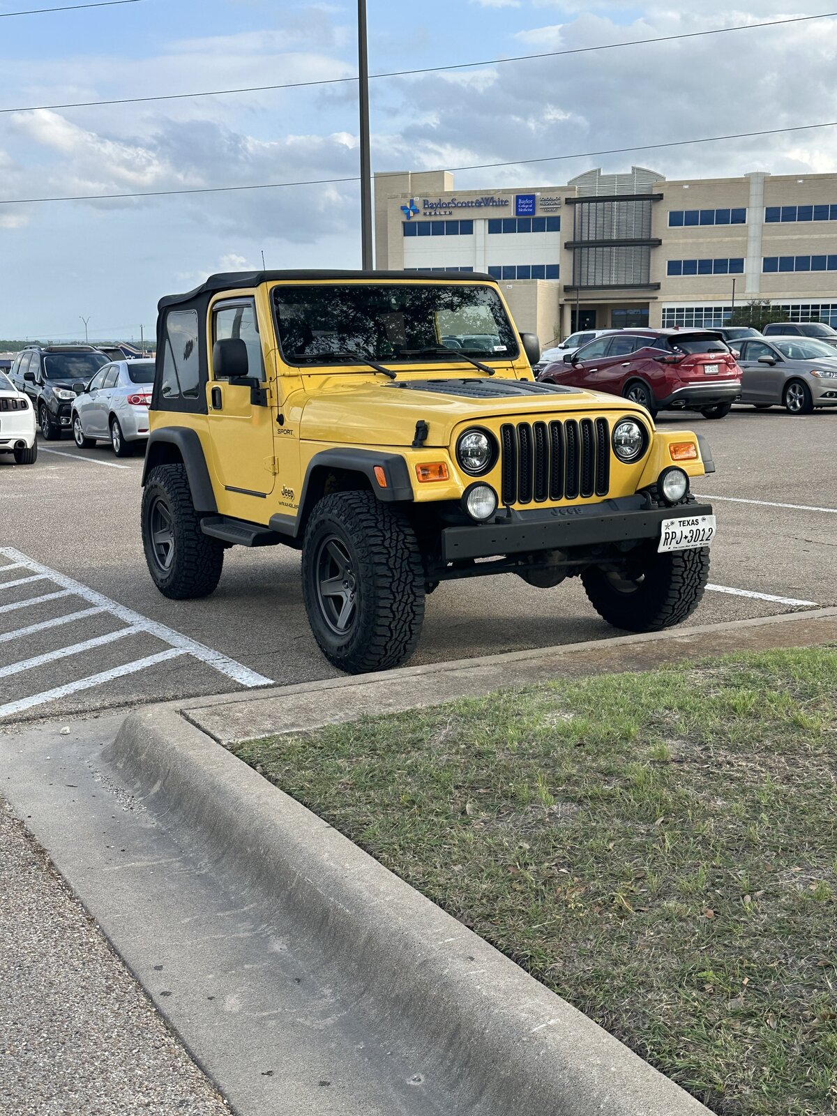

I’m just curious how accurate the Grimmjeeper calculator is… I put all the info in and it’s saying that I have 4.11 gears in my 2003 jeep sport. Pretty sure that’s a gear swap for a nonrubi? Anyone have input?

Ok. I was thinking about a regear. Will do this method and see. Assuming some chalk on the ds and lift the rear out of gear and spin?
For what it’s worth I have 265/75/16 on a 2003 5spd 4.0 and run 2500 at 75 mph in 5th. The math seems like 4.11
That would do the trick.
Math is probably right but it's best to confirm.
That size tire typically measures right at 30.75”. 2500 at a true 75 mph would be 2400 with 3.73 and 2600 at 75.
Are you basing 75 off of GPS or the dash? There is a chance you’re actually going faster than 75 on the dash which would mean rpm is lower than 2500 at 70 which would line up with 3.73.
It was right at 15.5 radius. The speedo gear has not been changed I have to check and see if I’m off. Obviously.
