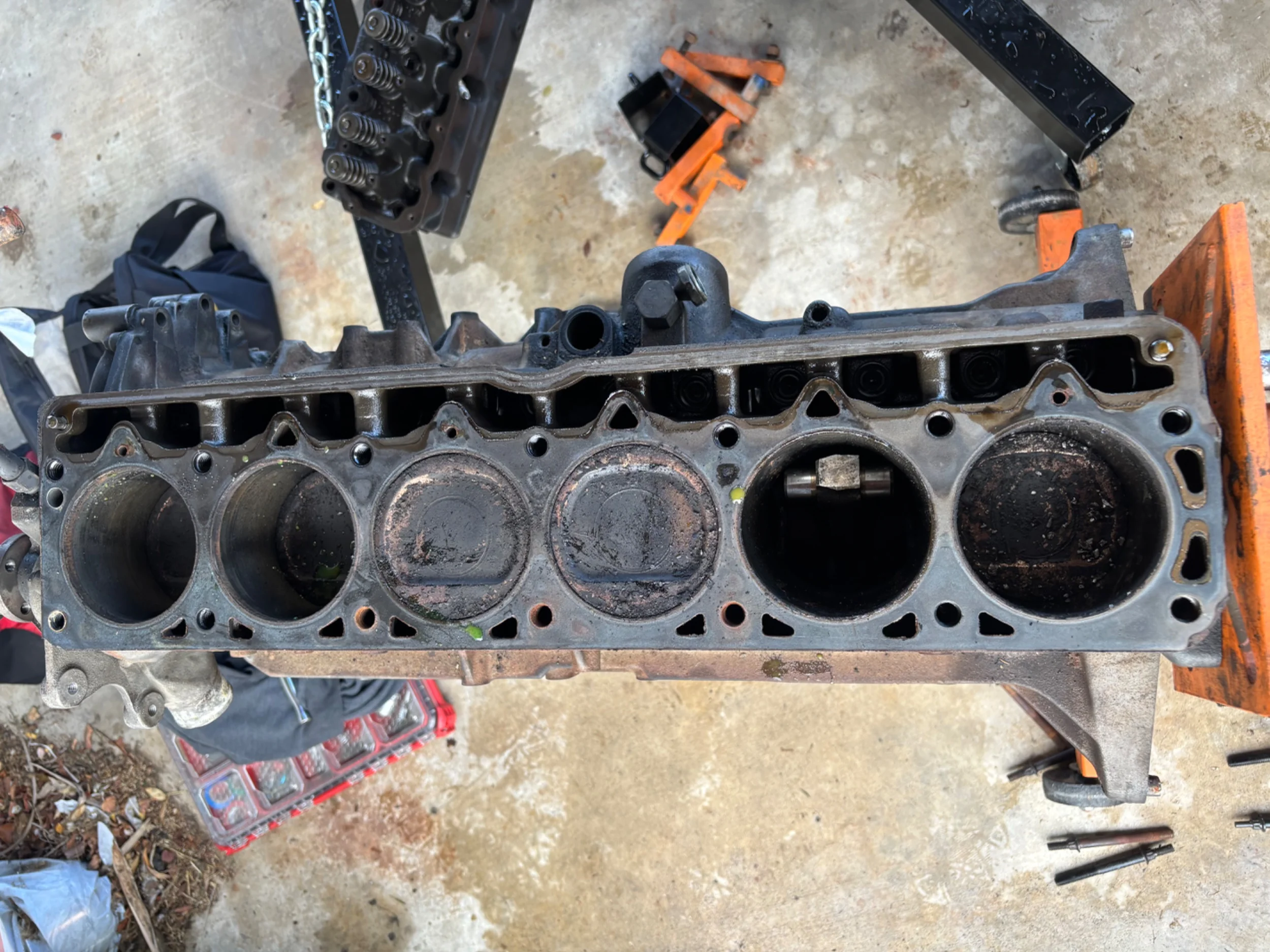

From what I've seen and watched online, the 4.0L lives forever but can sometimes succumb to piston problems (post 1996 I believe?). Usually cracking off due to aluminum pistons in an iron block and long years of heat cycles. Have also heard about lifter issues eating cams but that seems 1 in a million.

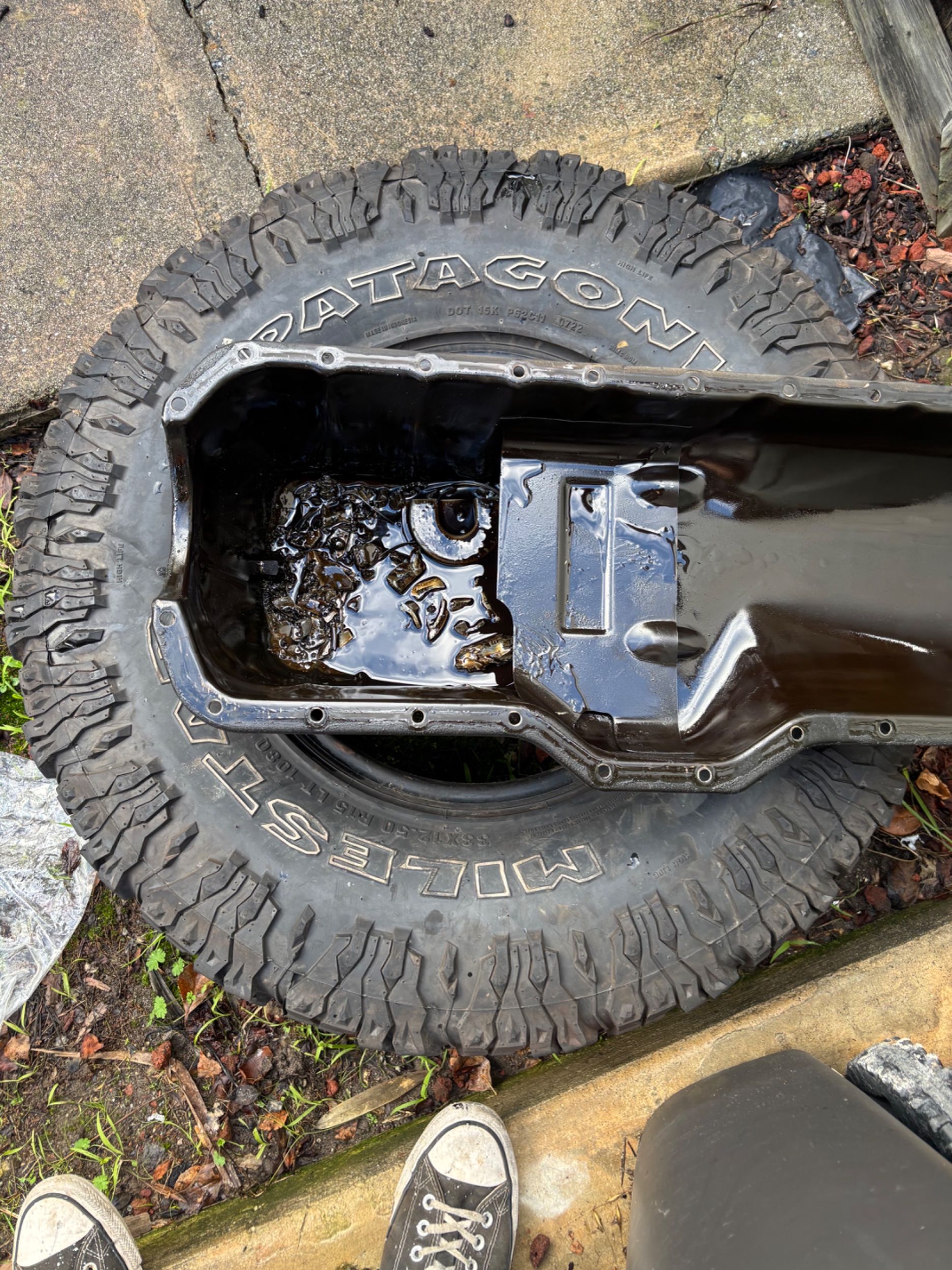

IE what went out on my last 4.0L
Rolling in new bearings is cheap, easy and fast
Piston slap sometimes gets folks
