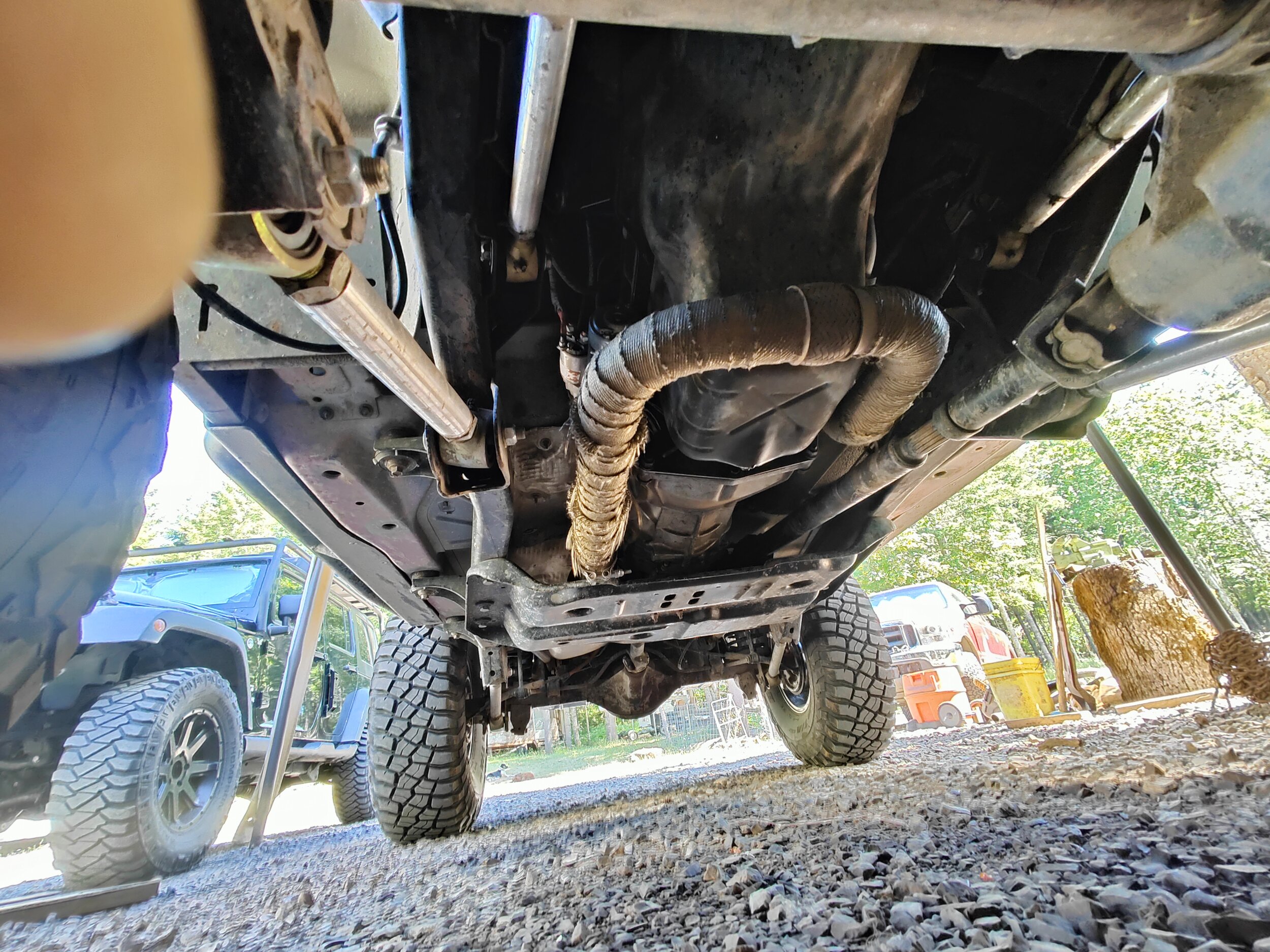

DEI Boom Mat...they also make a transmission tunnel head shield. I put some under my original TJ tub. On round 2 I wrapped the exhaust from the header to the cat in exhaust wrap. Found that to be far more effective.

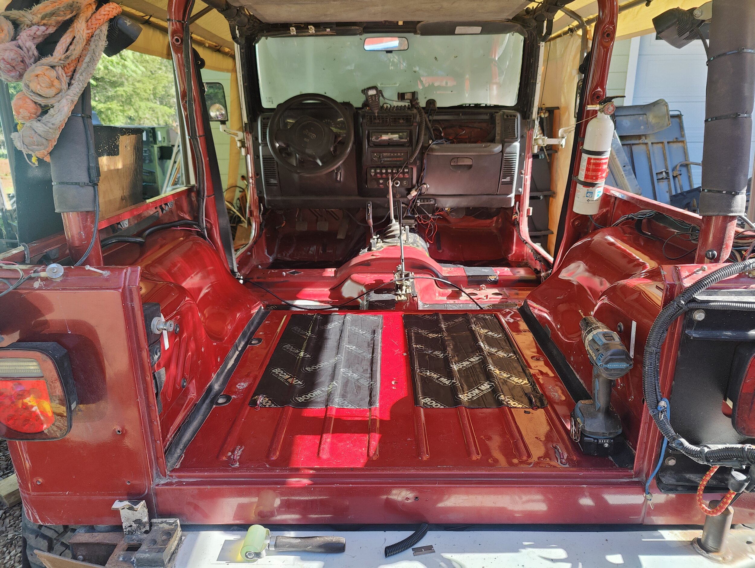

In a month or so I am going to use Noico front to back and then new carpet. The factory placement of the 3rd cat on my 06 LJ is dumb. Way too close to the tranny. I found a small Magnaflow cat that I will place as close to the muffler as possible. This will get that heat further back. Also if you go under your Jeep you will see the factory aluminum heat shields. I am going to grab some of that stuff and cut it to make additional heat shielding.

Bedrug doesn't offer mass backing. The company makes Bedtread which is a rubberized floor covering. I have it in the back of my Jeep but it doesn't offer any more insulation than the Bedrug. ACC offers a carpet with mass backing that has good reviews. It weighs significantly more, if that is any concern. I went with the Bedrug specifically to try and save weight. If that wasn't a concern I'd probably go with the ACC. The Bedrug is nice but moves around unless held in with velcro. I also have it in the back of my truck and it's claims of stain and fade resistance are not accurate. I think for interior carpet it is good and I have been happy with it. It is very light and easy to remove and clean.
When installed the CSI in the front I used most of the 4 x 6 roll as there was some waste when cutting it.

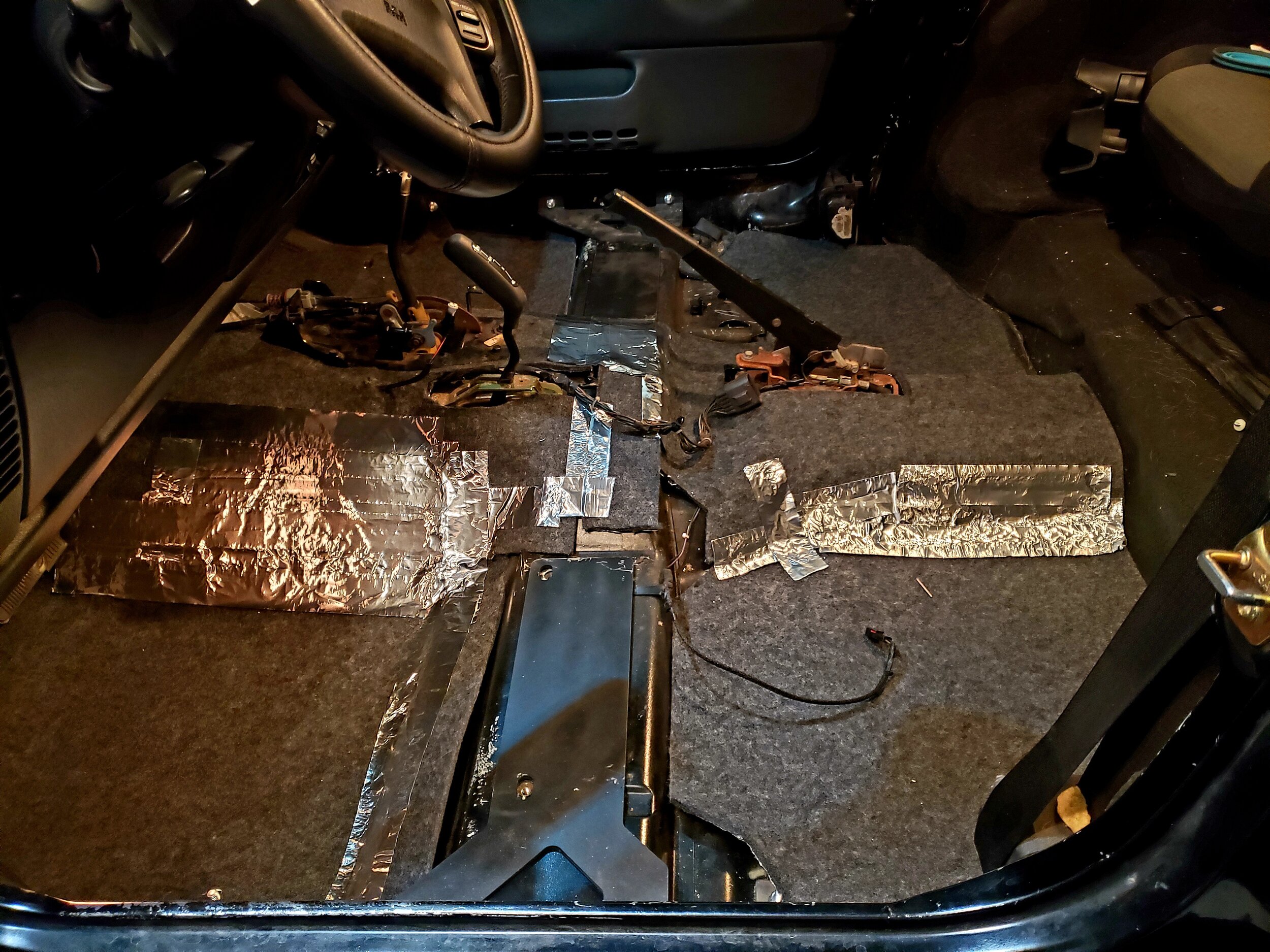

Just this stick to the floor or lie loose?
I've always worried about water getting under the products that are stuck/taped down and causing rust.
I just layed it down loose. I did spend a good amount of time fitting it so it doesn't move around. If needed I can remove it relatively easily as it is just held together by foil tape. My Jeep hasn't seen rain or water since before 2017 so it wasn't a huge concern for me. I do imagine it would absorb water if it got wet so it might not be a great choice for Jeeps that are frequently open to the elements. It does have a foil backing which should help keep the floorboards dry should it get wet.
