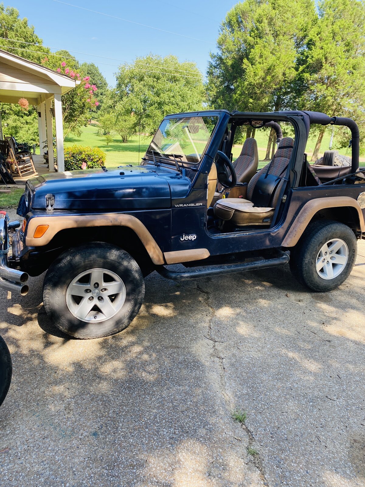

I just got a 1997 automatic 4 banger. It has 16 rims on it. Currently 245/70/16
I’m a realist and realize I’ll never get a speeding ticket but what is the best size 16 for a recreational Jeep.

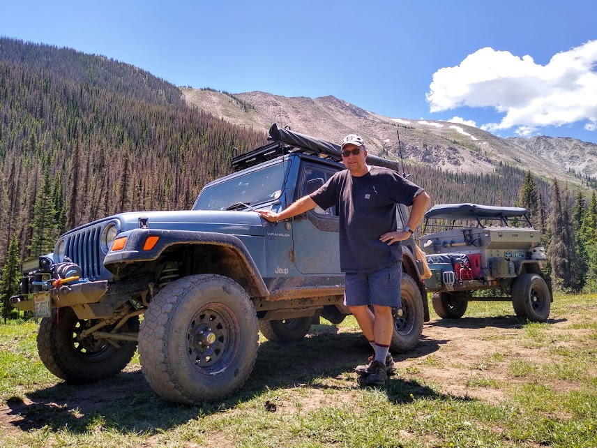

I've got a 98 TJ with the 2.5/five-speed. 3.5" RE lift, swapped-in Dana 44 rear. 285/75/16" (33") tires.
I think 285/75/16" tires are a perfect size for a four-cylinder TJ. Not too tall and not too wide.
You want to regear it to at least 4.88 gears. That's what I did (back in 2008), and it gets you back to the factory powerband so not only can you use 5th gear again, it helps you out starting out in first gear. 4.56 ain't going to do it for 33" tires. Don't be afraid to go low if going with 33" tires.
If I had to do it over again (I don't remember if it was an option at the time), I'd strongly consider 5.13 gears. I pull a little trailer sometimes, and that extra low gearing would come in handy when taking off from a stop with the trailer.
