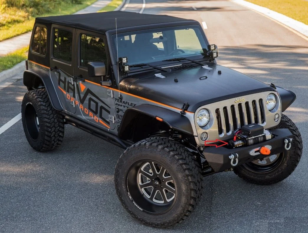

Now, I also haven't heared of them, but I saw a cool Wrangler online last night and it said HAVOC on it, and on the winch as well. And since that's going to be the first serious winch (I'm not counting that chineese winch off amazon that burnt out a week after I bought it).
And here is that link to more pics of this guy - https://www.carid.com/gallery/jeep/...fuel-off-road-rims-wrapped-with-37-tires.html
