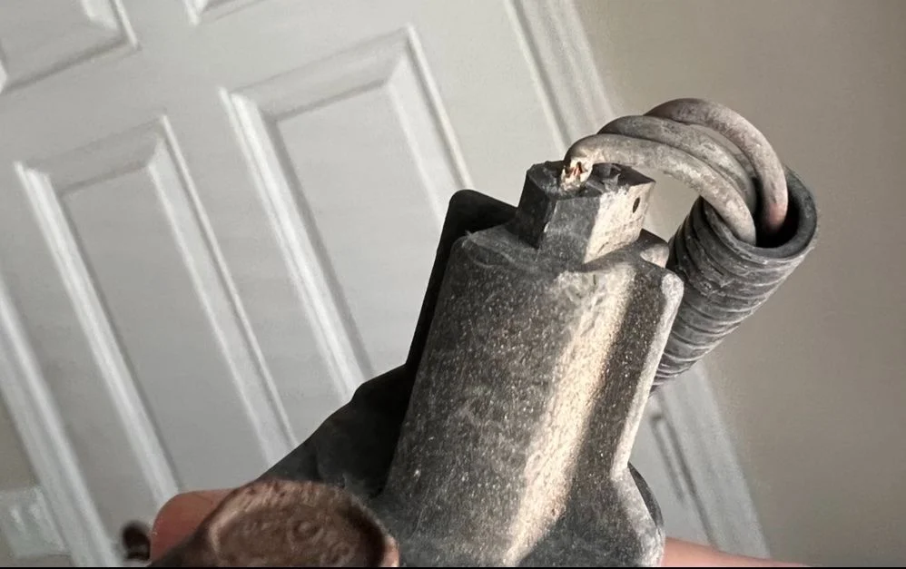

Fwiw, I ran the included Crown sensor with my OPDA and it ran well until it randomly failed on me without much of a warning.
My warning was the RPMs cycling up and down twice (I thought maybe it was me losing traction in the rain during a turn). I shut off the Jeep to go inside a local business (and definitely should not have done that!).
My engine had a P0344 code for the CPS that would not erase and my Jeep would not start.
Luckily I was able to get a ride and replaced the part with with my spare Napa Echlin CPS. It started right up and the code has not come back.
I’m tempted to keep a 10mm socket & driver along with my spare OEM CPS with me at all times after that experience.
Don’t mean to scare anyone but I don’t want anyone to get stranded especially off the grid.
