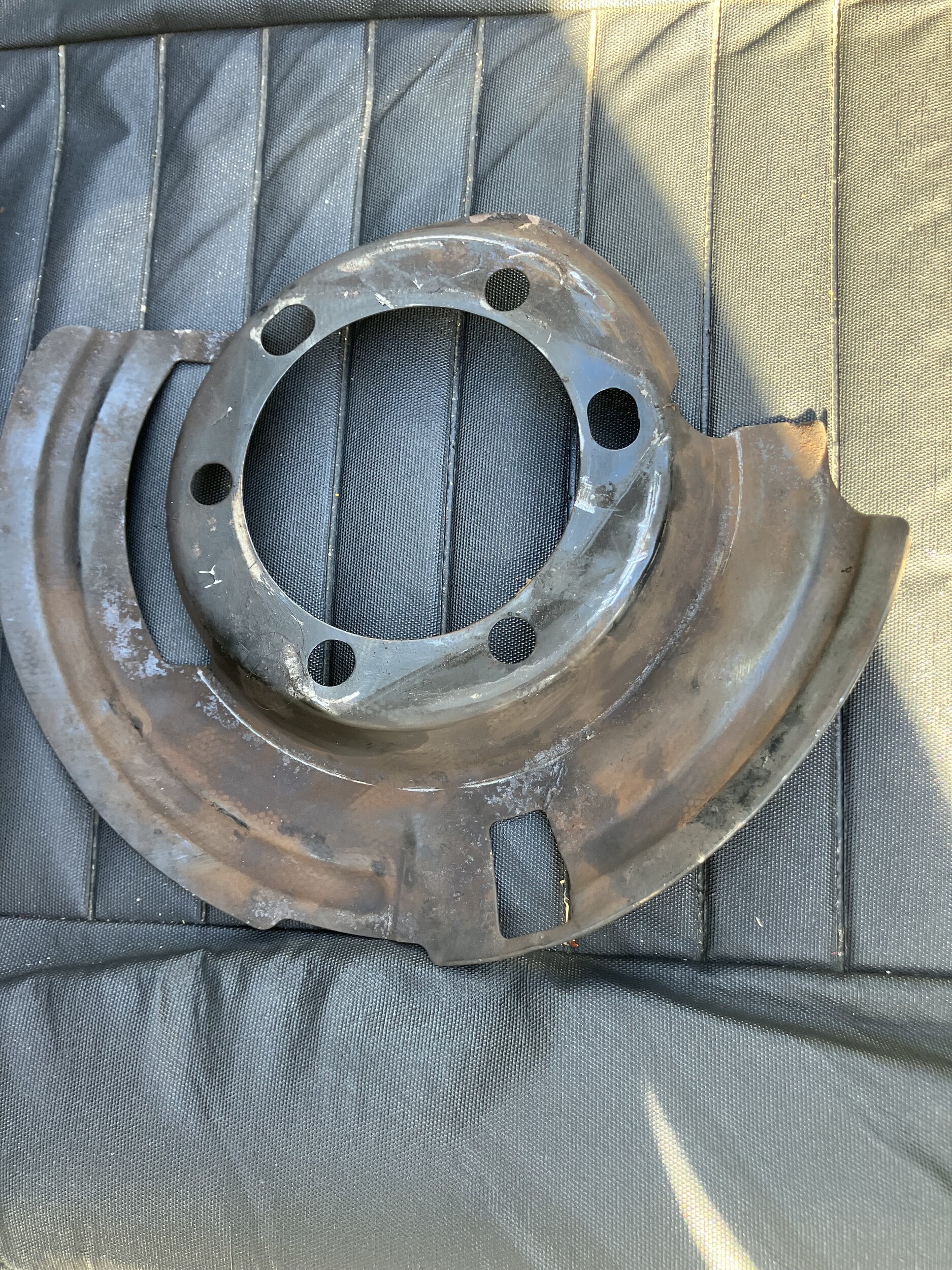

Thanks for all the responses - I just pulled the driver side dust shield (see attached) and the noise is just as bad / a little worse.
Thinking U joints or perhaps hubs? I’ll take any suggestions at this point :)

I didn't think it had the right pitch for a dust shield. This sounds like heavier metal rattling on rotation activating when you let off the gas. Slapping sound to me.
