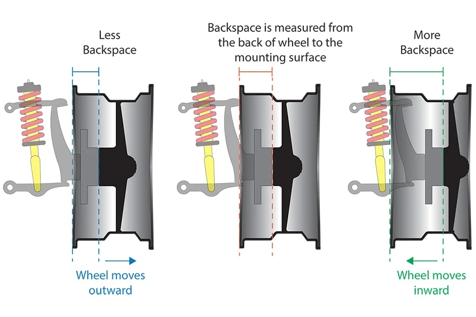

This question comes up from time to time, so I figured I'd make a thread about it.
This illustration pretty much says it all:
So for instance, if you had a wheel with 3" backspace and a wheel with 4" backspace, the 3" backspace wheel would move outwards more, whereas the 4" backspace wheel would move inwards more.
Hopefully this makes it easy to understand for beginners.

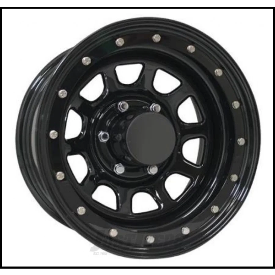

I am looking at BFG Mud Terrain 33 x 12.5 tires. For some reason when I look up rims for them < on a 06 TJ > I get different bolt patterns as well as different back spacing.
Technical Details
  • Wheel Size: 15x10
  • Bolt Pattern: 5 on 5.5
  • Backspace: 3.75
  • Max Load: 1800
  • Offset: -44
  • Finish: Flat Black
  • Center Caps and Lug Nuts Not Included
  • Replacement Center Cap Part Number: PXA1425017
For that setup 3.75” backspacing will work great!
However, the correct lug pattern for a TJ is 5 x 4.5.
