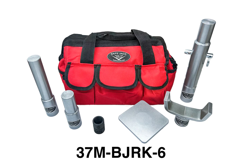

I use these:
Ordinary 6-ton bottle jack
High Lift Jack Base modified for the bottle jack
Safe Jack Extensions

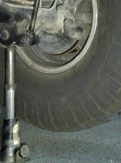

X2, this is my OEM factory jack getting my 35's 3" off the floor. It's all I carry offroad. It'll get 37's off the ground too, they are only 1" taller than 35's when measured between the floor and axle.
