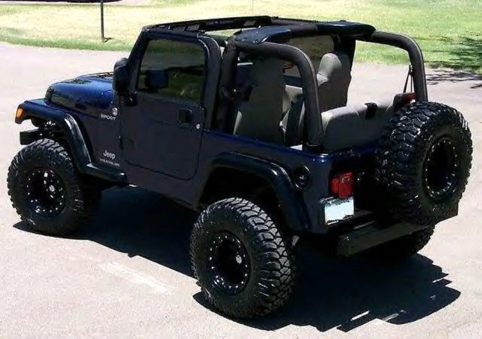

I use the Zone 4.25" combo lifts with good results. Add some Rancho RS5000X shocks for a nice ride on a budget.
