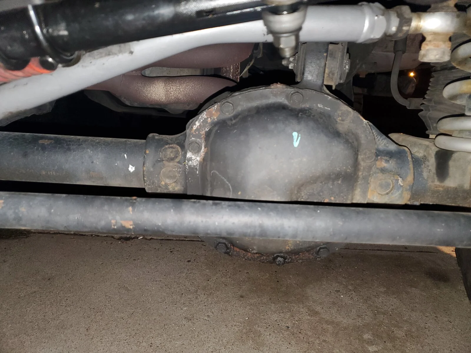

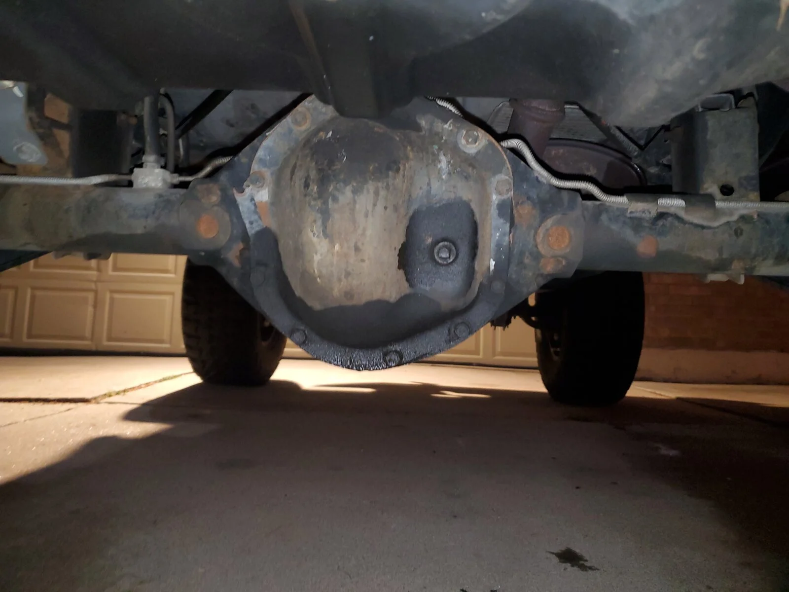

Take a picture of your front and rear differential covers, post them here, and we'll confirm what you have

You have a Dana 30 front and a Dana 44 rear. The rear Dana 44 is definitely a good thing! That will hold up to your 35s well.
The Dana 30 is fine with 35s as long as you do a few small things. The biggest thing you can do is large u-joint chromoly shafts. The u-joints and shafts are the number one failure points. Also, ball joints tend to become an annual affair. Not a big deal, just keep an eye on them. Keep an eye on the unit bearings too.

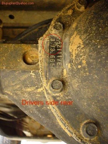

Is there a way to find out without taking cover off

As to gearing--there should be a metal tag on the left side of the diff cover. Give it a good clean and you should be able to read what gearing is stamped onto it. Or, jack the rear up and turn a tire one full revolution while counting the number of times the driveshaft spins. Number of revolutions on the driveshaft will give you a ball park idea of what gearing is in the diff. Either way, you'll want to regear to help turn those 35s.

As above, there's a steel tag bolted to the differential cover at its 9 o'clock position. Embossed into it will be your axle ratio. It will either say 3 07 or 3 73 (which means of course 3.07 or 3.73) as is circled below indicating there's a 3.73 ratio inside. Depending on which axle you look at, it will say 3 08 or 3 74 in the front since the front and rear axle ratios are .01 apart due to the different ring gear diameters in the front/rear axles.
