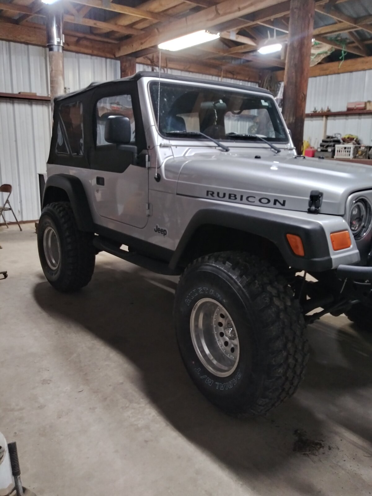

Want to put Savvy 1.25" body lift on. Already have 4 in suspension lift. What 1" motor lift should I use and will I have to adjust any linkages. Just installed 35's and need a little more clearance.
