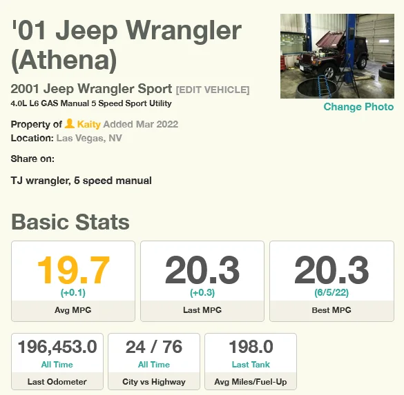

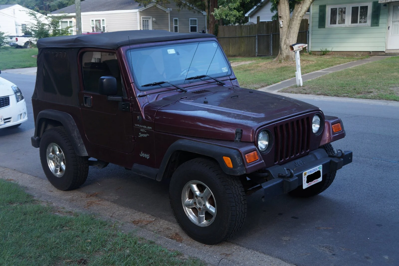

My '01Sport is more or less stock, 5 speed manual too. Not sure about my city miles, likely 15 mpg or so, highway at 55-60 I had been consistently getting 20.3 mpg actually. I use the website fuelly.com to help me track my mpg.

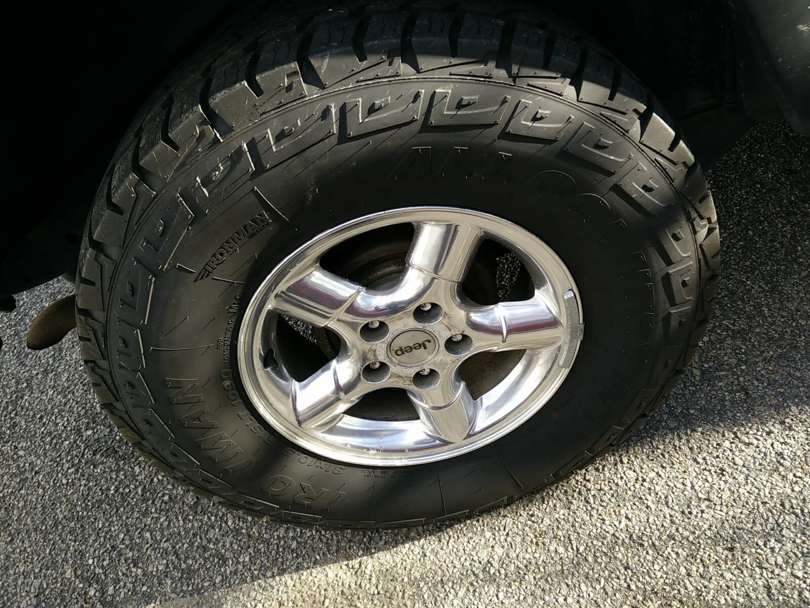

I edited this post to add a fairly recent and decent res image of my Jeep as I have it setup. I did remove the rear seat and some other stuff. I have really crappy looking OEM 15 rims but my tires are fairly sturdy and AFAIK, definitely not the OEM size tire. I always try to coast to red lights when I can and not to accelerate too heavy. For me, my goal when driving is to try to get my car into 5th gear as soon as I'm able to, which I find approx 45 MPH I can shift up to 5th but if I slow down for any reason, I'll have to downshift since my revs are fairly low 5th gear at 45.
