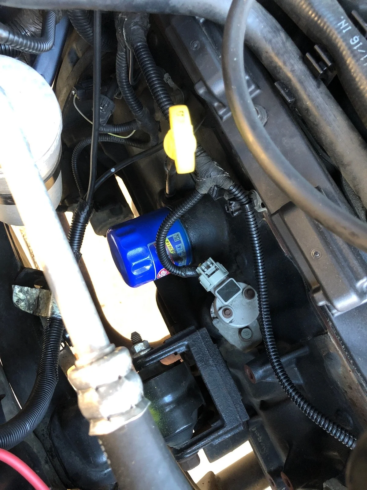

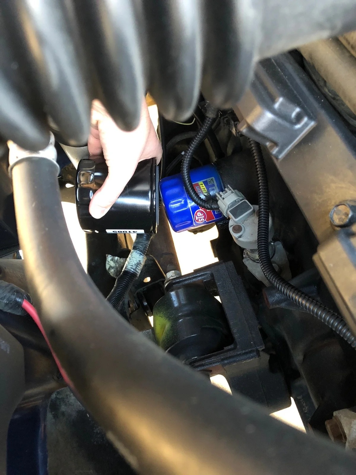

I don’t know what the idea was behind using such a small oil filter, right when I saw it I knew it wasn’t the correct one.. probably fit so they went with it idk.. ran fine tho haha

My chevy 5.3 v8 runs on Walmart 5w30 synthetic, here in Florida, so I figured it was good enough for my TJ 4.0. My TJ oil pressure is 40lbs at an idle. Also, here’s a TJ 4.0 hack for a bigger oil filter.

On oil filter hack I wonder if internal by pass spring pressure is the same ?
I have no clue, I guess that data might be out there somewhere, just don’t know where. I’ve been running that filter for about a year and have had no problems.
