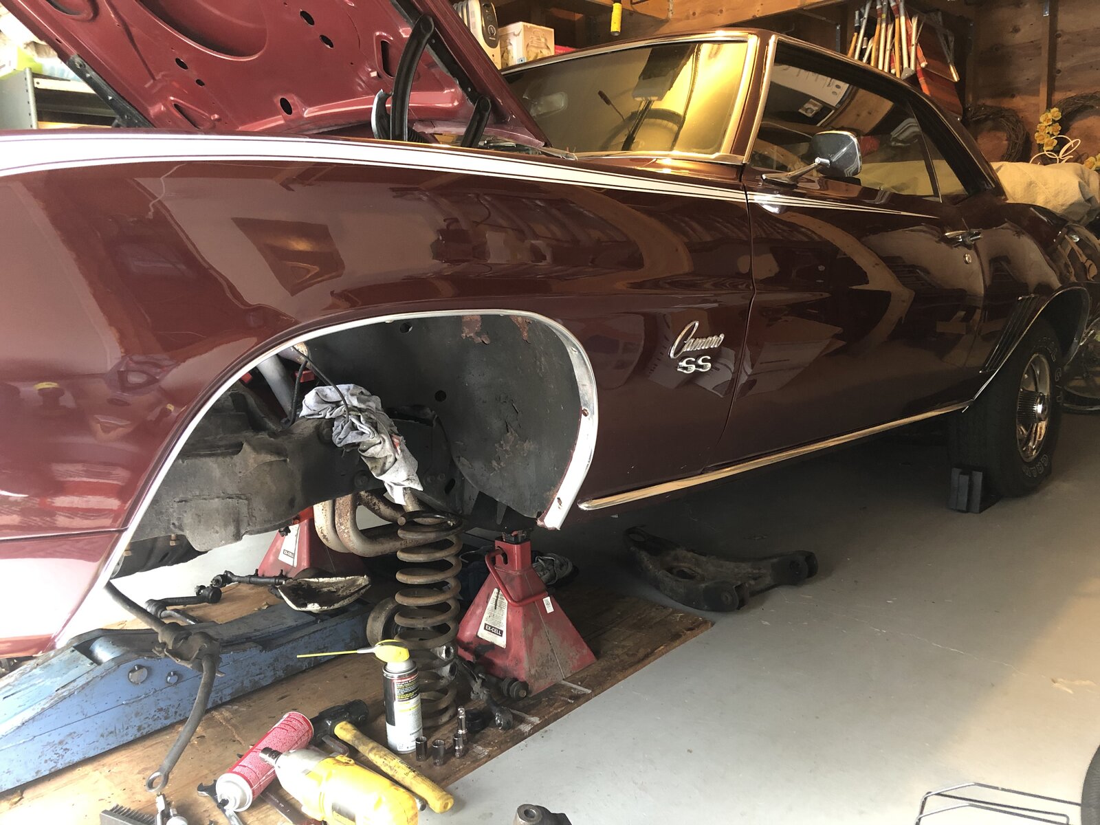

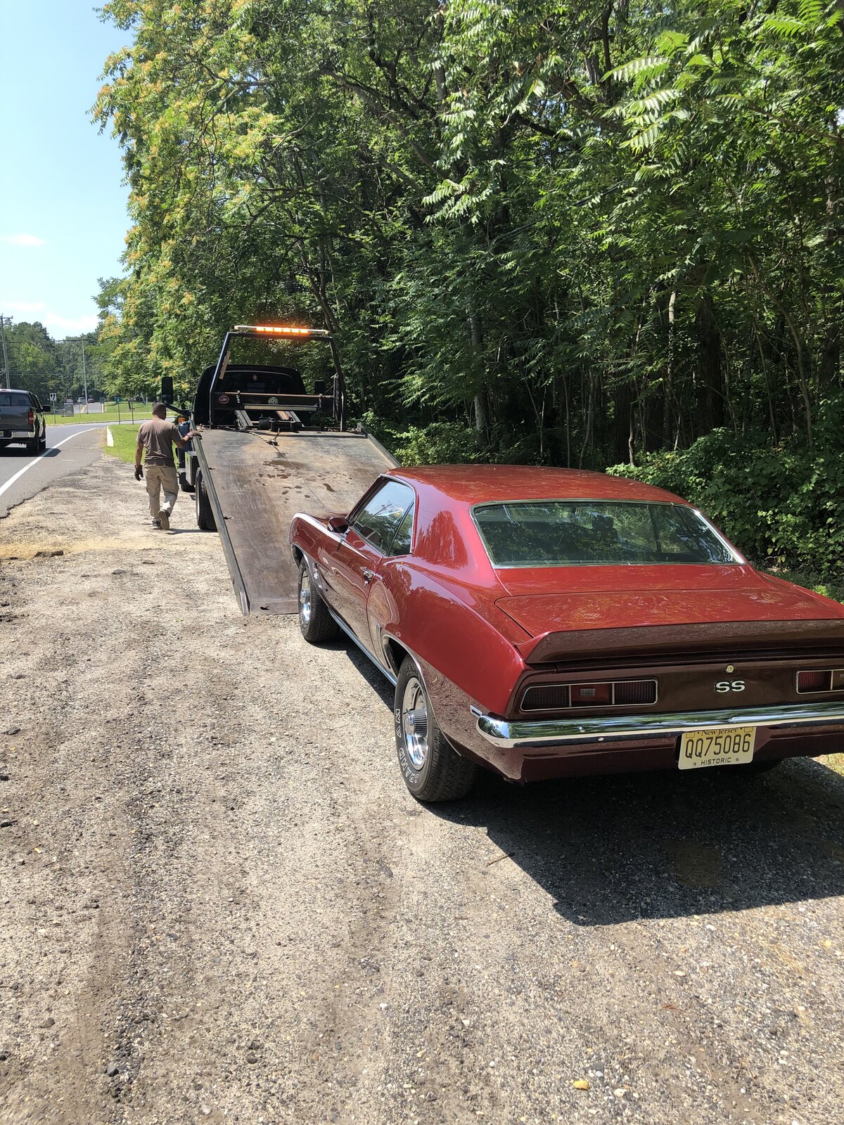

My never ending project. 1969 Camaro. Recently converted to front disc brakes. I have new body mounts waiting to go on and sub frame Connectors coming next. Flatbed photo is when my DS gave up the ghost last year.

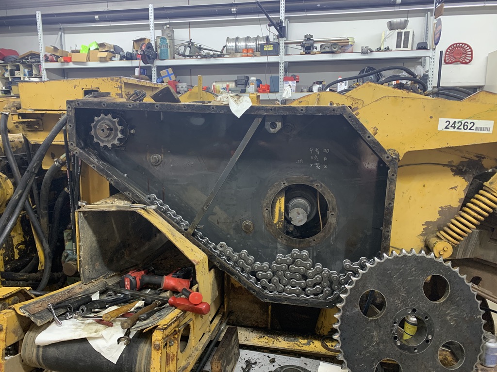

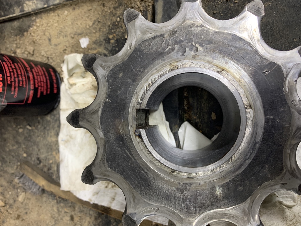

More trencher warfare!
Started with draining the chain case oil and finding a 1/2 set screw. It had some trauma in the past. Sprockets misaligned by 7/16". Small sprocket loose on shaft (missing said set screw) sprocket wore .010" oversize the shaft wore down .018".
My son yesterday: Bored the ($150) sprocket oversize, preserving the partial keyway. Made a sleeve then cut a keyway 3/4 of the way thru the sleeve, tig welded it into the sprocket, finished boring it to the shaft size, cutting out the remaining ID which opened up the keyway. We dont have keyway broaches. (He's got skills for a 23 y/o!)

That's real good work. *respect*

Thank you!
My son got interested in tig welding when he was in HS shop. We have a Lincoln 185.
Most times when something needs welded around the farm he goes to the tig. Keeps his skills up.

That is some impressive welding.

Clone car? 69 SS Camaro's came with disc brakes. Sharp car none the less!

Continued trench (er) warfare. 25º outside with a 40 mph wind...good day to be in the shop.
It came set up to cut a 24" wide trench and needed to be reconfigured to 16" wide which is all thats necessary for us. The 18 and 24" spacers will be replaced with narrower ones.
Also pulled the fuel injectors out of the 4-53 detroit and took them to get rebuilt. Cylinder number 2 was unusually wet.
120 5/8 bolts later:
