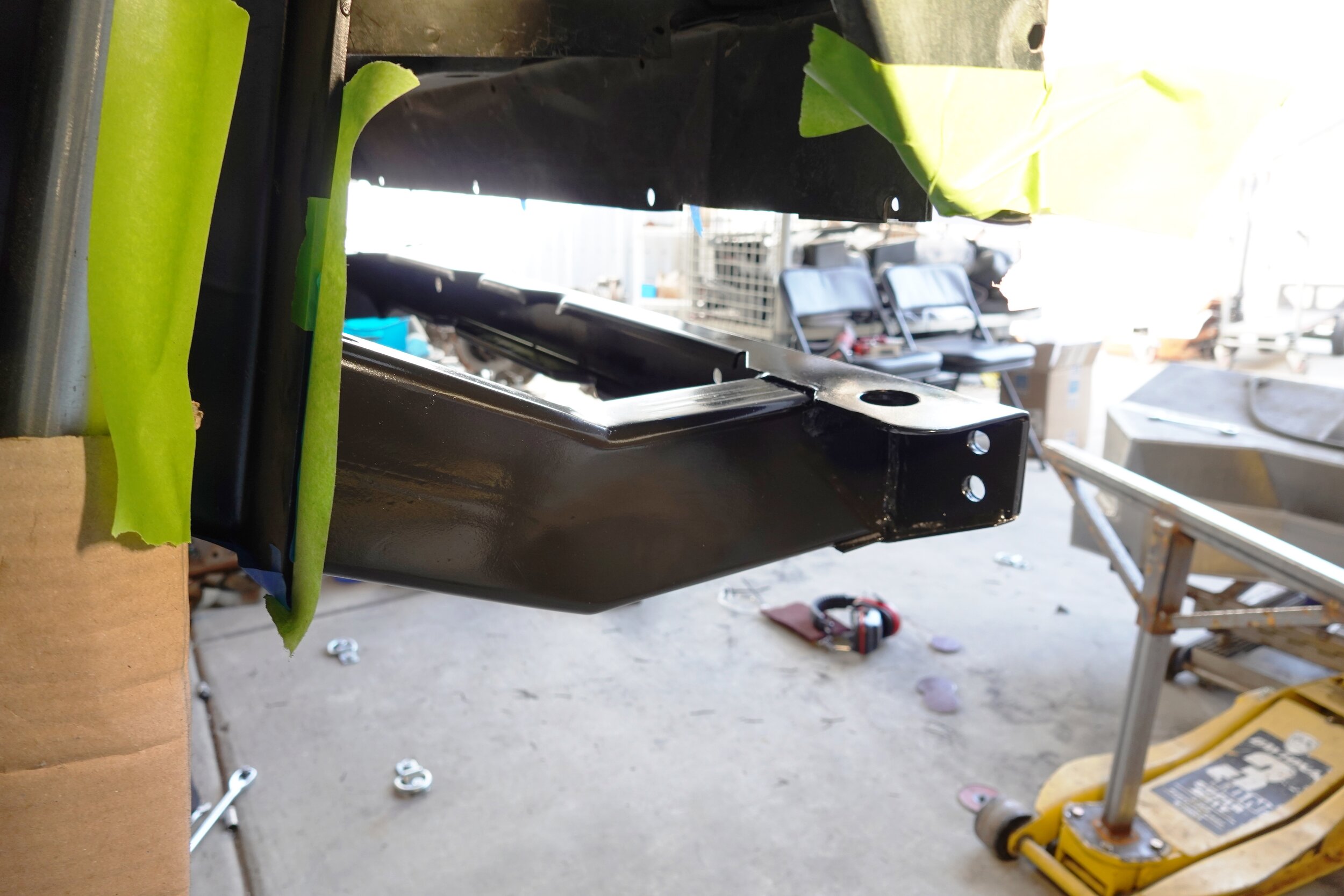

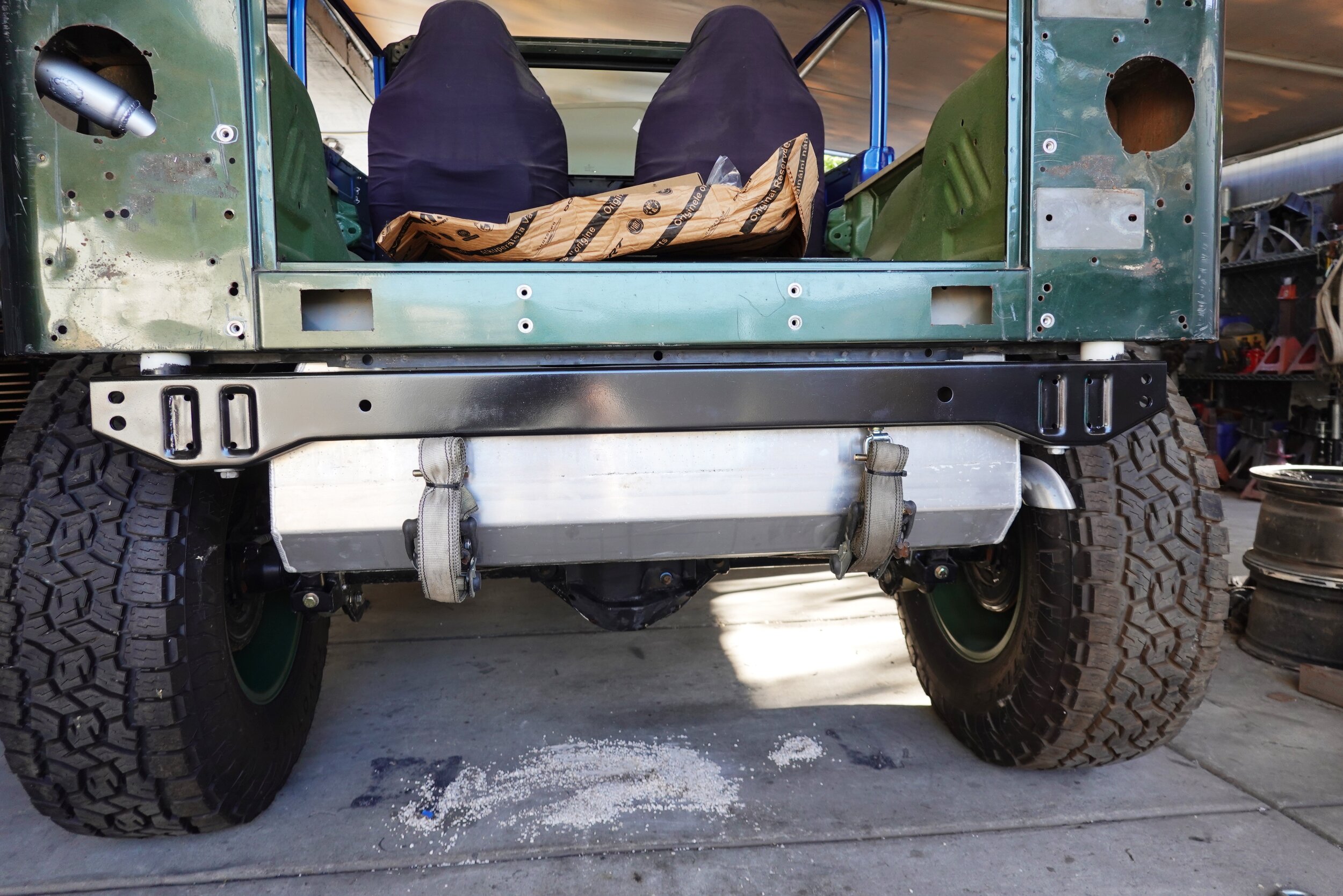

There will be a lot of areas where you can't remove the rust completely. Look at something like the KBS Coatings conversion primer to slow down how much the rust will continue. Their top coat is pretty stellar in the satin for frames. Not fond of the price but it looks pretty good when you are done.
View attachment 539838View attachment 539839
You are the man Mr. Blaine! Just Ordered 3 Cans of the primer hopefully that’s enough. Im hoping the Krylon Rust Enough and the KBS Conv Primer should do the job. You think they will work with each other?
KBS top coat is really nice but that price is ridiculous, I bought 6 cans of Krylon for the price of 1 can.
