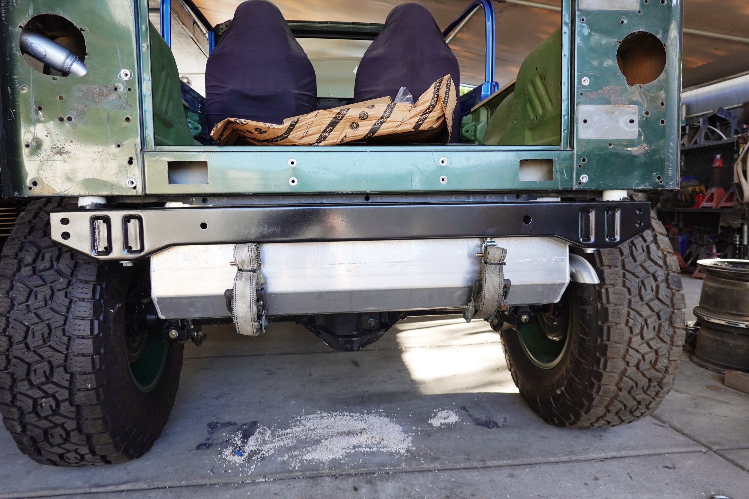

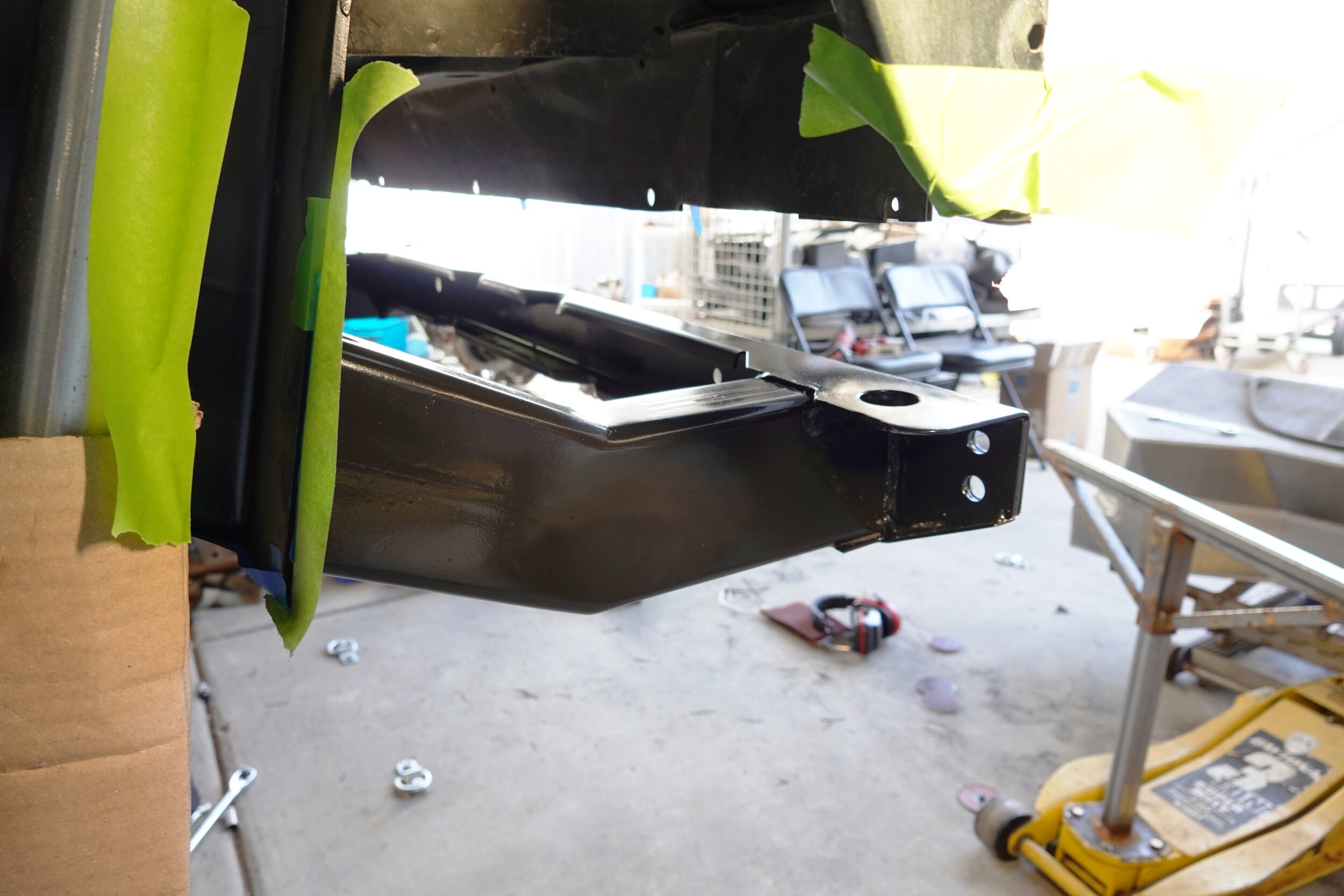

There will be a lot of areas where you can't remove the rust completely. Look at something like the KBS Coatings conversion primer to slow down how much the rust will continue. Their top coat is pretty stellar in the satin for frames. Not fond of the price but it looks pretty good when you are done.
View attachment 539838View attachment 539839
That KBS top coat is looking phenomenal.

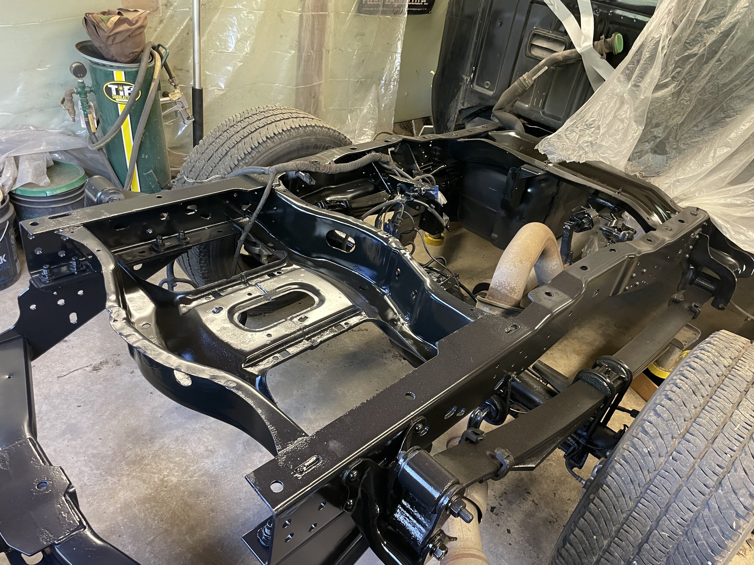

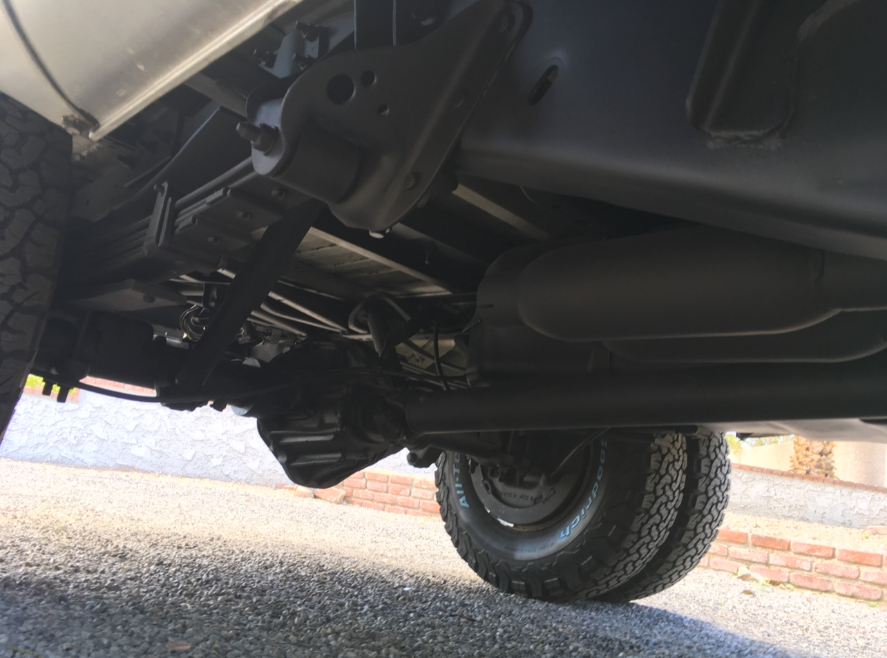

I just finished doing a bed on 2011 F250, that’s lived life in upstate NY where drivers rely on an incredible amount of salt in winter. Different than your application though, since I took bed off, I was able to sandblast it and frame relatively easily, though sandblasting sucks. 3 coats of Southern Polyurethanes (SYP) epoxy primer. Tried Raptor liner for 1st time. Was very impressed and just sprayed the undercarriage of bed with it also after primer. If you are able to spray and get rid of your rust first, SYP epoxy primer is an excellent product and does not need a topcoat. They host an excellent forum, that many pros frequent and willingly give advice on their experience. SYP only recommends Ospho ( and no others!) under their primer ONLY if you cannot remove rust. They do provide several cautions on properly and neutralizing. I never had to use it, but think their advice is very good. Check their website. The owner of SYP was the creator of the paint, highly helpful to all customers and long following of pros using his paint. Lots of threads on doing frames on their site.
Here’s a shot of SYP epoxy primer on my 2011 frame
