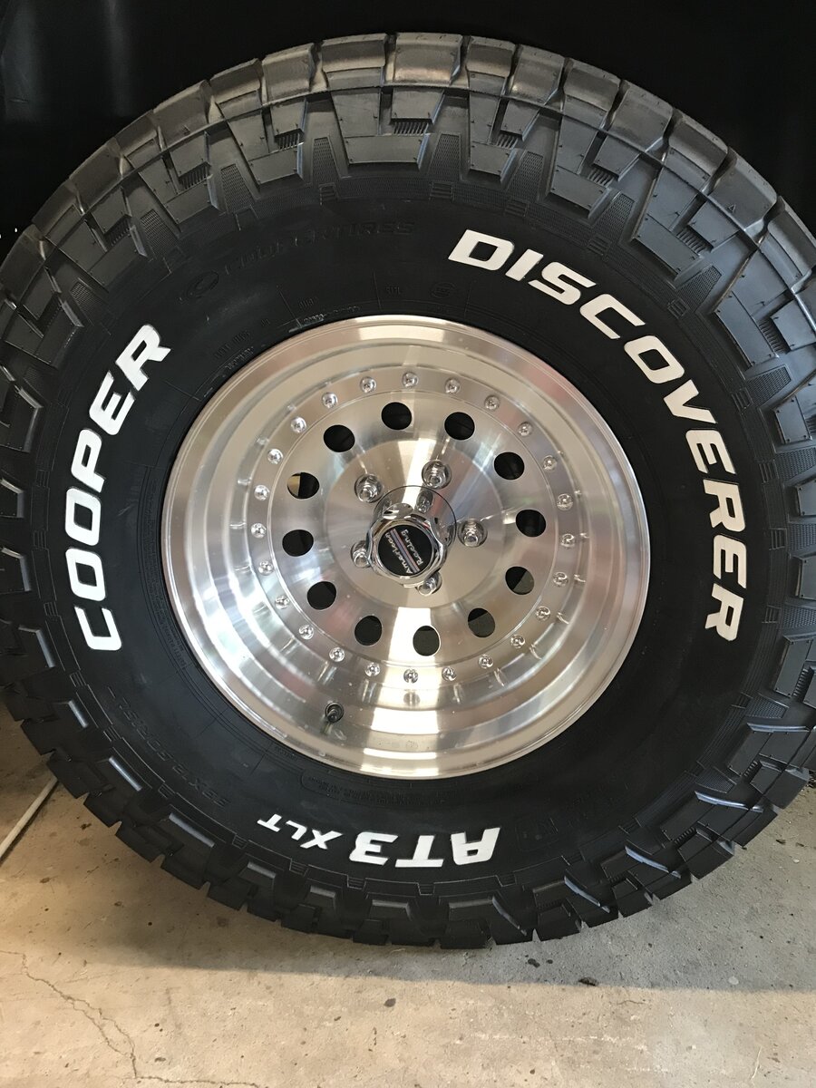

I’m running American Racing Wheels Outlaw 2’s with 33” Cooper Discoverer AT3xlt tires. I had the outlaws on both of my YJ’s back in the day and wanted something on my 97 TJ that would have been available back when it was new.

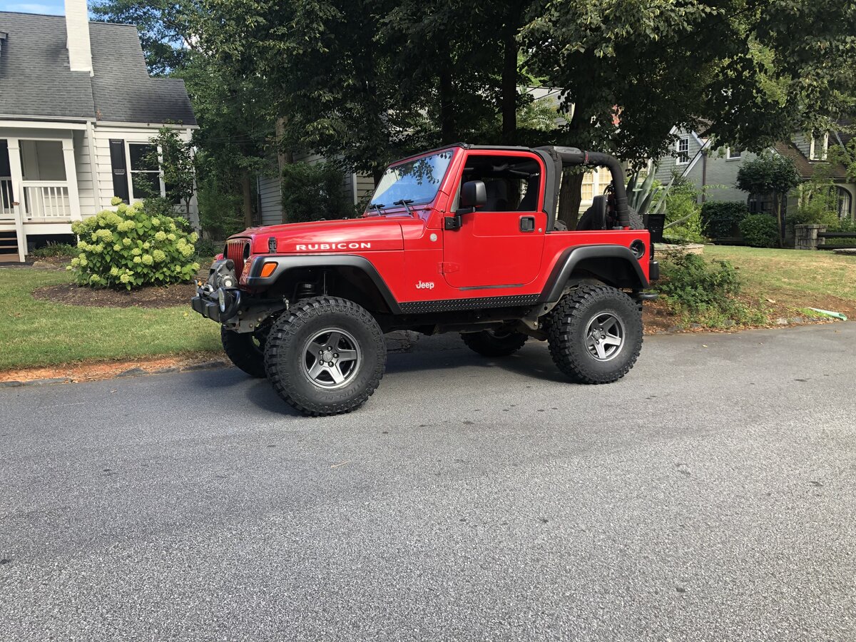

Could throw a picture of the Jeep sitting on those wheels please??

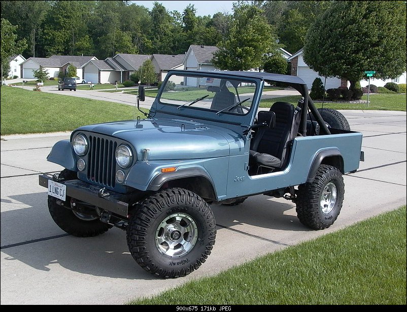

11 years since I last saw them, the 15x8 aluminum American Racing AR23 is still my favorite inexpensive wheel.
Mine too. Been thinking about putting them on my TJ, but would have to buy 7 of them, so I would have matching wheels on my trailer.
