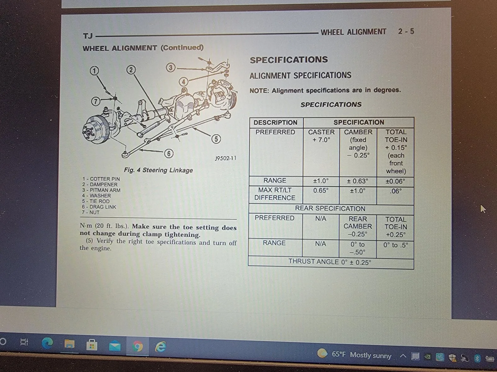

I believe 7deg +/- 1deg

Factory spec is 7 degrees but the bigger the tire, the less caster angle that is needed. That printout's 4.87 degree caster angle is less than I'd like to see with 33" tires, I'd want more like 5.5 to 6 degrees.
