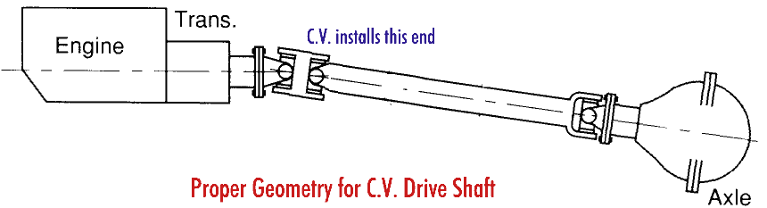

Question: does the pinion angle for this layout on top (with C.V. driveshaft) cause negative (bad) castor angle? Assuming yes because I don't know how many other answer could be possible: Is the only way to fix that to cut off the axle mounting hardware for the control arms and spring perches and weld them back on in new locations?
Not usually an issue in the front.
Set the angle to get enough castor for return to center.
Or as far as you can go without vibes.
It is what it is.
Also, I think you would have to cut the knuckles off and remount to do what you're thinking.
Reactions: Jerry Bransford
The front pinion angle can cause a bad caster angle but not always enough to need to work like that. The usual and most accepted way of setting the front pinion angle is, as above, to adjust it for as much caster angle as you can get until you get u-joint vibrations from excessive pinion angle, then back off the caster angle just enough to stop the vibrations. Pinion angle always takes precedence over caster angle.

For your 4" suspension lift you should not be running the factory rear driveshaft, you need a double-cardan (aka CV constant velocity) rear driveshaft. For the DC driveshaft your 4" suspension needs the angles should not match between each end. The driveshaft u-joint angles produced by a 4" suspension lift on the SWB TJ are excessive which causes them to vibrate. The correct DC driveshaft angles should look like this....
