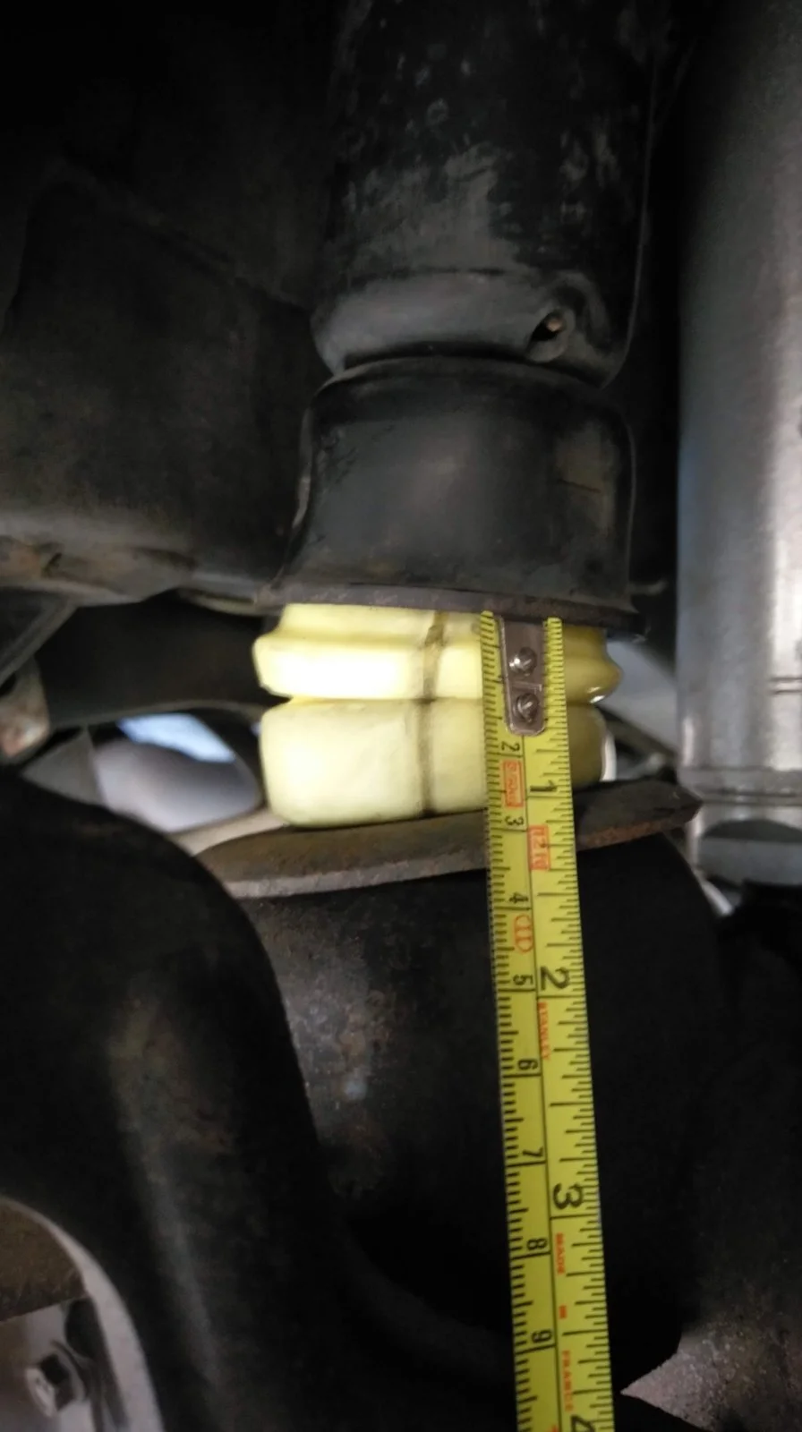

I just did the bump stop check with my Falken Wildpeak A/T 31x10.5R15LT tires and found that the front tires contact the fender at full lock with a 1" gap between axle pad and bump stop cup.
There's a little more space with the wheels straight ahead, but not enough to keep the wheels from hitting the fenders.
So, if you're going for full flex with 31s, you MAY have clearance issues and it might be a good idea to check before you push things too hard.

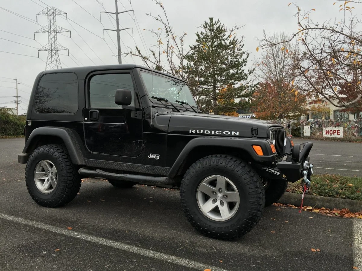

This is my old 2005 Rubicon with 33s (285/75R16) and a 2.5" lift:
So will they fit? Yes, they will. However, 2.5" of lift isn't enough for 33" tires if you plan on doing any sort of serious off-roading. The amount of up-travel is severely reduced, which will affect both on-road and off-road ride quality, as well as articulation.
4" is really the minimum amount of lift you need for 33" tires. If you want to run a 2.5" lift, run 31s or 32s at most. @psrivats took a photo of his the other day with a 2.5" lift and 31.5" tires, and it looks perfect IMHO.

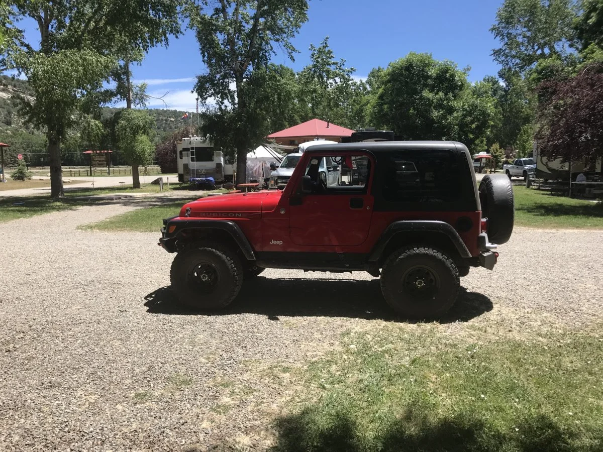

I have beautiful ko2 15x10.5x33 on my 2.5 ome+1.25 bl. My long term plan is 31s and loose the bl. The clearance on my rubicon is great, but the 4.10 gearing suffers. It is just ok if you cut out the od. The gearing would be worse with 3.73. I know I can do Colorado jeep trails well on 31s. I have done imogene pass and black bear road on p225x15s. The 31s will also perform better and the jeep will be a bunch easier to get in to and out of. I believe they are your best choice.

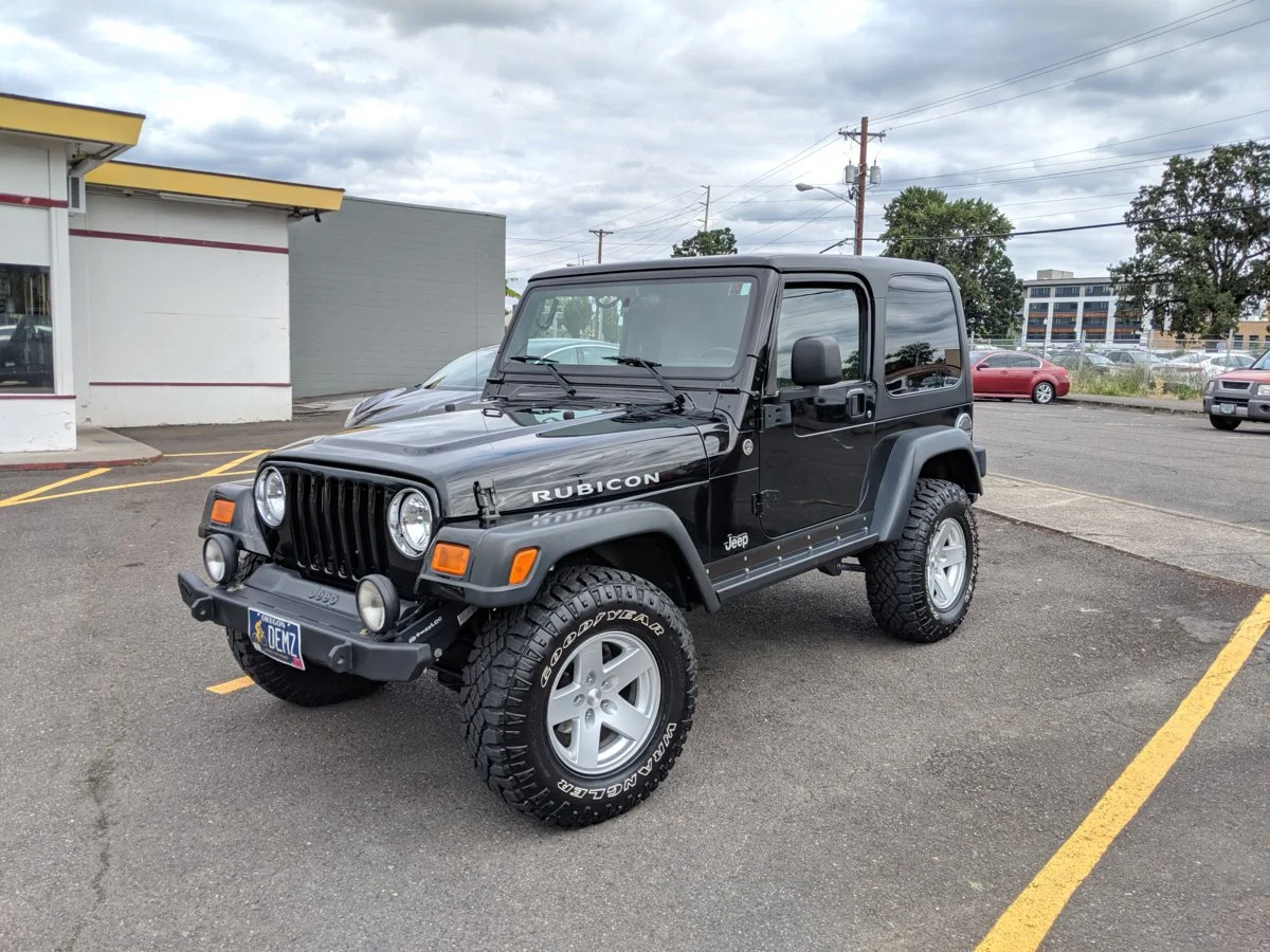

This is my TJR on 31.5s (265/75R16s) with a 2.5" lift. Technically closer to being a 31 honestly.
