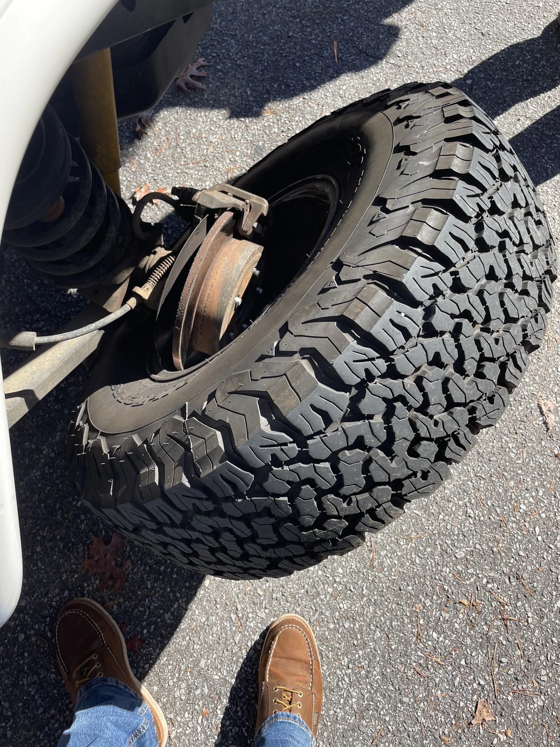

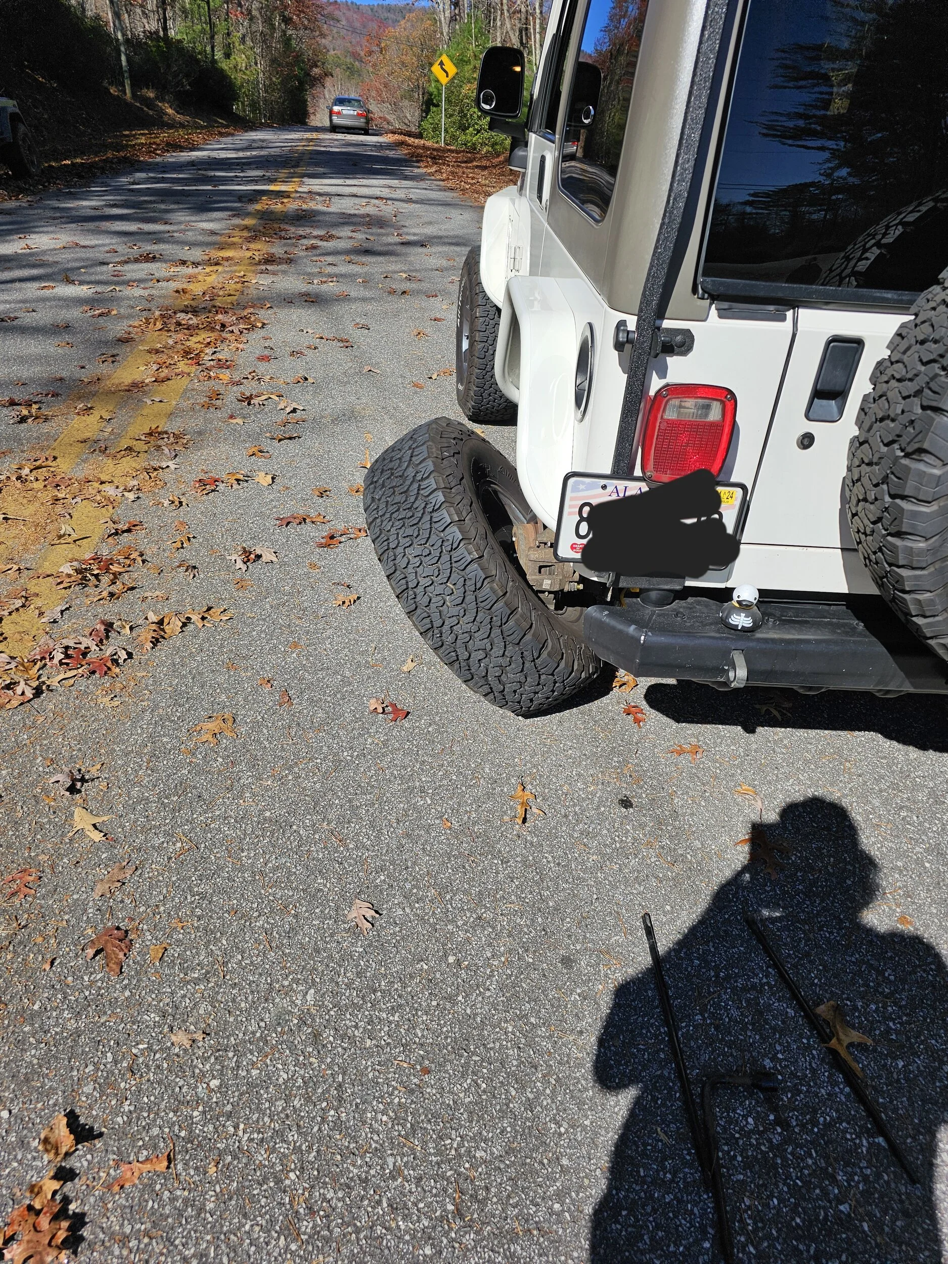

Before @tr21triton post it I will. Axle studs, and a new wheel.....
You don't want to look like this
Or use your torque wrench before you leave the house. He still blames it on that damn duck. :unsure:

you can knock them out with a hammer. but honestly Andy's was a rare situation. he had aftermarket axles and they had used too short of wheel studs. so I really wouldn't be too worried about that happening if your running stock axles it would be a rare occurrence .
