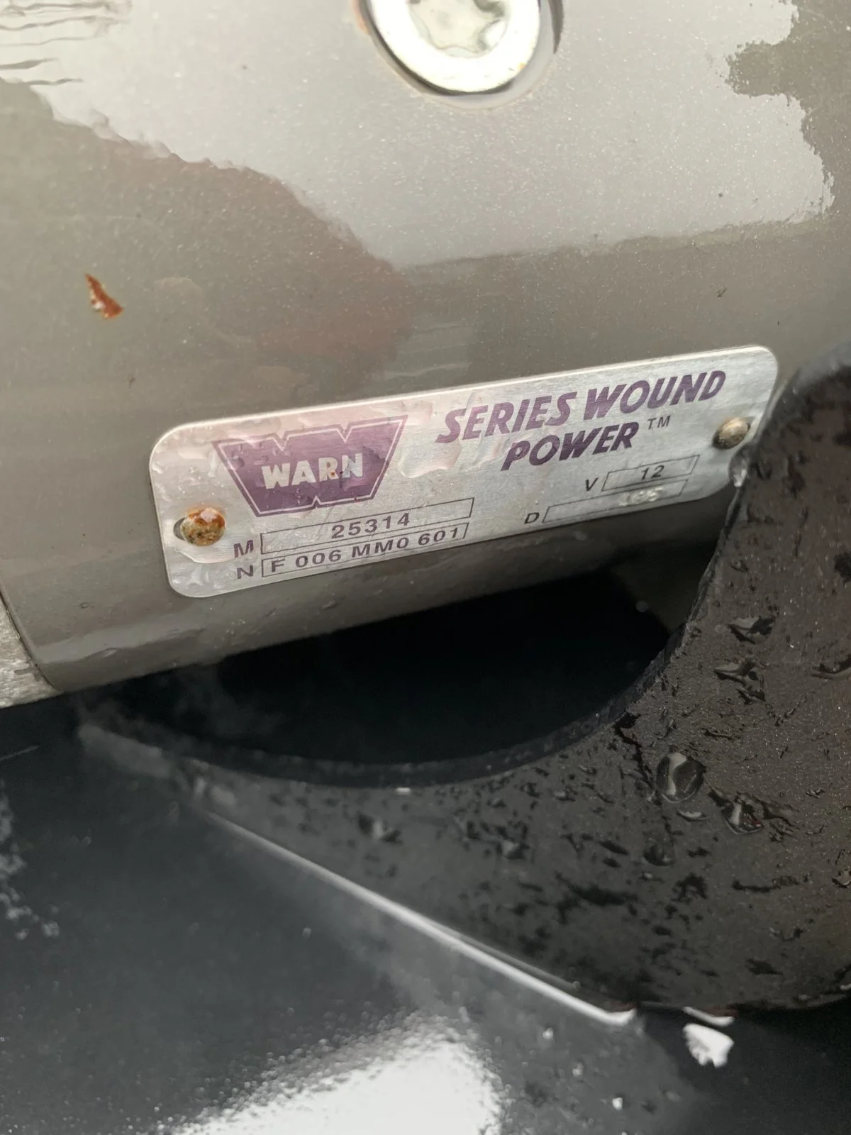

This the identifier on my winch I’m pretty sure it’s of the m8000 series after some googling.
