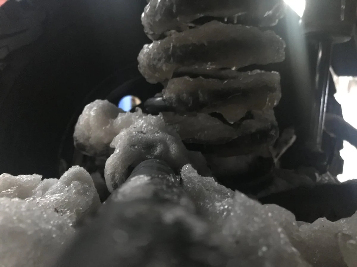

You’re saying your bracket is bent aft wards and is making it so the spring blocks access to the nut at ride height.
Can you take a picture like this
looking down the steering stabilizer from the side towards the spring? And maybe a picture from behind the axle looking forwards of the bracket.
Ignore all the ice but the black bar the camera is resting on is the stabilizer looking towards passenger coil.
very odd that your bracket would move that far mine has a ton of clearance back there.
Is there wear on the bottom of that fox stabilizer? Looks like the diameter of it makes it hit the drag link near it’s mount
